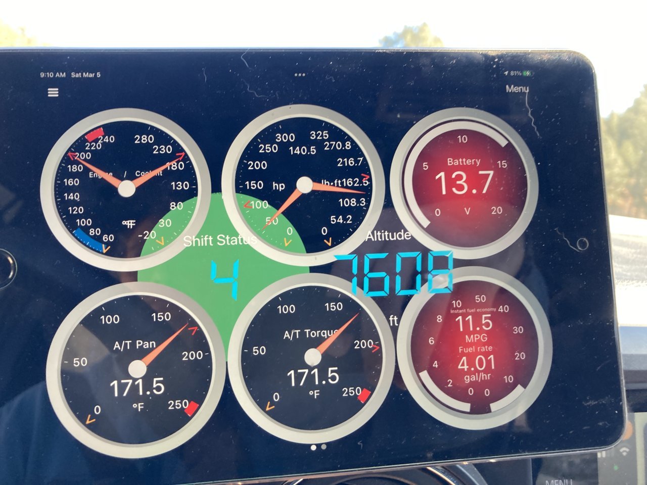

    Having drive 3,500+miles in the past few months I wanted to share my towing experience…
    So far we’ve towed the TT 3,537 miles, ascended 38,484 ft, descended 32,175 ft, maximum elevation 7,610ft, lowest elevation -223ft and the taco has done awesome!
    My TT is a Apex Nano 213rds, 25ft long (hitch-bumper), 7.5ft wide, 4140lb empty, 4,700lb loaded.
    My truck is 2020 DCLB OR, tonneaux cover, 500lb sumo springs, Redarc brake controller and Anderson WDH. I run 50psi in the rear tires and 45psi in the front. With a bit of finagling I raised the stock transmission radiator 1.5” for better airflow and run with the thermostat pinned. Oh yeah one other thing…. I added the front spoiler from the sport :anonymous:
    I highly recommend the Anderson hitch. It’s lightweight which is useful for the taco’s limited payload. When set up correctly it provides excellent stability, nearly zero push/pull from semis going past at 80mph and keeps my truck level front to back. With the TT attached the rear of my truck drops 0.5” (still space between sumo and frame) and the front is the same height as when unloaded.
    I drive in S5 (no ECT), utilise OBD fusion via the Carista dongle on my iPad mini to watch everything. The most useful thing with OBD fusion is knowing when the Torque converter is locked and watching the TC temps.
    The first 2,000 miles of this journey I was not able to watch whether the TC was locked or not, I was only going by sound and feel. Since adding this functionality I can run in 5th gear easily and safely knowing exactly what goes on. On my screen I have a green or red circle behind the active gear to tell me if it’s locked or not.
    With this current set up I can consistently get 12 to 14mpg. My most recent leg of the journey was from Santa Fe to Colorado Springs, approximately 330 miles and I averaged 13.5 mpg even with a red flag warning coming from the west for 100 miles. I typically run at 60mph so I can use 5th gear and I’m nearly always in flip flops so I drive barefooted which allows for a bit more sensitivity.
    On a recent leg from Alomogorda to Roswell NM, I ascended 3,500ft over a 7,600 ft mountain and my TC temps peaked at 207’.
    The taco is a capable vehicle with limited payload. My tongue weight is 615lb+/- which leaves enough for a full tank of fuel and myself with some left over. My wife and 80lb dog are travelling in convoy with tool box, generator and other heavy stuff in her car.
    I wish the taco had a bigger fuel tank although this handily limits drives to 4hrs so automatically provides a break from driving. We typically try to plan our legs to around 200 miles for simplicity and driving pleasure.
    I highly recommend taking the truck and truck/TT over scales multiple times to know where you’re at and to make sure the WDH is doing what it’s supposed to.

    Sounds like that could have been the transmission pan temp, not the TC? The tc fluctuates a lot!

    The trans temp was about 4 degrees cooler than the TC.

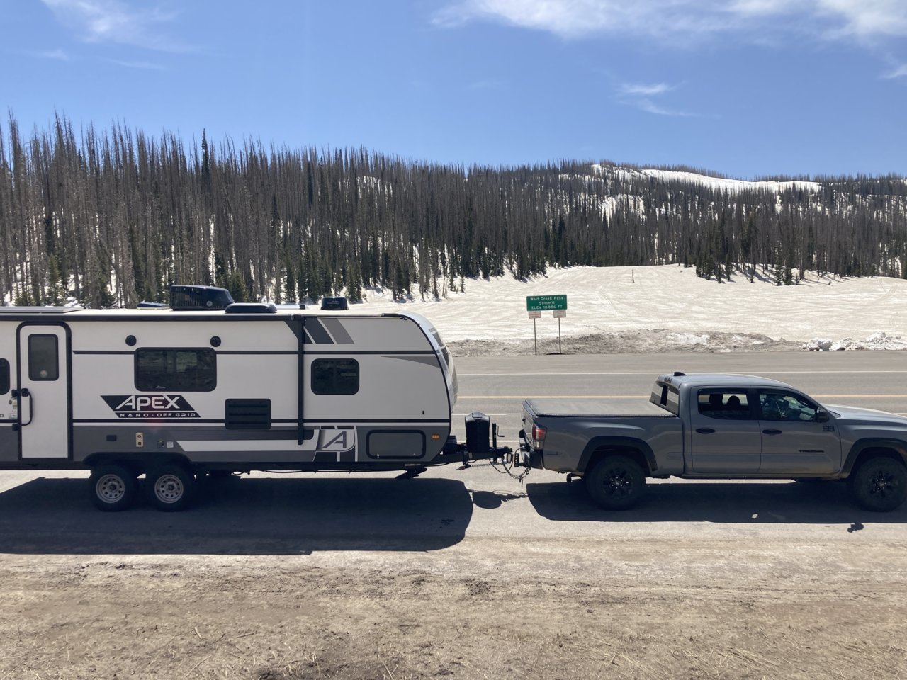

    Got high in Colorado…. again.
    Towed 4,700 lb TT west 150 miles into a 15mph SW head wind with two passes, one 9,500 and the second 10,800ft. Maxed out at 213’ on the torque converter, total trip mpg 10.7mpg.
    Taco done good as always!C2B19733-39CA-4EE1-91AD-86FEC87FA540.jpgA6DD3683-D456-4CE2-95A4-4F5B5E4CE998.jpg496B03D5-3A70-4445-9400-A453C46EA219.jpg

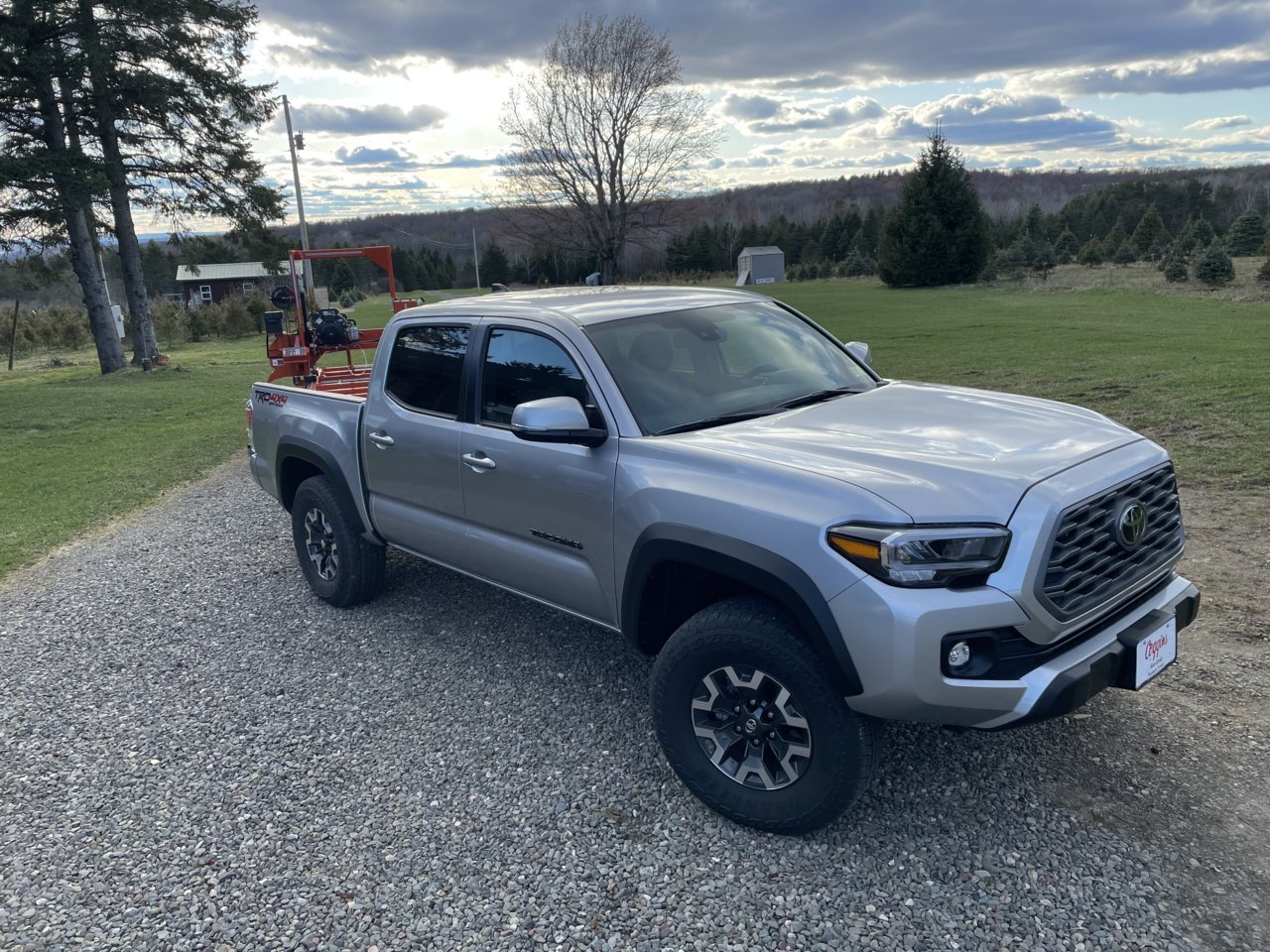

    Towed my new mill from NC to upstate NY last weekend with my 6MT OR. Mill weights 2200lbs and truck was about maxed out on payload. Went with a shock absorbing hitch. Worth every penny.

    Which hitch are you using? How do you like it?

    This one. So far so good. It’s a little pricey but does a good job of damping lateral and translational impacts between the truck and trailer. I’ll report back after I pull my boat which is 5000lbs.

    How did that tow? Seems like a lot of weight behind the axle, i.e a light tongue?
    Cool looking bit of kit though!

    I was worried about the same thing. The saw head only has one position for towing. The rest of the mill in front of the trailer wheels seemed to have enough weight on the tongue. Pulled straight as an arrow with no sway.

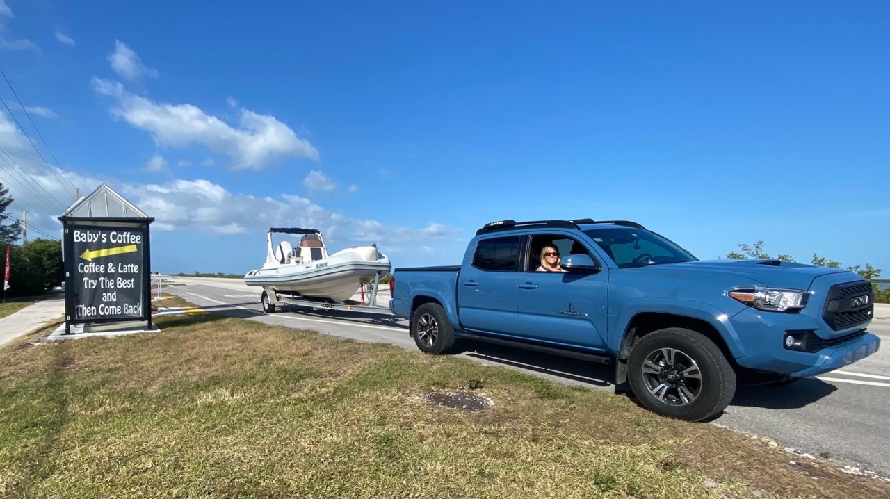

    Boat and trailer, and fully loaded 2850 lbs. Not more than 70 mph, and the only mountain driving we do here in South Florida is an occasional highway overpass.
    But I can barely feel it behind me unless I have a real hard brake situation.
