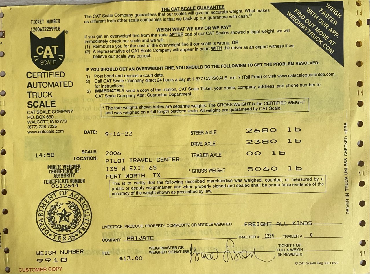

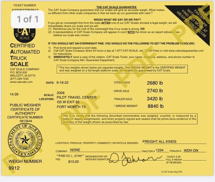

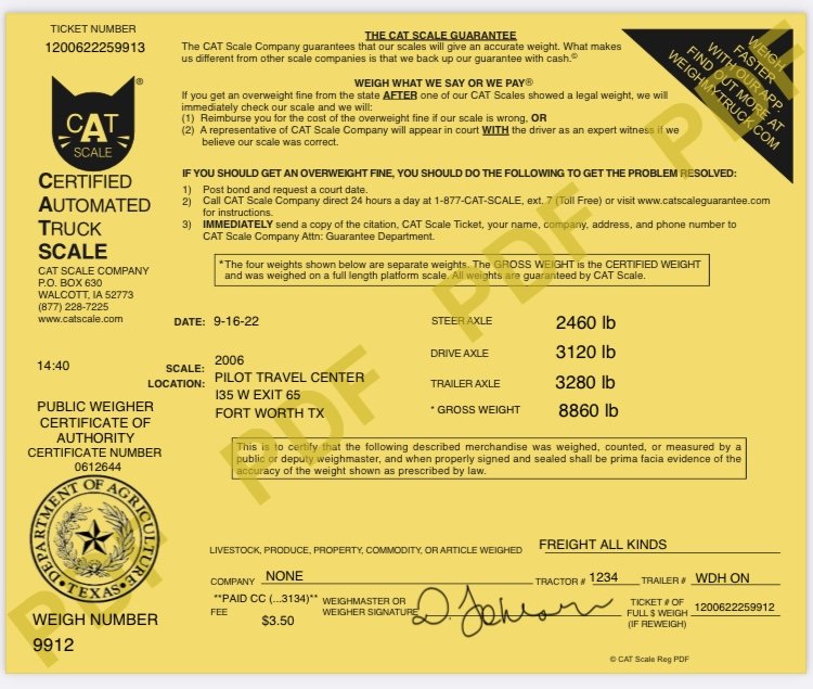

    finally got around to scales. My adjustments were perfect. You can’t make it better. Lesson learned, do it yourself and double check it. Front is back to exact weight as uncoupled. Everything is in line. It did tow much better and I found 60-65 is smoother for some reason or I got into a pass that was perfect. The pulling seems softer now. This is going through decent rolling hill country of Texas of 500 -/+ foot changes. Ride was much more enjoyable but not by much haha. I also had trans and differential fluids changed and alignment. Im thinking what I experience is the wind movement from the trailer passing into the truck. I have a scangauge 3 but havent installed. MPG was around 11.5 most of the way, got into quite a bit of traffic so that didnt help crawling speeds.
    WDH bars engaged
    WDH with bars removed
    Curb weight, no trailer

    The last time I took mine across the scales with wife and an 80lb dog. I was 2980 front and 2160 rear, 5140 total. That’s with full tank of gas, roll up tonneau cover, bed mat and WDH.

    I probably had 40 lbs in the bed with the cover, full tank of gas, myself, 45 lb dog, 110 lb dog and whatever was in truck. The axle rating was cutting close on trailer so I moved things in the truck bed since I had much more room to spare. Your wife drives a mini suv right? I’ve seen pics and I like your setup. A second car with these setups is a must.
    the cat scale app works great. No messing with idiot attendants. I did two of mine through it but somehow the cell signal dropped so I had to hit the button. You can’t hear them and they can’t hear you. Took me longer to do a solo with attendant than the other two including unhitching lol

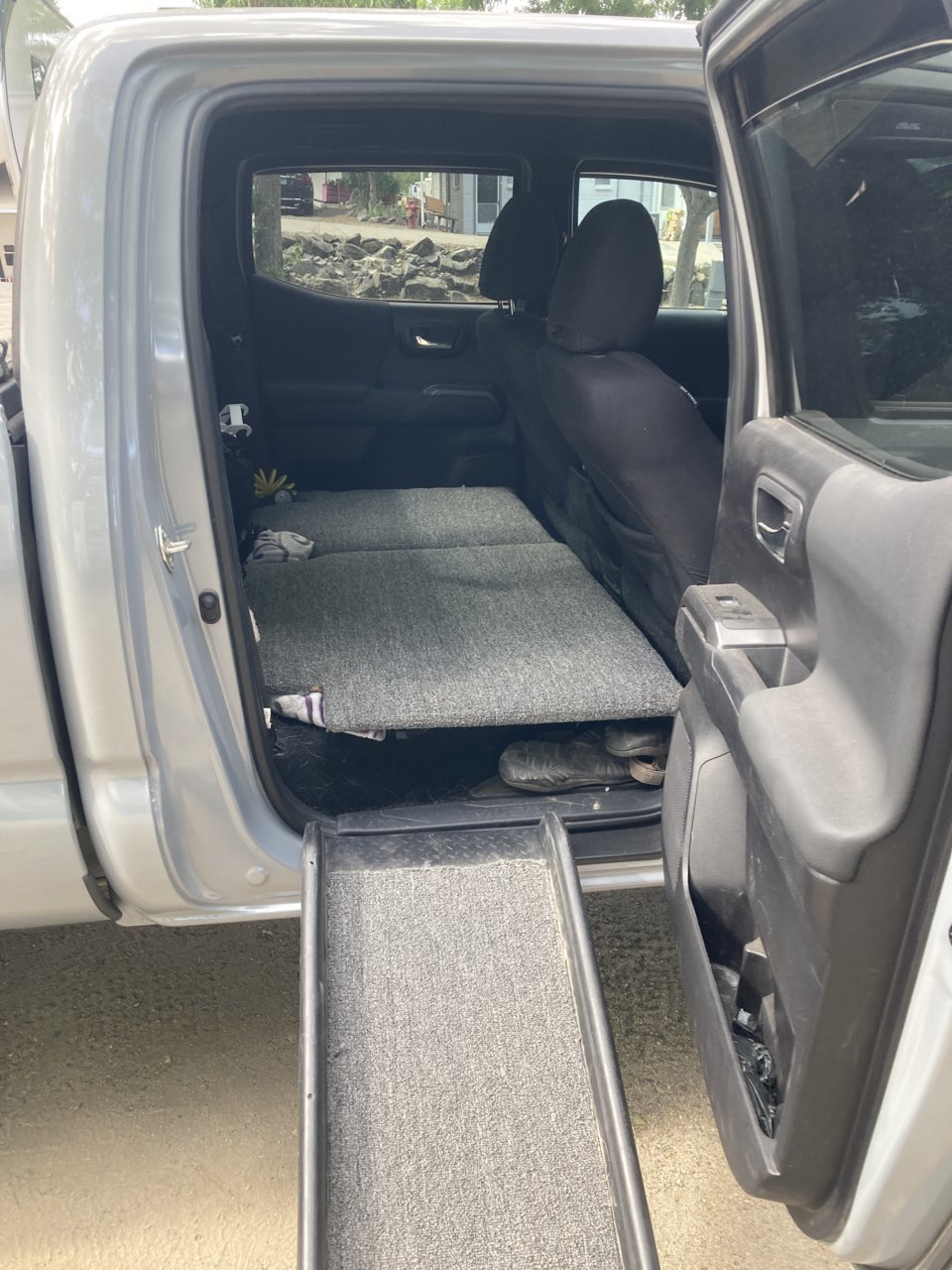

    This was my seat delete with ramp for the grumpy old man…

    Wow that’s awesome! What is it the material/build? I removed mine and put a piece of plywood with a anti fatigue mat for my bigger dogs. Works great and they have tons of room.

    1/2” ply with 2” memory foam and cheap carpet on top. Rubber flooring underlay on the bottom.
    I originally built it 60/40 to sit on top of the folded seats. Worked great for our dog and still had functionality with the seats. For this big journey I decided to remove the seats, the boards just sit on top of the cubbies and I have supports under and closest to the front seats.
