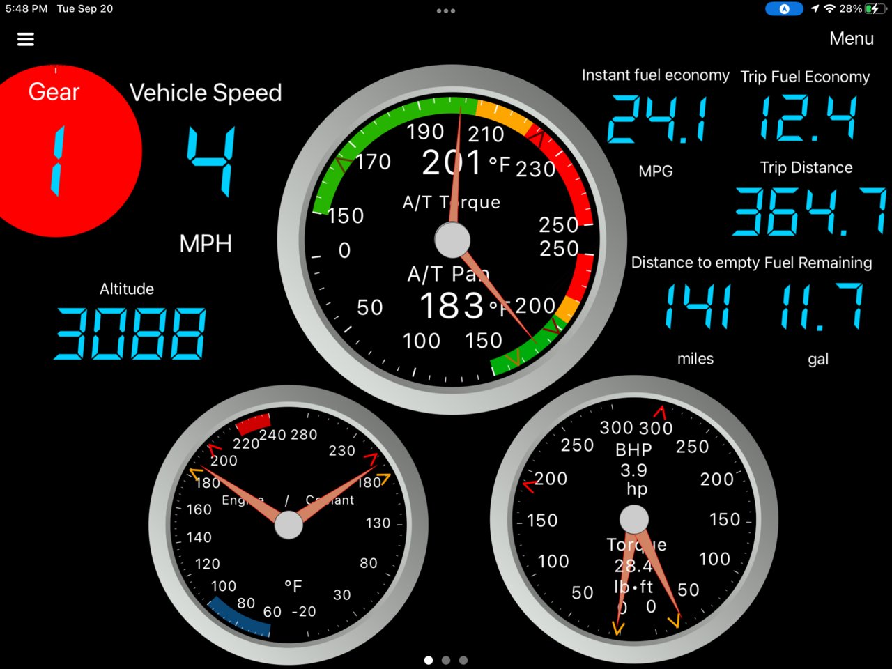

    392 mile drive today from Spokane to Redmond OR. A blustery day with winds up to 20mph. Averaged 12.4mpg.
    Ran the rig over the scales and came in at 10,000lb exactly. This is the heaviest we’ve been in the past 7k miles.
    2820 front axle
    2840 rear axle
    4340 TT axle
    This puts me over on payload by 60lb and under GCWR by 1,300lb
    I want to run the truck over the scales without the trailer to see how well the WDH is doing its job but judging by the above numbers I’m in the ball park. Todays drive had plenty of wind and semis and the rig felt perfect. I just wish I had a manual gearbox :)
    P.S. I had a cool dream last night…I dreamt I installed a supercharger in my taco. Not sure I need it as OBD fusion recorded a max over 300lbft torque!!
    .:rofl::burnrubber:

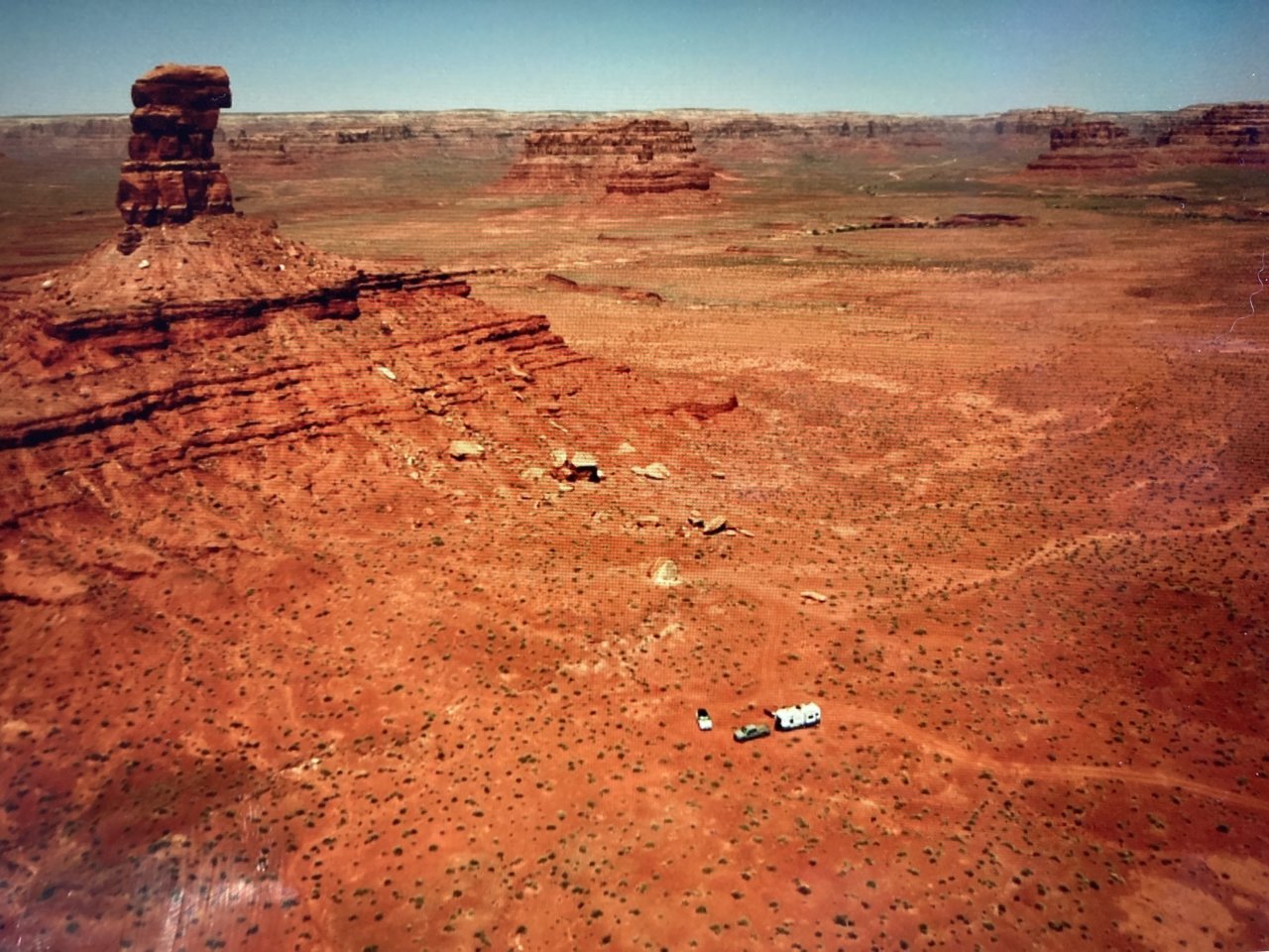

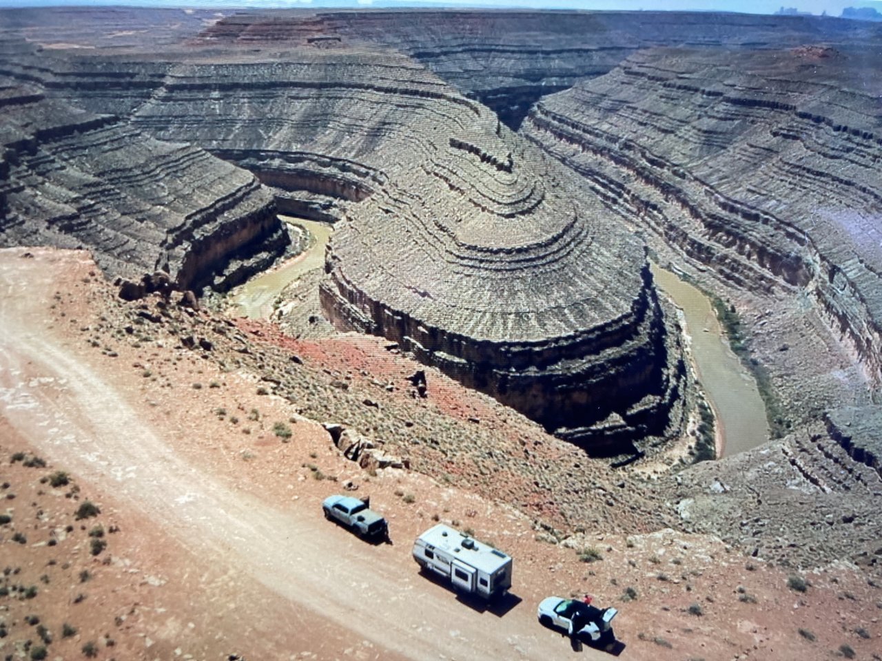

    This is badass. Sweet shots. Got a drone too? Do you boondock often or is this passing through?

    Yeah, I don’t use it enough.
    We boon dock when we can but do like some luxuries most of the time.
    Biggest issue is being able to carry enough water.

    Was that trip boondocking? I’d love to but I imagine that’s a bigger truck and trailer.

    That trip started Nov last year and ended July this year and was over 6k miles WA, OR, CA, AZ, NM, CO, NV, OR, WA. That was with the two cars as we thought AZ was going to be the final destination.
    We’re back on the road with just the truck now… WA, OR so far. Trying to relocate and find a new home… will be checking out central CA coast again and inland a bit then likely check out northern AZ and maybe Austin & port Isabelle…
