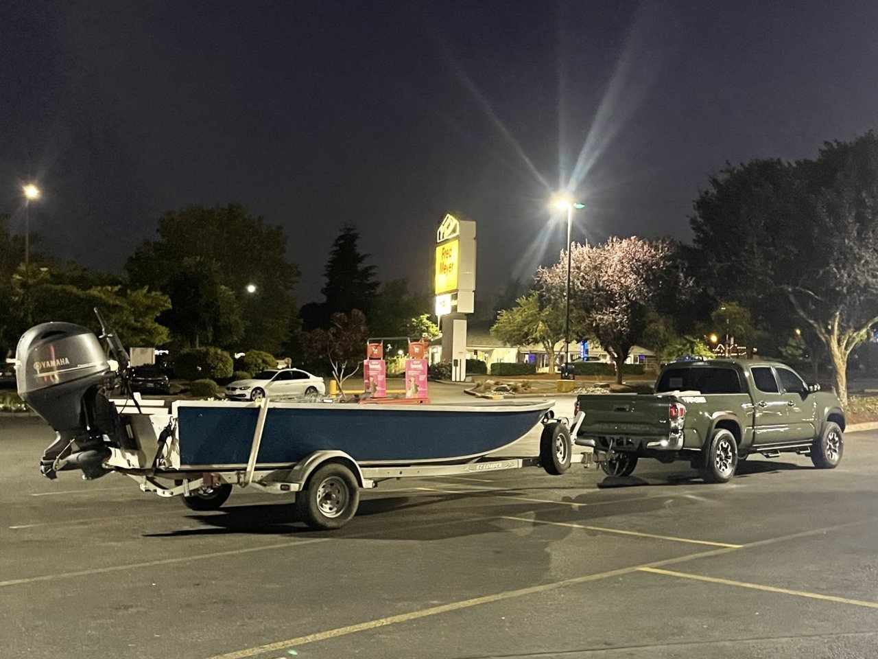

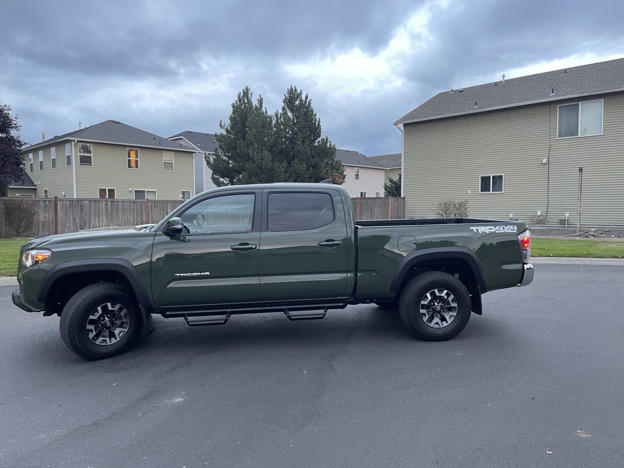

    Hey y’all! Not new to the Toyotas, (had a single cab pickup and fj cruiser) but new to the forum!
    The other weekend I was happily surprised when the new Tacoma pulled my boat no problems. Only just a little bit of gear hunting in the mountains with ect on.
    As for power, no problems at all. I just had to get used to the revs being a little higher.
    Not too much squat, pic below shows a 2” drop for the hitch, so it looks a little lower than it should be.
    I plan on just doing some spacers and AAL 265/75/16s and a topper eventually.
    boat is a jet sled. Willie 22 footer aluminum with 115/80 jet. Weighs around 3000-3200lbs. Flyfishing (Spey long lines only haha!)
    Was initially hesitant to get the Tacoma because I wanted a slide in camper and a full size fits the bill a little better. However, I will make do with a soft top canopy and am amazed by this truck!
    I came from a Nissan Titan xd with the diesel Cummins. But the crank broke at 110k miles, ( the engines have been known to have crank issues and they wanted near 25k to replace) so here I am back in Toyota land and am happy!

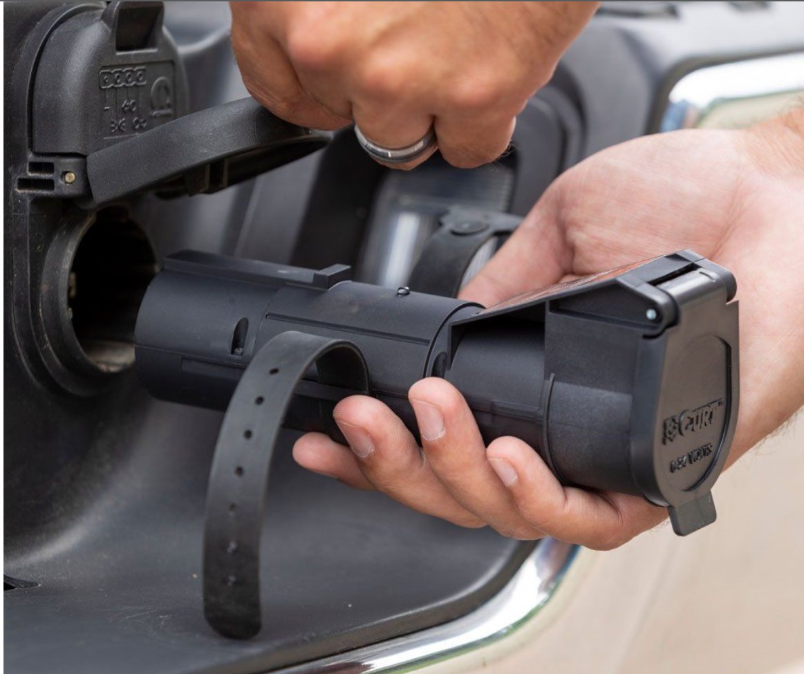

    I have the bluetooth connected Curt brake controller. It plugs inline to your trailer's 7 pin connector, and then directly to your Toyota's 7 pin connector. You use the App on your smartphone or tablet to control it/configure it, you can change it on the fly as with the RedArc or Tekonsha controllers, and also manually apply the trailer brakes at any time, independent of the truck's brakes. Cost was around $400 if I recall correctly, we bought it and the weight distribution hitch at same time as the trailer earlier this year, and so we paid for everything all at once, so I don't recall the exact price for the controller.

    I looked into this. My only concern was varying/conflicting signals, being its wireless, when needed. Being it on your phone, you would need to have it up all the time and accessible (phones aren't always reliable and crash/freeze up) and could pose safety issues if needing to use it at a moments instance. Its neat product though.

    Actually, once you plug your trailer in to the controller, and confirm the controller has a good bluetooth to your phone, you can turn your phone completely off and the controller will work just fine. The only thing you would not be able to do is manually deploy the trailer brakes (independent of the truck brakes) and you would not be able to modify the sensitivity/amount of trailer brakes related to the pressure applied to the truck brake pedal. The current settings will remain active. I verified the controller continues to work just fine while my wife and I were towing our 20' Coleman trailer from CA to KY when we moved last month.

    Thats intuitive to have. I would still be concerned for emergencies when needed while the phone is off/not working.
