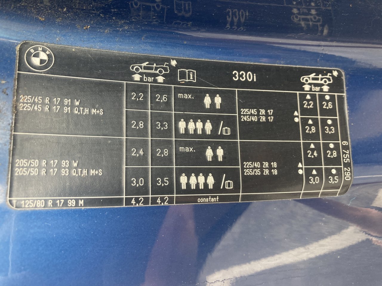

    I don't know why the American market doesn't have a decal in the door suggesting correct psi ratings depending on load like they do in Europe... This decal was on one of my previous cars, a 10psi difference between 2 passengers in the car vs 4 passengers and luggage.

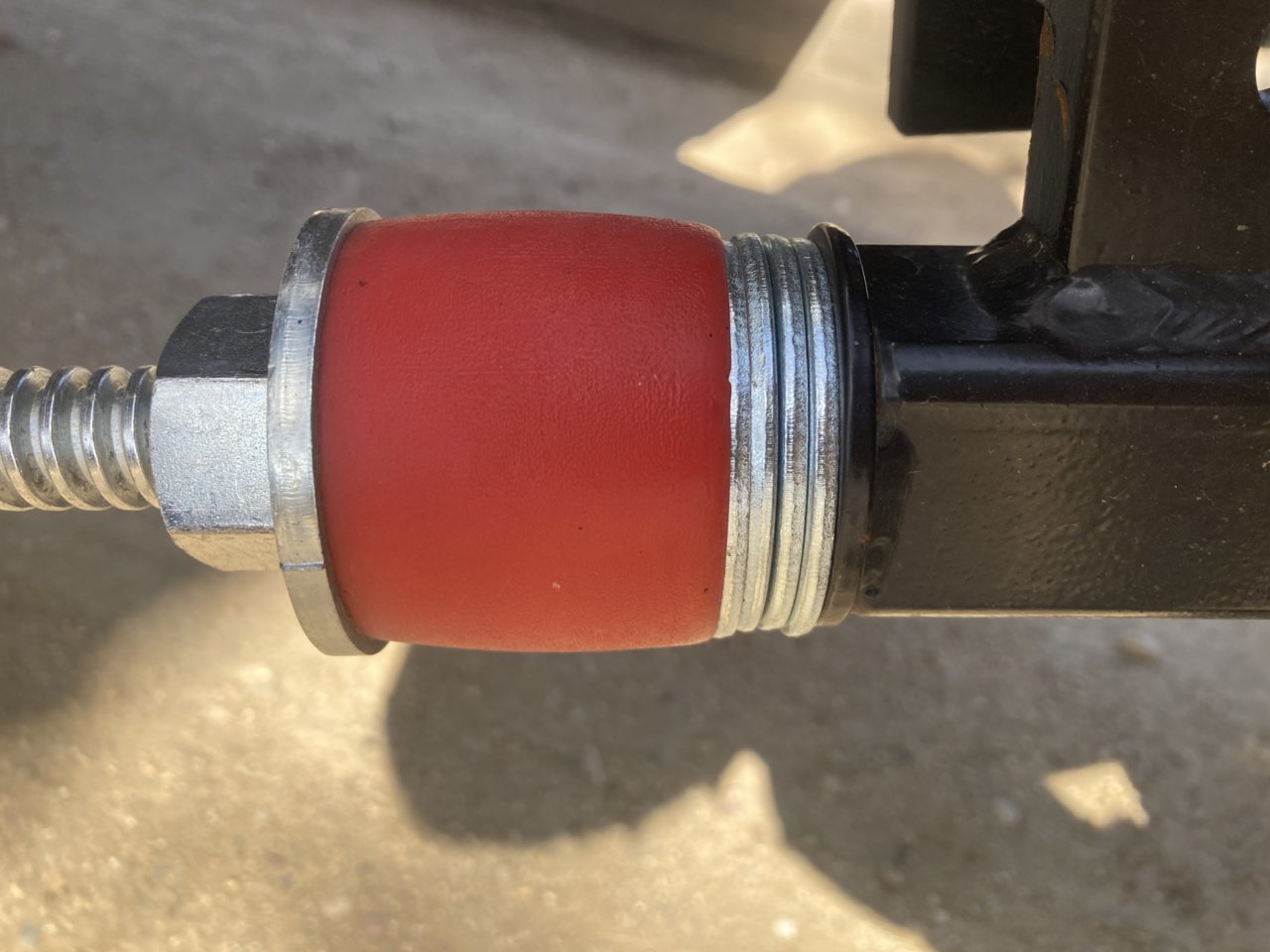

    How tight do you set your Anderson?
    I’ve found a lot of people do not tighten it enough… once you put the hitch on the ball and lock it, lift the tongue jack and the back of the truck 1.5-2” and then do the adjustments. The red collar should be swollen with pressure once you let the tongue jack back down and the system is all under tension.

    Thank you for the photo. I see you have some washers on there to help as well. I definitely had to tighten the hitch multiple times along my 950mile journey. I'm pretty convinced most of my issue was tire related - very little sway. I dropped airbag PSI and tightened the hitch more which helped the vehicle track better. I think just to get everything dialed in. Bags, tire PSI, hitch tension. :)

    Yeah the brackets on the frame slipped a little on the first use and adding the washers was the easiest solution as I've been on the road since picking the TT up.
    The Anderson is great, hopefully a little extra air in the tires will make the difference, I know for me it was! Good luck.

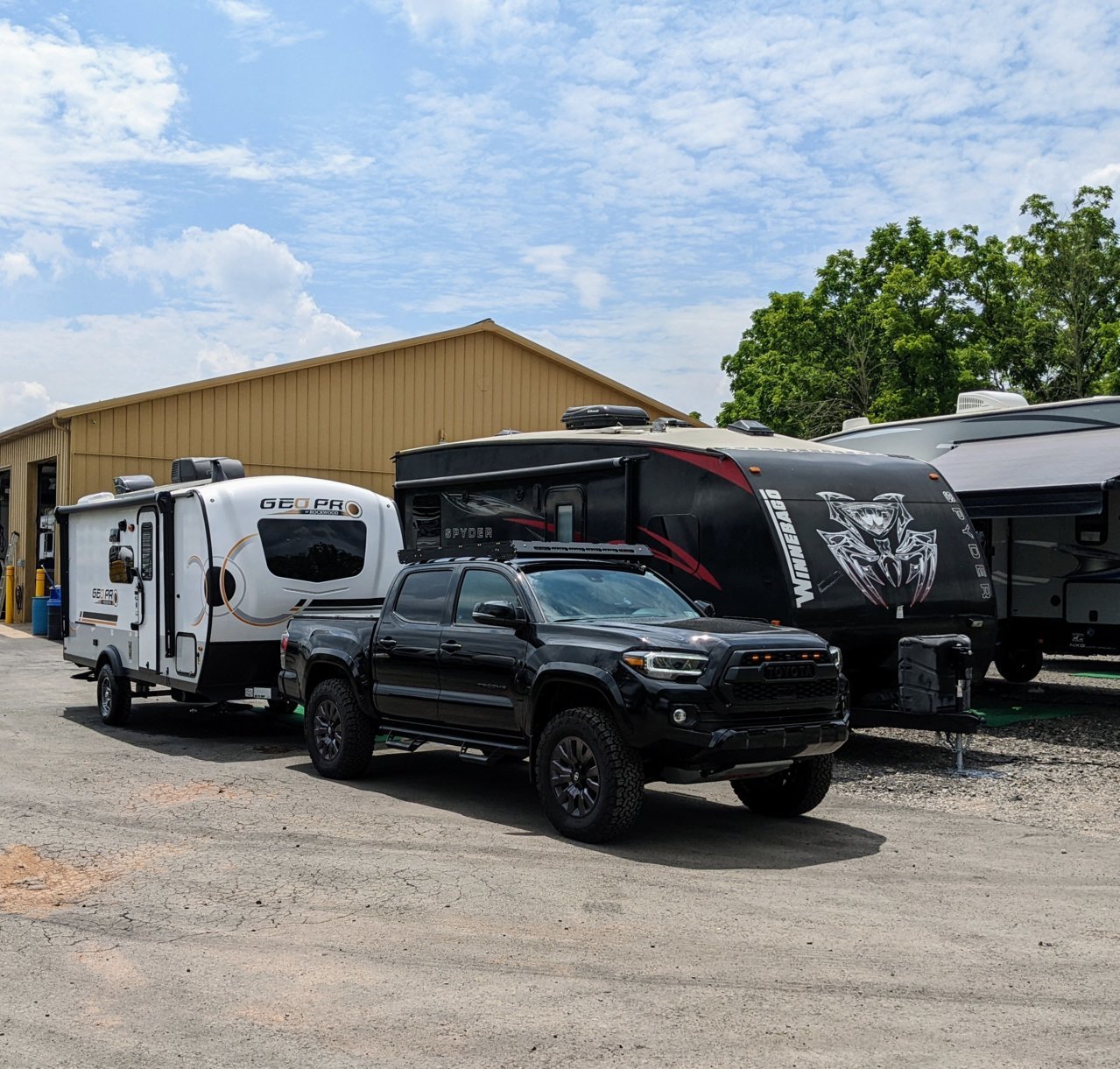

    Put this under camping but needs to be here too
