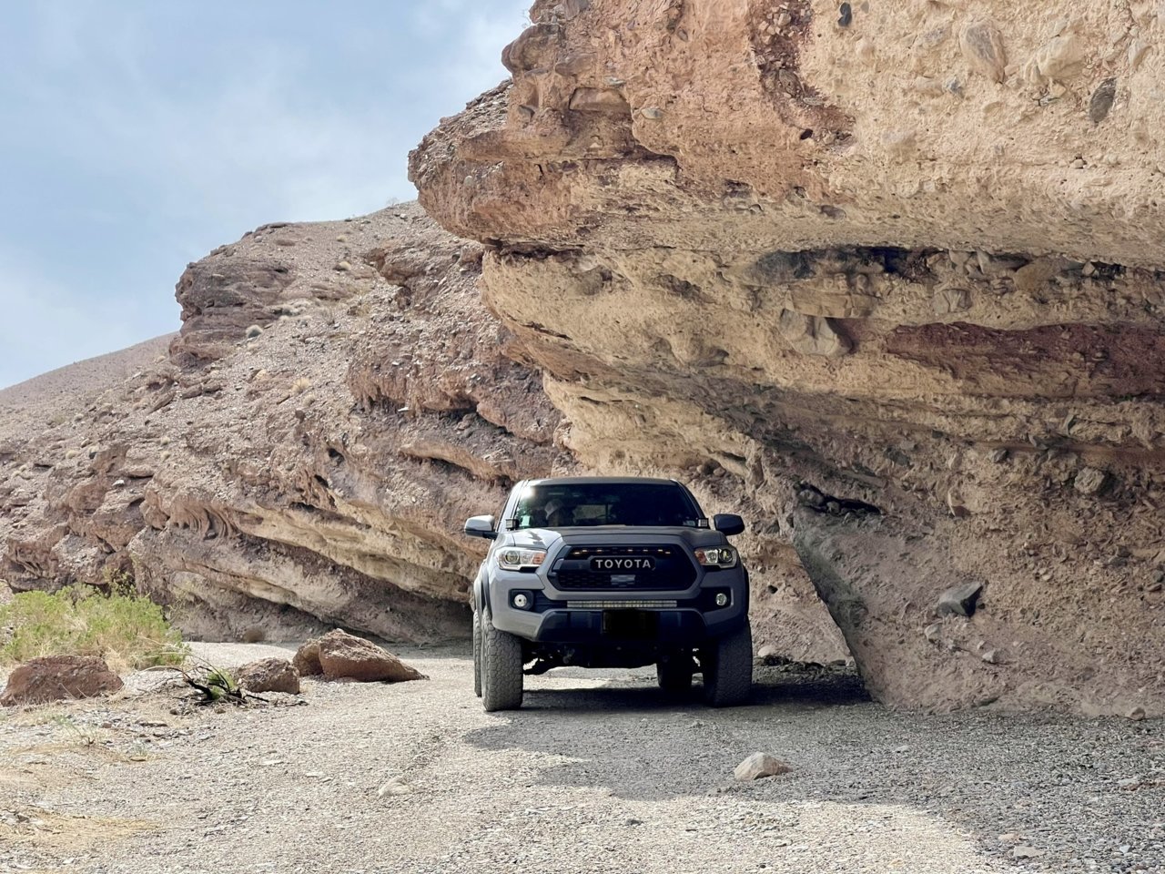

    Just wanted to create an appreciation post and show off my 3 years of hard work. Maybe get some Recommendation on what mods to do next.
    I mainly focused on the Sound system
    I have a an active 3 way system
    Tweeters: Blam Audio TSM 25MG - Built in custom wrapped a pillars on axis
    Midrange: Blam Audio MS3.55 - In Stock factory Tweeter Location
    Midwoofer: Blam Audio WS8 Multix
    Rear Doors:
    Tweeters:
    Midwoofers: s 165.80
    Subwoofer: 2 Helix k 10s
    Front stage is Processed by a Helix DSP 6 Ultimate: 6 Channels of Amplified Audio + 6 Chanels of DSP for a total of 12CH
    Rear Fill: Helix M4
    Subwoofer: Helix P2
    Full car (except hood) is sound treated: sound skins on all for doors, NVX Sound Treatments + Reduce 10mm on floor and back Wall.
    Doors also have MLV to add weight so there is 0 rattle.
    Currently using factory radio but and waiting for a custom iPad dash kit that will run the sound directly to the DSP Ultimate with a topping d10 DAC
    I have Raptor Lights, Caliraised Off Road Hidden From bumper Bar Light, and Baja Design Squadron R Hood lights.
    Will include more pictures of my build
