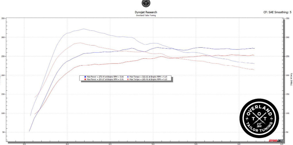

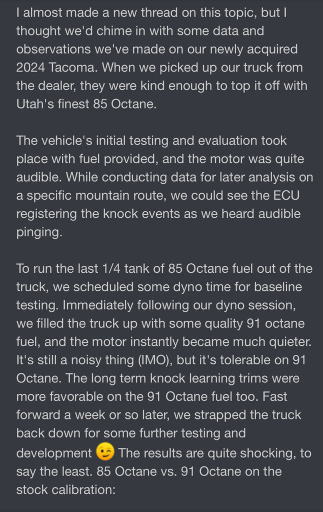

    Found this on another forum. Impressive numbers! Thank you OTT

    But didn't it also go through a little break in where resistance becomes less, since the lower dyno is essentially straight off the dealer lot
    someone make them go back & put in 85 for a week and dyno it again…. In same weather conditions

    These were done 1 week and 150 miles apart. 250 vs 400mi
    Correction factor was identical. This is as back to back as you’re going to find in the real world.

    wow, that's a big increase . love the torque power increase
