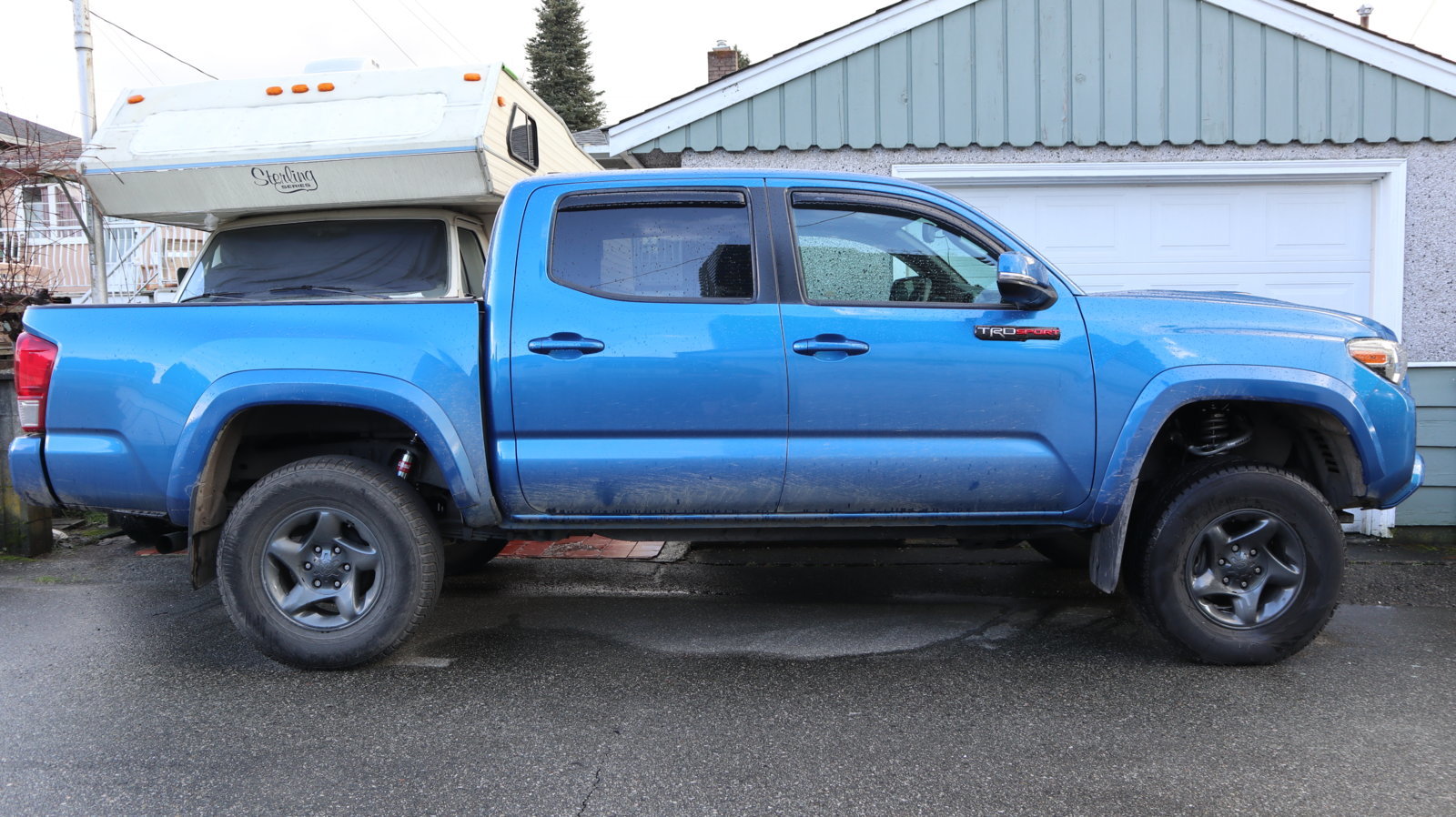

    They will fit. I am running 2005 Tundra 16" wheels on my 2017 Sport for winter purposes.
    Anything factory equipped 16" and larger with the 6 bolt lug pattern should fit the 3rd Gen Tacoma, regardless of model. The brakes front and rear are all identical on the 3rd Gen regardless of year or equipment.
    (There is a change to hub pilot diameter on new 4runner wheels.. not sure year this started... these wheels may require modification to fit correctly. )
