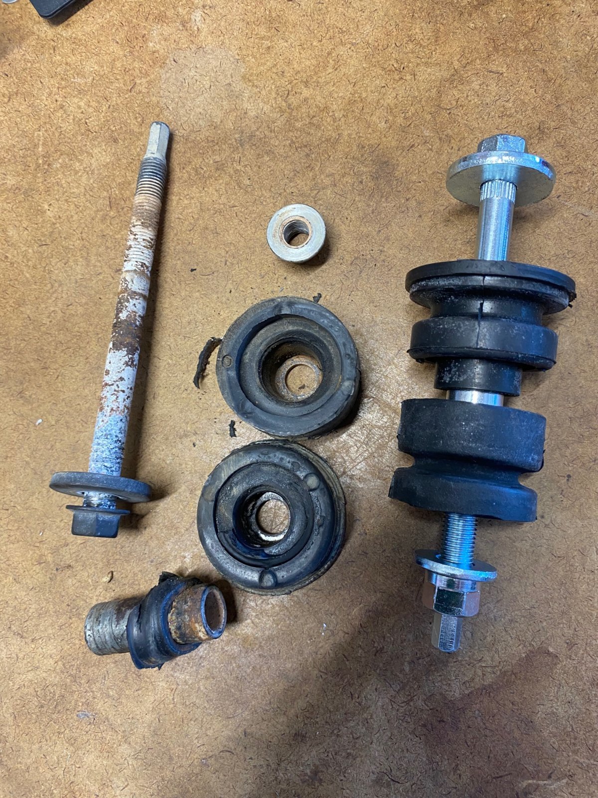

    Did my 2009 today and used Dormans complete replacement and its rubber like OEM.
    Amazon.com: Dorman 924-267 Front Body Mount Compatible with Select Toyota Models : Automotive

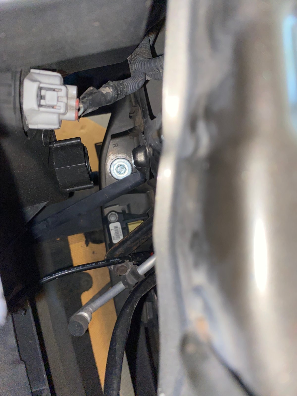

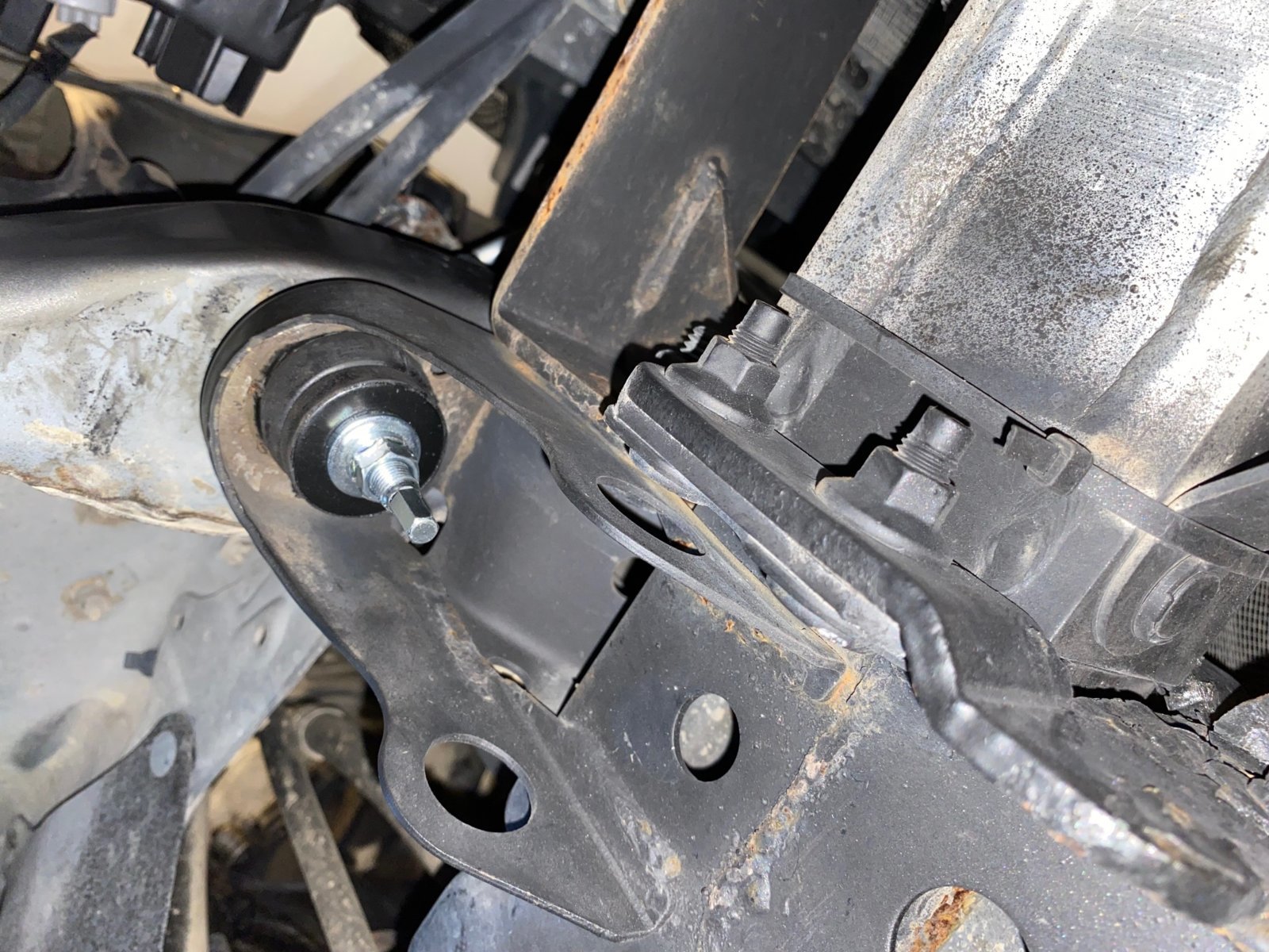

    Pic of installed torqued to 30 ft-lbs as body says 34 but felt they might stretch and they were compressed. 14mm nut and bolt head and did it on ground with just a good pry bay to get old out and new one in. Added a pic of the bolt head with hood open look down behind the headlights and with a second set of hands way faster. I was solo so a zip tie moment as I used a few extensions and zip tied the racket to the upper radiator support - perfect!
