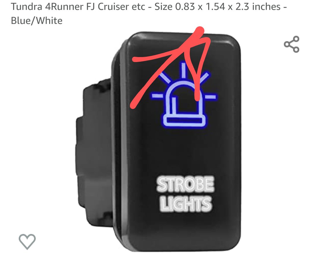

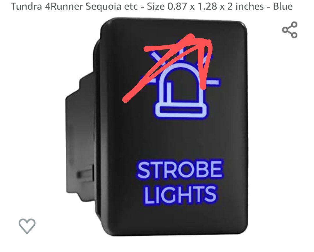

    No dimensions needed. Dash switches come in two standard flavors - "Toyota tall" is 3rd gen left panel, (some switches) and I think overhead console?. "Toyota small" or "Toyota short" are the other left panels and center console.
    CH4x4 makes them, as does Mictuning. My last purchase was from a little company called Stark Industries and I really like their quality compared to others.

    Stolen from various sites.

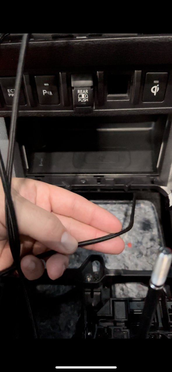

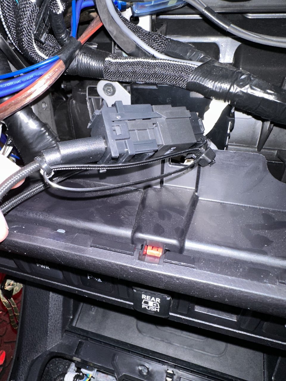

    UPDATE: Hello guys, just finished doing my media port relocation. I was doing the anytime camera and Zpresicion cup holder install and took the chance to do this. I removed the media port from the dash and secured with zip ties a 10ft usb cable on the port, then snaked the cable from the dash up to the center console storage underneath the plastic. So far Apple Car Play works great. Hope this helps anyone trying this.

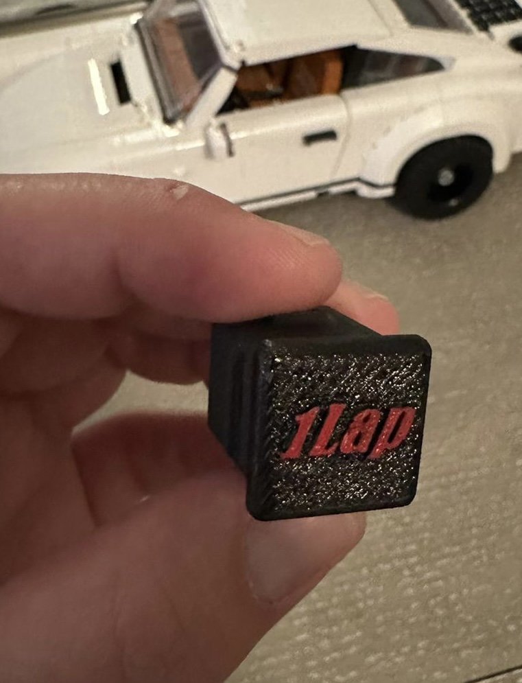

    also 3D printed a 22mm blank to cover the usb port hole.
