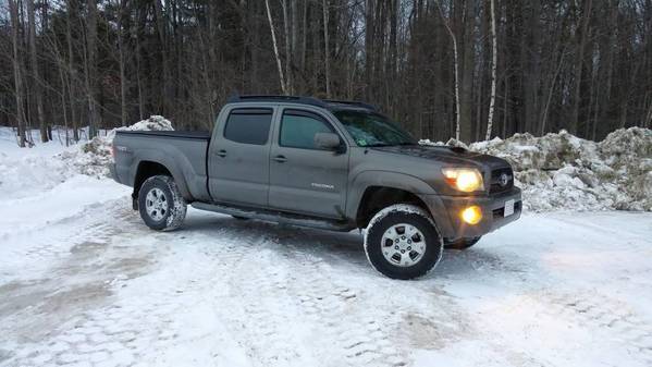

    Here's how it sits now:

    Finally got the 5100s on all four corners with 884s in the front. Got 2" in the front. It's almost level...back end is very slightly higher which is my preference anyway. Handles and rides dramatically better than stock. I think I ended up with 2" in the back as well rather than the 1.5" I expected, which is why the back is still a bit higher.
    I'll take some photos today and get final measurements. Last night it was too dark by the time it was done. It looks great. Someone who didn't know Tacomas would think it was stock. It looks the way a DCLB should have come from the factory.

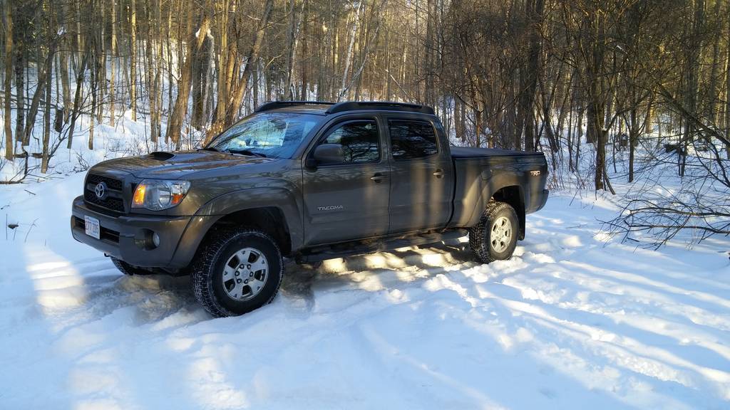

    How it sits now...

    Looks excellent man.

    Thanks! I'm happy with how it came out. Should be that height with that suspension from the factory IMO.

    Another photo showing the current height...
