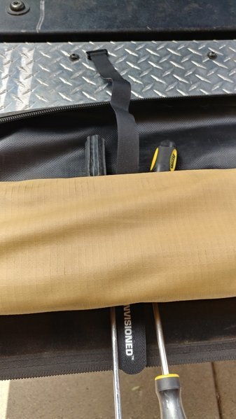

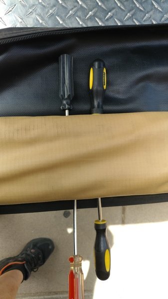

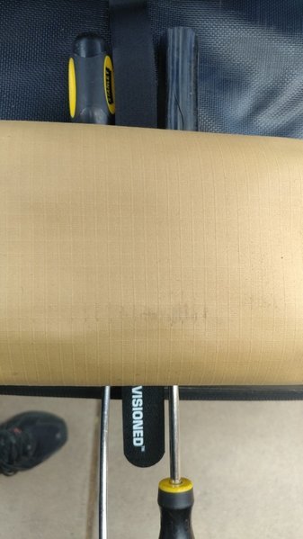

    1. Lift one of the poles and locate where the pop rivets are at. You will need to place 4 small flat tip screwdrivers in the middle, between the rivets and lightly push each screwdriver between the exterior cover mounting rail and the awning rail. Leave about a 1 inch space to allow the velcro strap to be pushed through opening. Be careful not to tear the exterior cover. Place each screwdriver as shown below. Just pry enough to be able to push the new Velcro strap through the pried opening. The opening/gap is only about 1/16 of an inch.
    DO NOT PRY BEYOND PRELOAD OF THE AWNING RAIL. IF YOU PRY TO FAR THE AWNING RAIL WILL NOT SPRING BACK TO ORIGNINAL POSITION.
    After you push the new Velcro strap through, remove the 4 screwdrivers and the rail will spring back/return to its original form.

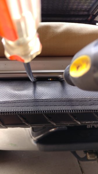

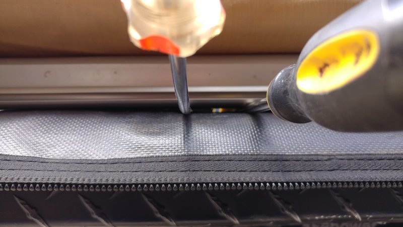

    2. As you can see below is just enough gap to push the new Velcro strap into place.
    3. Push Velcro strap through opening.

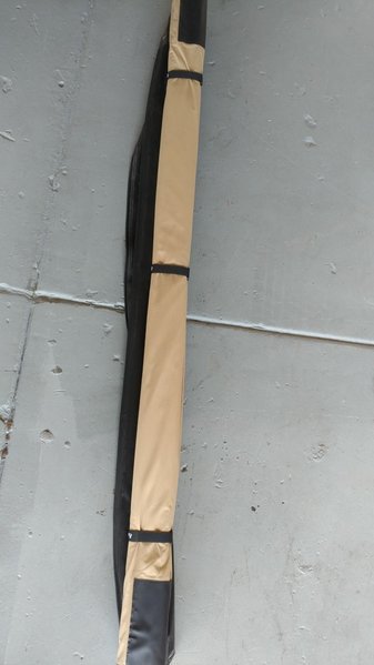

    6. Repeat these steps to place additional Velcro straps as you see fit.
    7. End results shown below.
