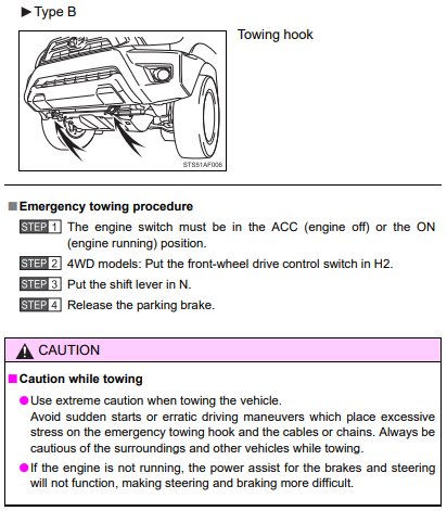

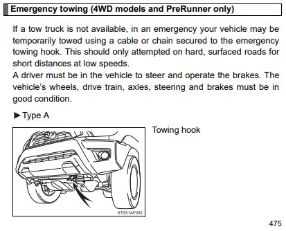

    The loop on the driver side is not a towing point or recovery point, it is a tie down point for transport. Do not pull a stuck vehicle with it. SR, SR5, TRD Sport, and Limited Tacomas also do not have anything on the passenger side except the bolt holes to add something yourself if you want.

    According to Toyota, it can be used for towing in emergency situations. Again, I'd be cautious of using it for recovery, especially if the vehicle has been mired as the manual states the vehicle should be on a hard surface.
    Reference: 2014 Toyota Tacoma Manuals & Warranties | Toyota Owners
