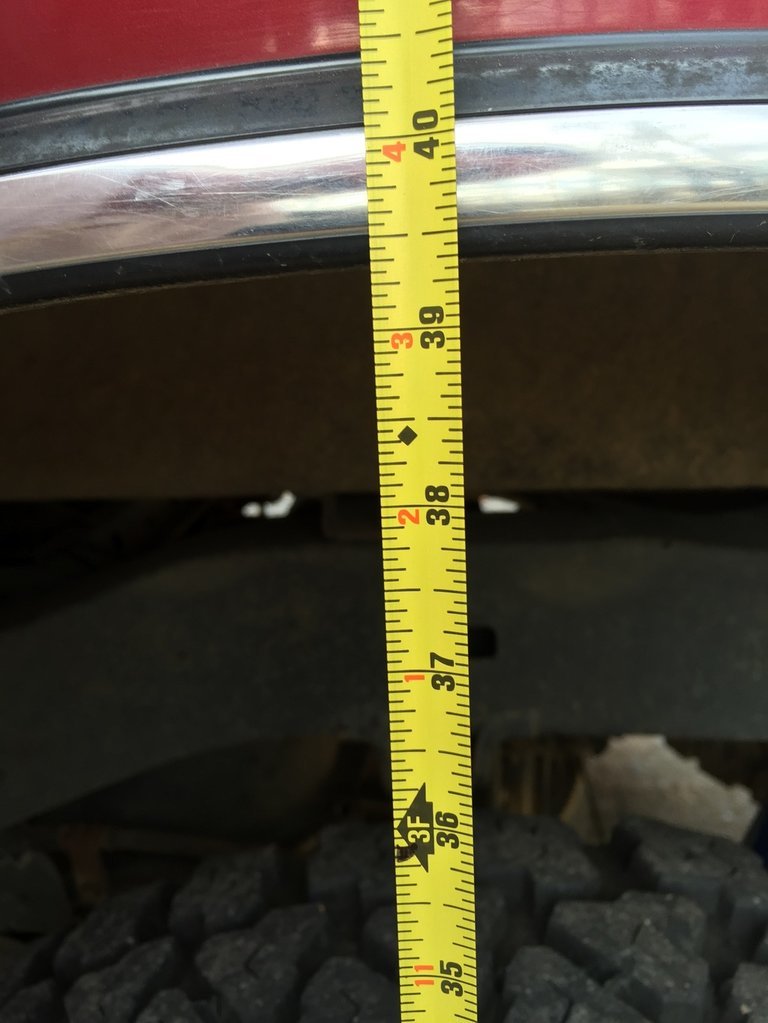

    Looks like I'm going to have to raise the front about 2" to keep it from looking silly. I guess I should have went with the standard springs.
    Raised my truck 3 in. What is the best way to raise the front about 2 in.?

    Are you sure you have the stock shackles ? I have the same dia wheels and HD springs and the rear lip is only at 37 and a little. I have the Lear canopy cab hi on mine.
    Or did you order the 01-04 springs?

    Shackles look to be about 4 ins. and I ordered springs for a 99. Part # for springs is 90-203HD. Tires are 17's

    Those would have settled a good amount I imagine....

    Man that amount of rear lift is nuts! Wonder what the deal was? I'm putting in my HDs next week and better not have that much lift in my 04! Talk about shock destruction...

    Stock shocks were 2 ins. from even reaching the pins. I found some shocks for a 1500 Chevy that had the length needed. I couldn't deal with all the lift, headlights were pointed into the ground and I had to jump a little to get into the seat. Don't mind the height of the old springs, just bottoms out on bumps with a load. Might just try the AAL.

    Yikes...I'll be pretty bummed if I wrecked my $200 shocks when the General's go in. I'm going to load the hell out of the box to seat those springs. I'm still amazed that you got 4" out of those springs. Everything I read said 2.5 - maybe 3 before they broke in. I wonder if the 99's are a bit different and maybe would've settled if you loaded the bed down.

    Im sure those springs would of settled right down with a lil use. As for gaining so much lift im sure it only seemed that way because of the stock leafs being so massively worn out and sagging atleast 2". Had the front springs been replaced as well surley everything would have worked out just fine and there wouldnt have been such a dramatic rake...

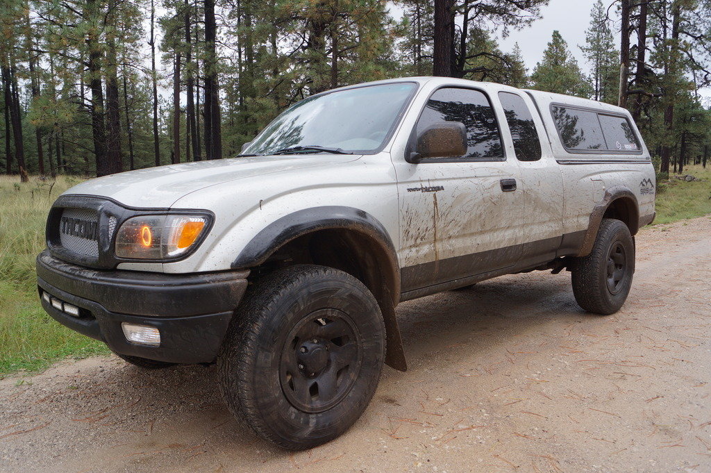

    Mine looked pretty silly at first too:finish-10-2_84c6be97669d2e49adcff969535cc13cfc185b5b.jpg

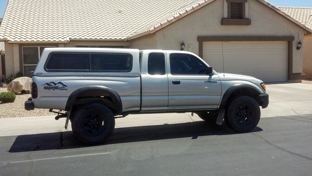

    After bilstein/OME lift:DSC05551_d595f15bc5f9f4b6577452cb4c6e4bdde25c4887.jpg
