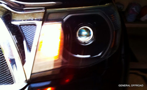

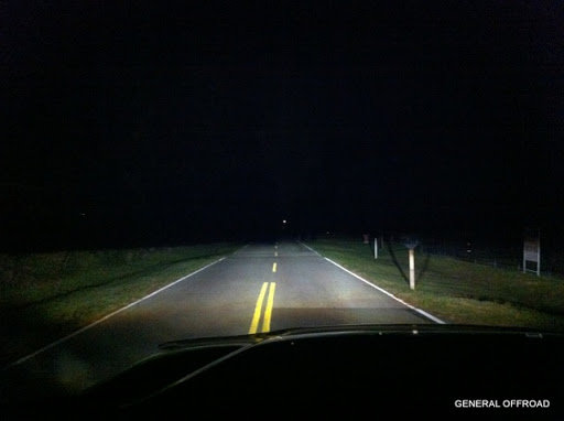

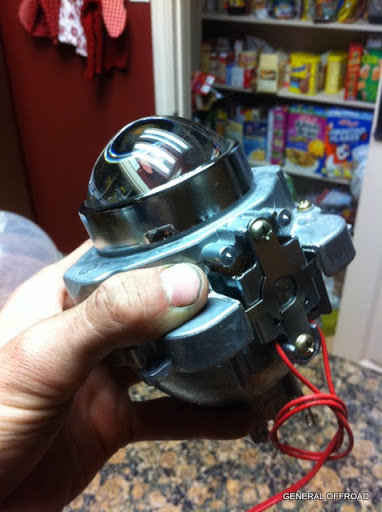

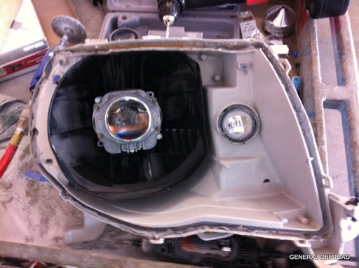

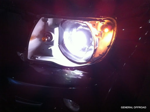

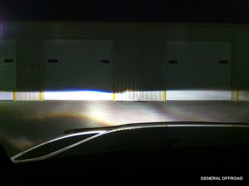

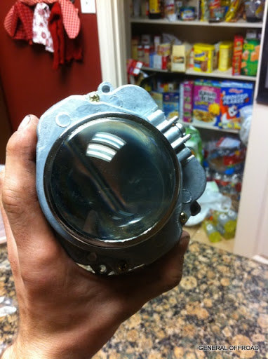

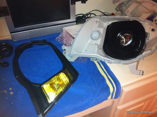

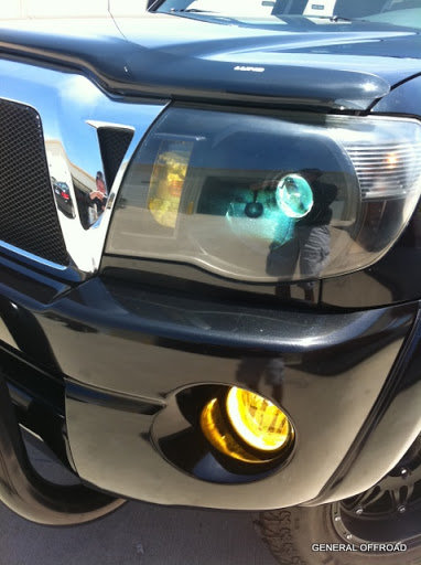

    Did this before I made the build page..but thought I'd add it, who knows it might help someone who wants to do the same.
    bought the XFR from TRS when we did the TW group buy
    specs on the kit and tools:
    -XFR projector
    -50w morimoto ballast
    -4300k bulb
    -gatlin gun shroud
    -torque driver to take apart headlight
    -oven
    -dremel to cut out back of reflector bowl
    -8mm socket to remove reflector bowl from housing
    -quick steel (for my glue) good up to 500*F
    I did BHLM even on the shroud and bowl, lightly night shaded the orange reflector also..then tinted blinker covers yellow and replaced orange bulb w/ clear to give the blinker a yellow look and have them match the fog when I had a stock bumper
    Once I had fitted the projector and tested to see if I liked the position for headlight alignment in XY and Z(rotational)
    only one in and very impressed..however had to rotate it a few degrees counter clockwise to make it sit level (primary example of why you test the retro fit before putting it back together)
    then complete the steps on the other light and finish painting
    very important to let the paint dry so you don't get any moisture in the light late on that could come from the paint..I'd say minimum of 24hrs
    in the car pics..I'll get better pics soon
