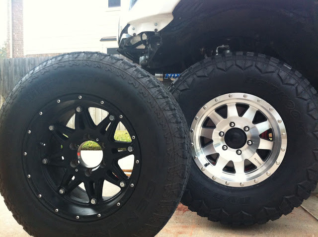

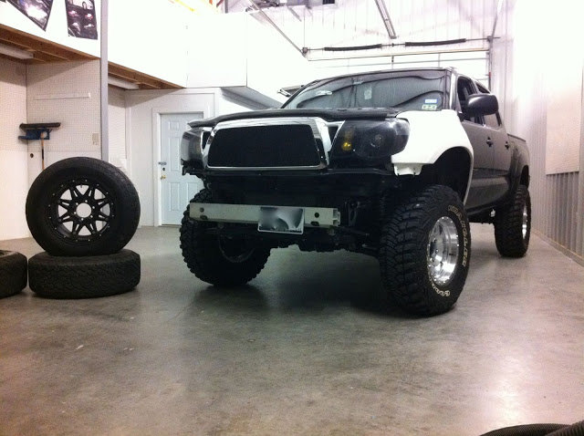

    Finally got my spanner in and adjusted the coil overs. At first I adjusted them too high and went into severe alignment issues as the alignment from the previous lift w/o the aftermarket UCA was off even further then what it needed to be with the proper arms. Got it aligned on a Hunter alignment machine and it rode fine but was still too tall. I want to say I was at 3.5 inches haha..brought it back down till it was just enough to clear 285s without rubbing..I will post the height from ground to fender but that will be useless as most ppl don't have fiberglass (i guess subtract 2.5inches?)..I will post my alignment results even though it was too tall the alignment guy still didn't have a problem..Very pleased with the BR UCAS, of course i need to get it realigned since i dropped it but im going to wait till I have a bumper as I'll have to readjust the coil overs with the added weight.
    Also switched to 16's instead of doing a street and offroad set, got away from the blacked out look as well..Im going for a black and aluminum color combination once I finish the bumper

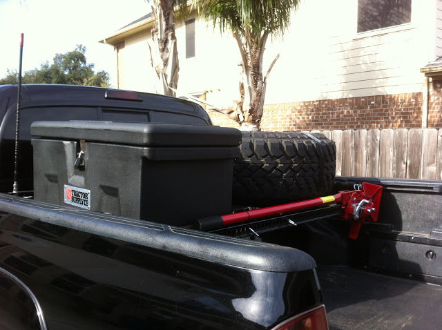

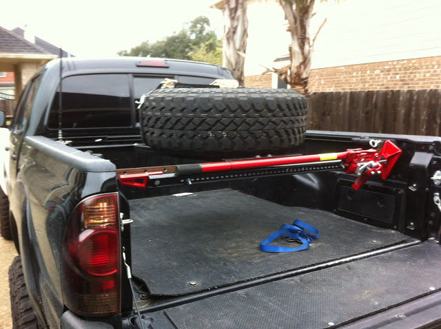

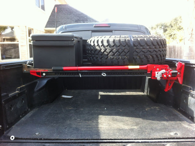

    I also added to my tire rack, still needs some work and paint but it's sturdy and I'm happy with it..after I work out a few kinks I'll post up the specs so others can build their own as well.
