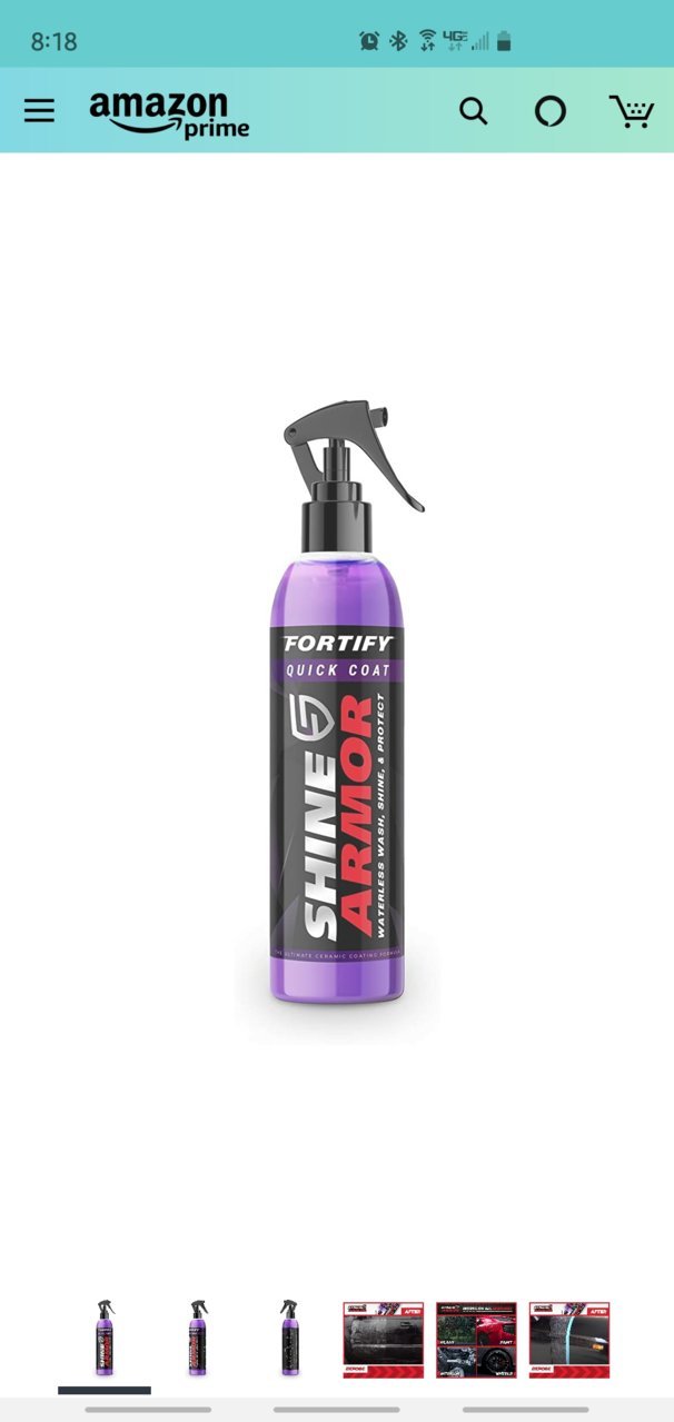

    I just did a cleaning, clay-bar and ceramic coat on my truck about 2 weeks ago. Washed it twice and still holding up. I researched the interweb and Shine Armour was on all the top reviews.

    Hey guys. None of these are ceramic coating. They say "ceramic" in their names, but none of it is actual ceramic coating. Ceramic coating lasts years, not months. It's essentially a semi-permanent clear coat. Since it's basically a clear coat, you have to strip your paint of any glaze, wax or sealant on it. Then you should do a paint correction with compound and a finishing polish. Any imperfections underneath the ceramic coat will remain in place until you remove the coating by either compounding or wet sanding. Modesta is a professional line you can't buy your self, but there are other DIY kits are great such as gtechniq.
    If you don't have a DA polisher, pads, etc, I wouldn't try to do ceramic coating on your own and let the professionals do it. Here's a good example at paint correction and ceramic coating.
    https://www.youtube.com/watch?v=Y-e0mdhy30E
    If you aren't heavily wheeling your truck and getting deep pinstripes, I'd definitely get ceramic coating.

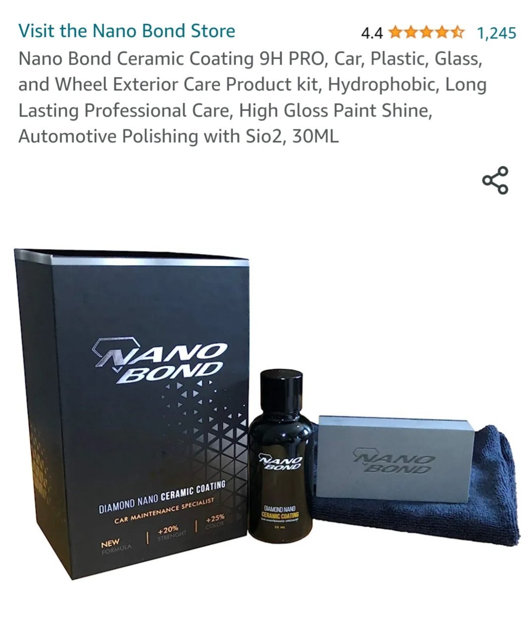

    I moved on from this product a while ago. I actually used the real ceramic coating, Nano Bond. Excellent product when applied correctly. Prep being the main factor. It's been at least 2 years and looks pretty good but getting ready to redo again this fall.
