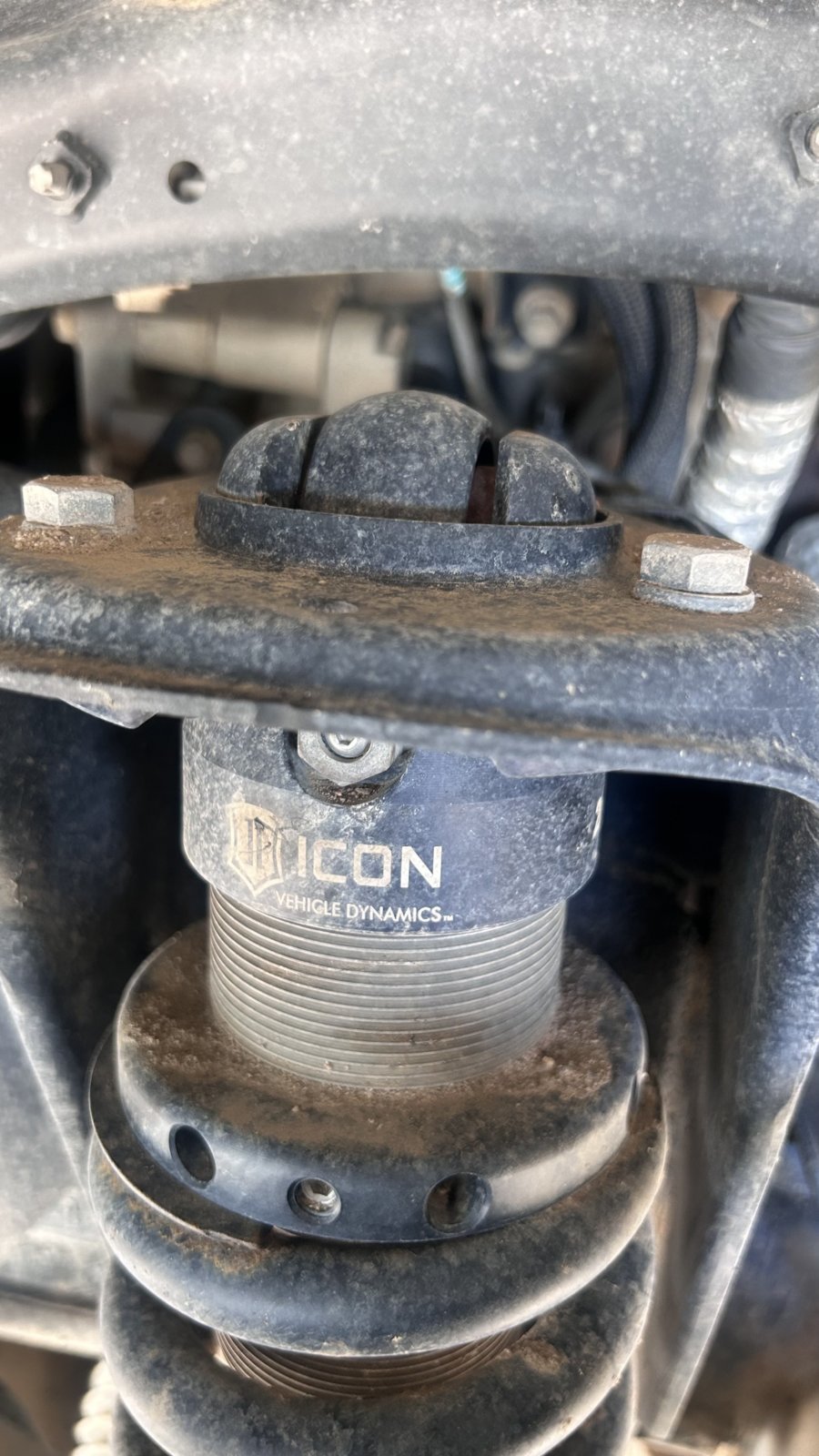

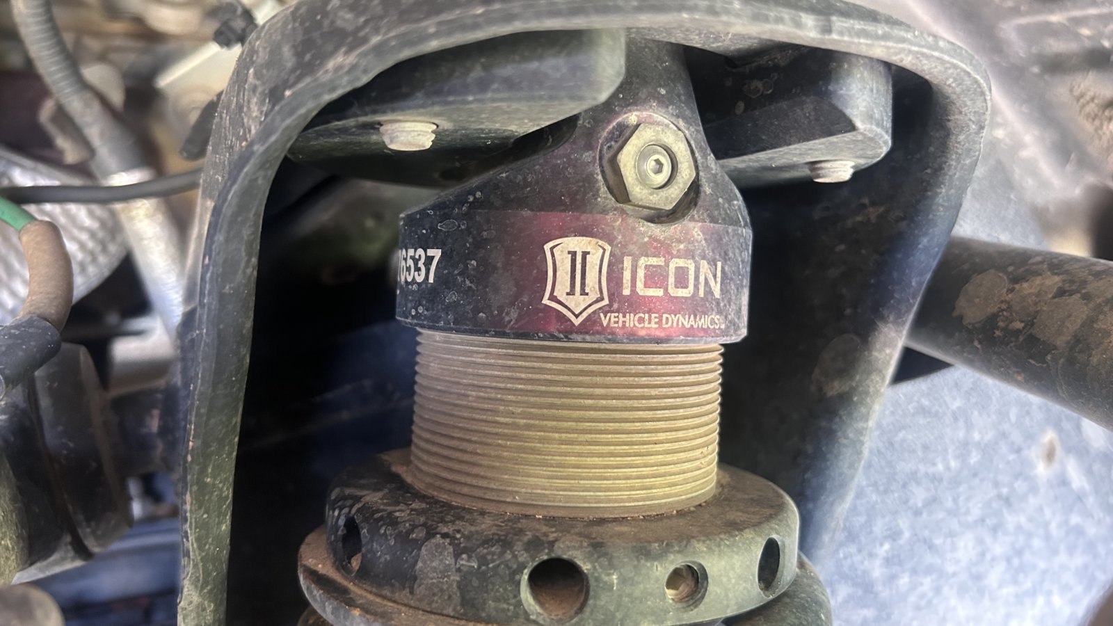

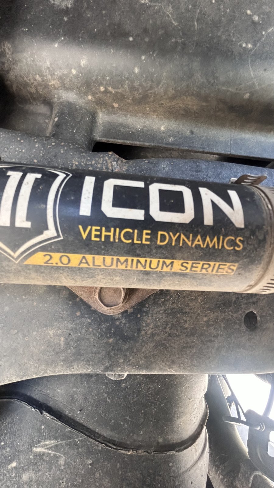

    IMG_0443.jpg IMG_0517.jpg IMG_0522.jpg IMG_0521.jpg IMG_0523.jpg IMG_0453.jpg Recently bought a 2017 Tacoma TRD Off-road and it already has icon 2.0 aluminum series in front and rear with stock rims and 285/75r16 tires. It’s primarily gonna be used for easy to medium level off-roading/camping trips/overlanding build; other than my 6 mile round trip to work three days a week. I was looking at 17” Method Race Wheels 704 bead grip with 0mm offset along with 295/70r17 Baja boss A/T. I’m not entirely sure how tall the current lift is but the tires haven’t rubbed at all yet so I’m not entirely sure if I’d need a new lift system for the new wheel set up (wouldn’t mind buying another lift setup). Another thing is the gearing with big tires, would upgrading the gearing be a good investment for my situation?

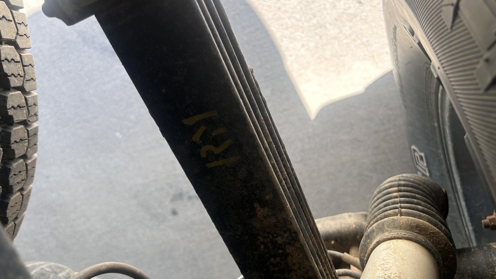

    How many miles on those shocks? Appears to be a bit of surface rust on them.

    I’m not entirely sure I couldn’t find anything in the service history but yes they do look old and I was looking and total chaos uniball upper control arms. I’m fine with staying on 285s was just wondering if I could pull off 295s

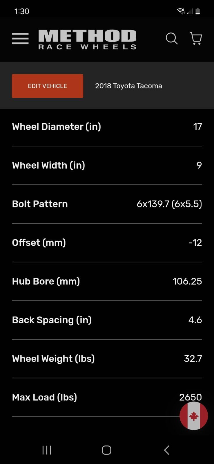

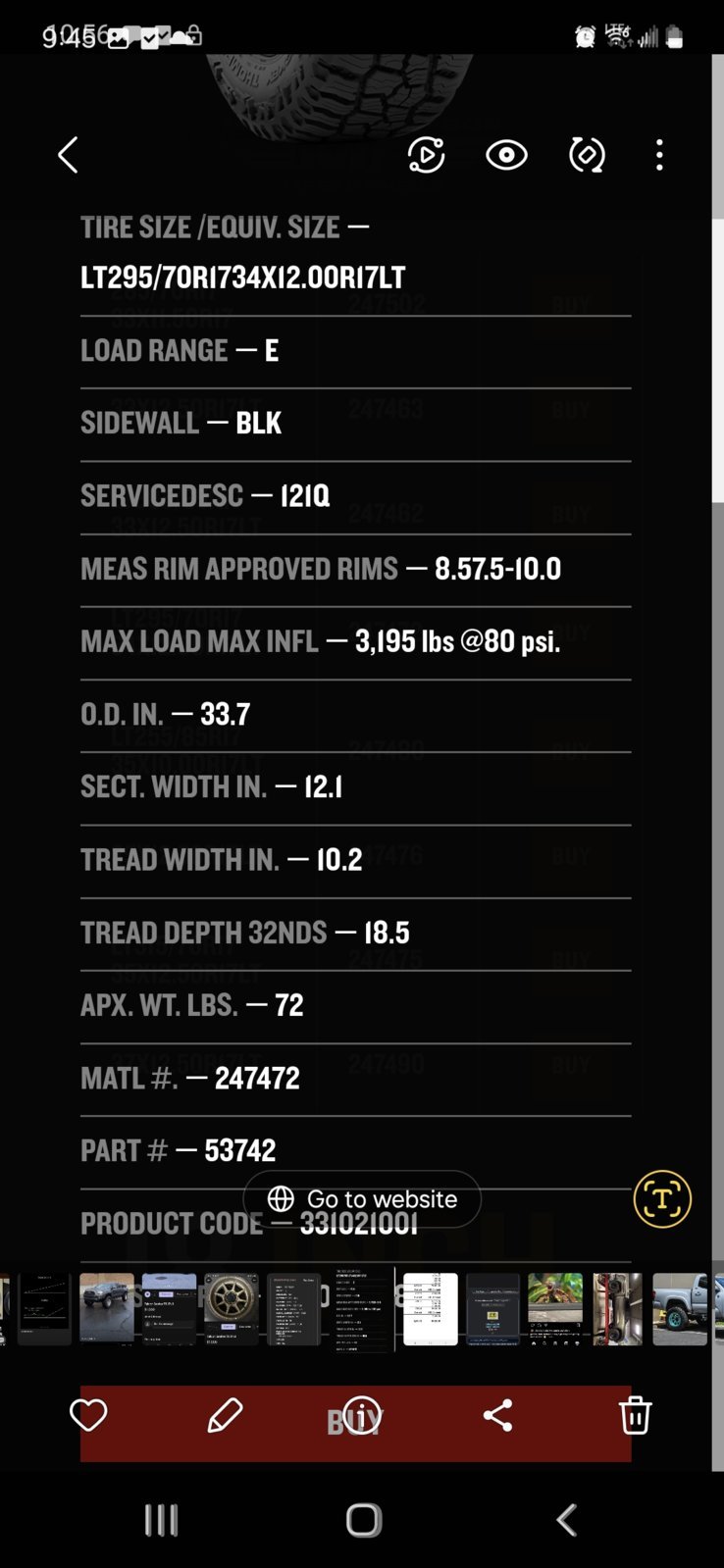

    I want to point out aswell that the wheel and tote combo you looking at is quite possibly the heaviest possible. I can't recall if it's the 703 or the 704 are in the ball park of 30lbs and the 295 baja boss is over 70lbs I would need to double check for the exact spec.

    those are icon 2.5" coilovers up front. actually a pretty nice setup. they can be adjusted to any height of lift with the threaded body. i would guess they are set around 2-2.5" of lift as the are. only reason you aren't rubbing now is because of the positive offset on stock wheels. even keeping same tire size going with 0 offset your gona have to do some trimming. should clear cab mount tho. going to 295s youl probably get into it.
