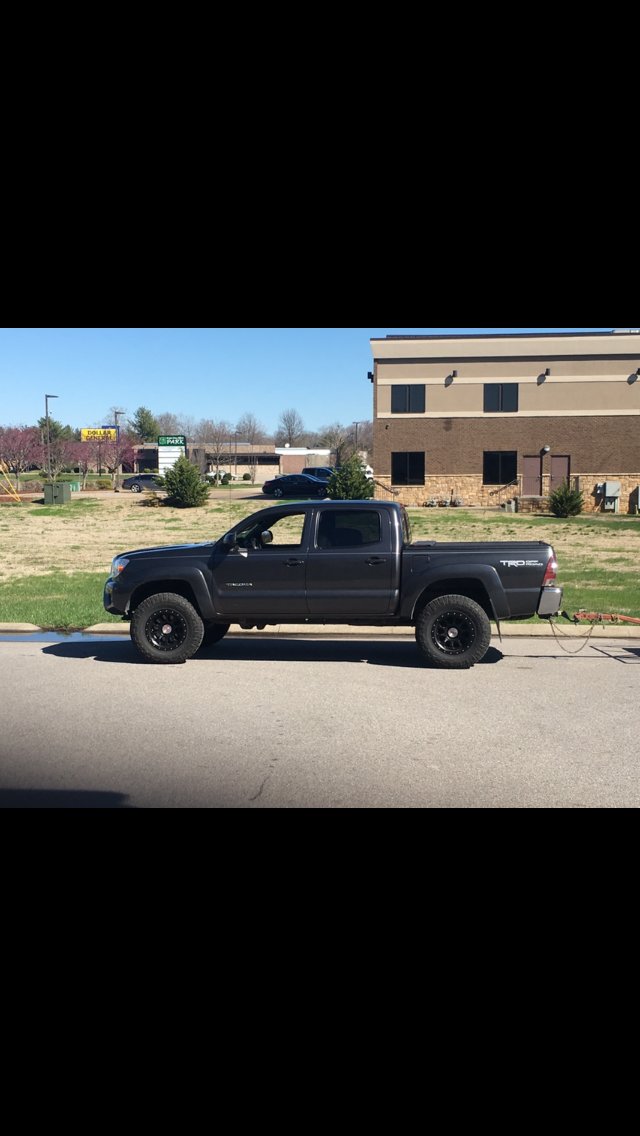

  19. May 10, 2019 at 7:42 AM
    #39
    Tfs94gt
    Tfs94gt Well-Known Member
    Jul 4, 2017
    #223101
    73
    2013 DCSB Trd OR 6 spd
    Nope. Factory brake lines. Zero issues at all.
    That’s after about 25k miles with them.
  20. May 10, 2019 at 7:49 AM
    #40
    806Taco
    806Taco Mr. Worldwide
    May 6, 2019
    #292423
    112
    Texas
    2013 Double Cab Short Bed
    Bilstein 6112 (Front) Bilstein 5100 (Rear) General Spring KC - HD Leafs Poly Swaybar Bushings Braided Stainless Steel brake hose Intake Manifold Spacer Retrofitted Headlights
    That looks nice man.
    Are you on stock shocks/coilovers?
