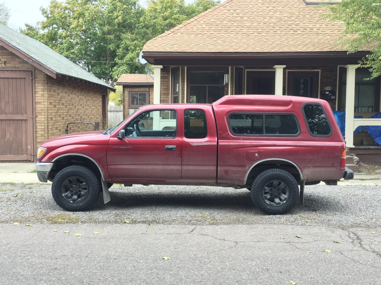

    With that said, here's the sad sag before:

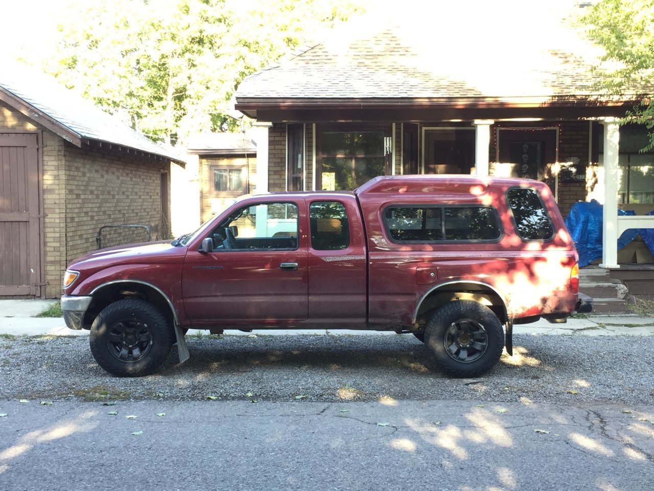

    And the happy new springs after:
    As you can see, the new springs more or less returned the truck to stock height. There's a very slight rake if you really study it, and that's a-ok with me. I've only put a few miles on the truck since installing the new springs, and I'm sure they'll settle a bit. But, I'm 100% happy with the results right now. The drive home on the freeway from a friend's workshop space was dreamy. I'll be hitting a lot of old two tracks in the snow and mud looking for antelope in Eastern Montana this weekend, and will really put the springs to the test then.

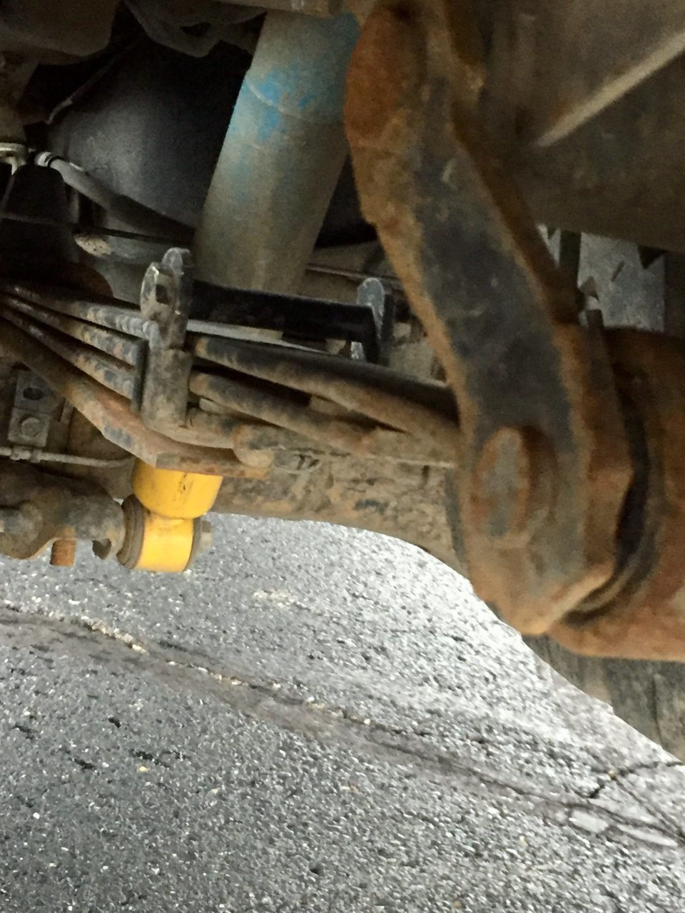

    A note about installation: I'm guessing that the springs on there was original to the truck. Springs were likely over 20 years old with nearly 200,000 miles on them. EVERYTHING was stuck in place. I'd doused all the mounting points daily for three days with penetrating fluid, and hit everything with an impact gun. I still had to cut every mounting point with a grinder. The u-bolts are very close to all the rear brake lines, so cutting away at those was especially exciting. I initially did not order new shackles, thinking I might be able to reuse the old ones. Then I read on here about how they're stuck 99.9999% of the time and panicked. D'oh! Fortunately, a local suspension shop had exactly two in stock. All said, I'd highly advise buying all the new hardware you'd possibly need as a contingency plan in case everything is stuck in place. Better to have and not need than need and not have, right?

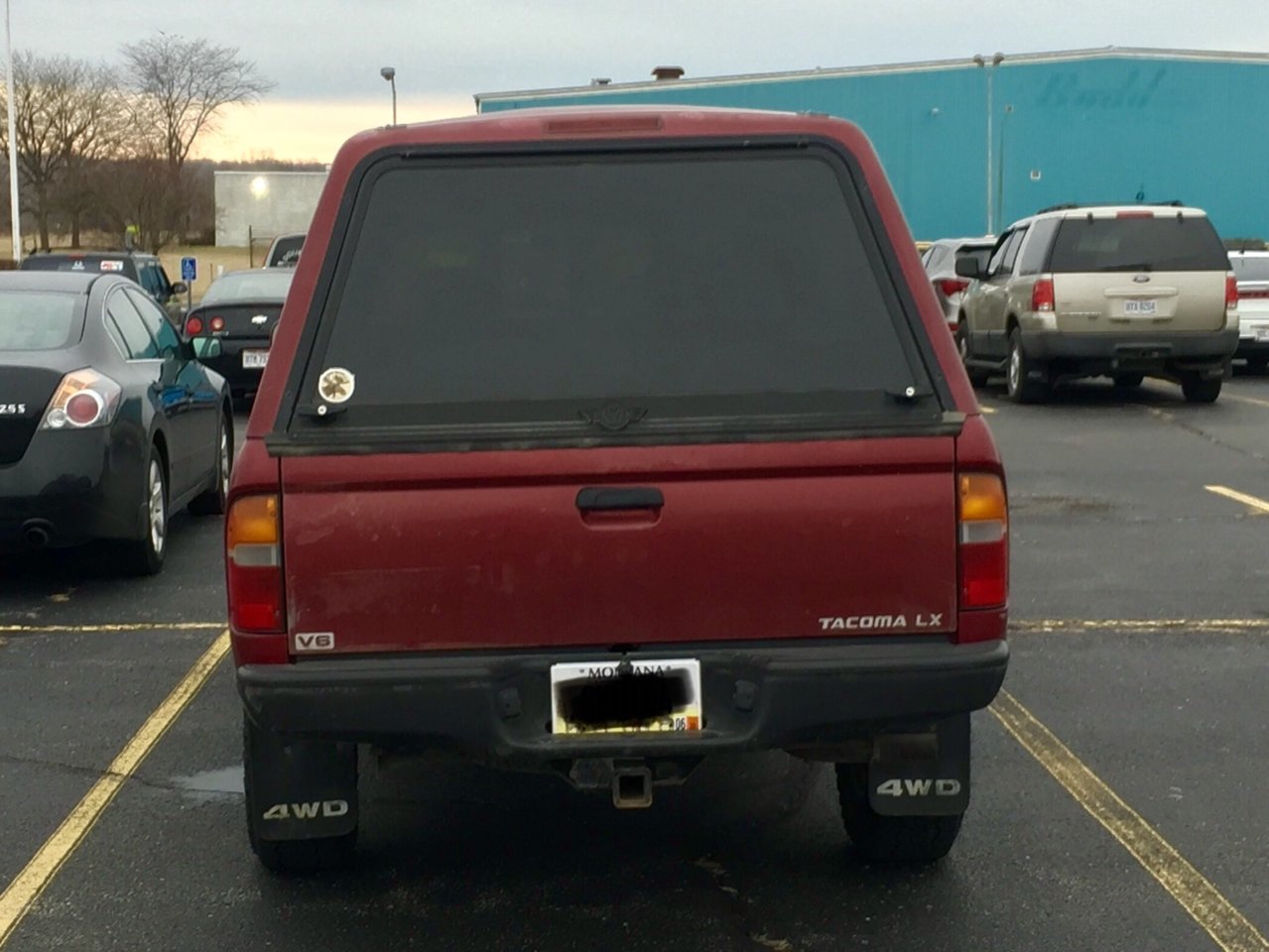

    Following up after 10,000 miles on the springs. I must’ve received the Extra Lean model, as they’re already sagging hard and the lean is super apparent. The smile shape of the spring has turned into the wavy flat grimace.
    I’d likely not buy the SD from General Springs again.
    This is under the weight of a fiberglass topper and the equivalent to a little less than a sheet of 3/4” OSB used for my sleeping platform.
    I know it’s been said before, but could someone PLEASE make a good stock height spring? Pretty please!?
