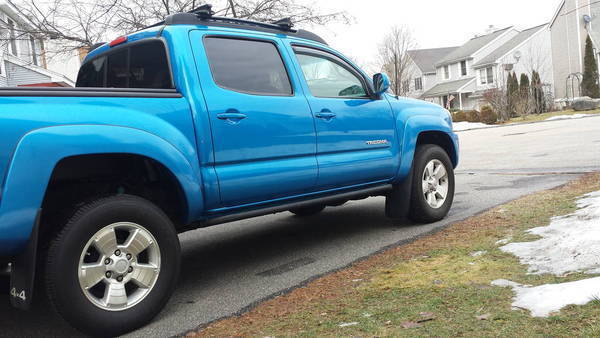

    Here's a side shot. Weird angle but you can see the rake in it. This was a week or so ago. They've come down a little more.

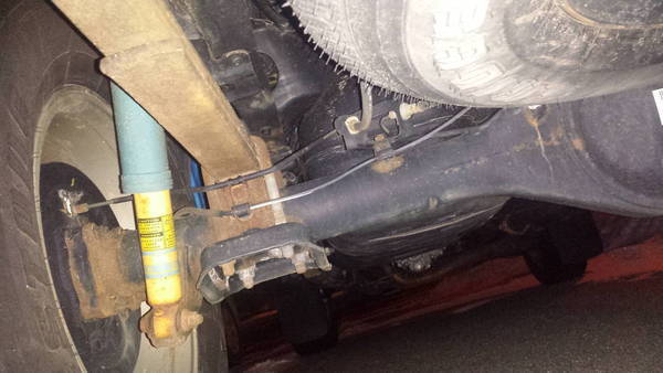

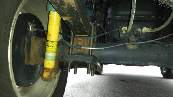

    Here's a cpl under body shots right at the rear left [stock] shock
    Before:
    After: taken as soon as I got home from install (approx 2-3 hrs after they were put on)
    As you can see in after photo, the height difference in the shocks from the sticker to the blue shield on the top portion of the shock. I didn't measure before install from top of tires to bottom of rear fender. Dunno if using shock is right way to measure but as I said they've come down about an inch more from the after picture here. I'll post another 'shock shot' later (taken today, 2 weeks after install).
