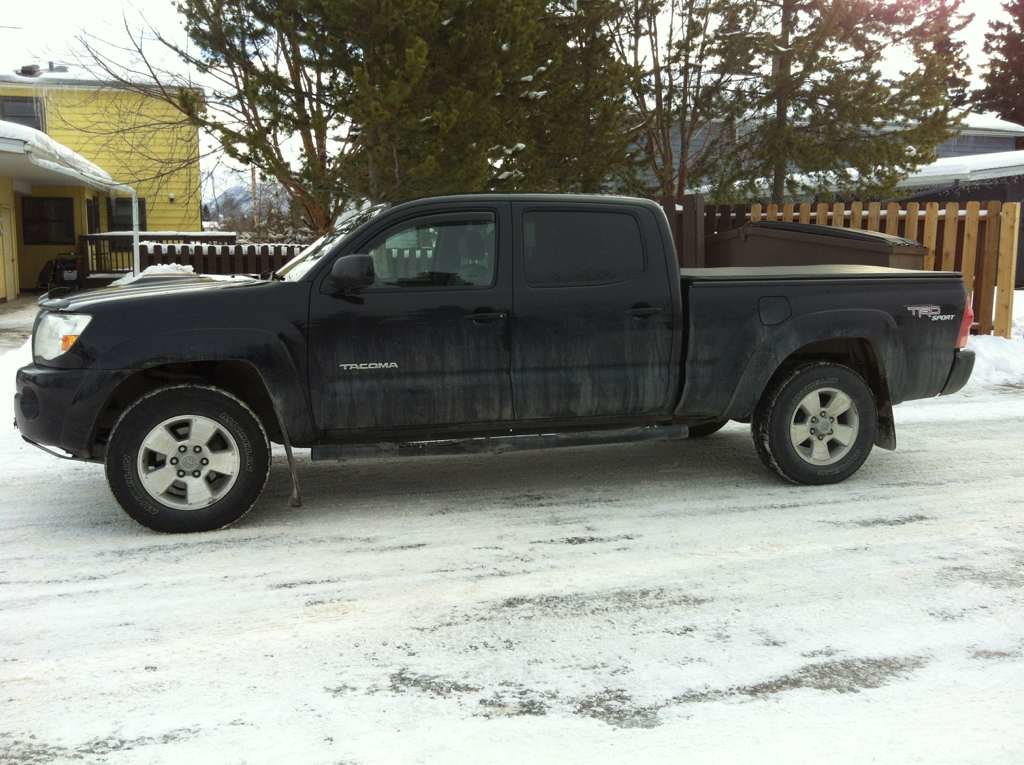

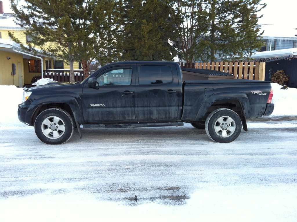

    I'm pretty happy w/them so far Jay09. If you're worried about the height, get the 3 leaf version. I haul shit from time to time. I mentioned before but I had the u bolts custom made at a spring shop for $50. As you can see from the pics they're a little longer but the bolts as well as the nuts are much better quality over the stocks as well. Shop thru them on for $120. So I'm in for $610. Completely ok w/that. One year warranty on the packs.

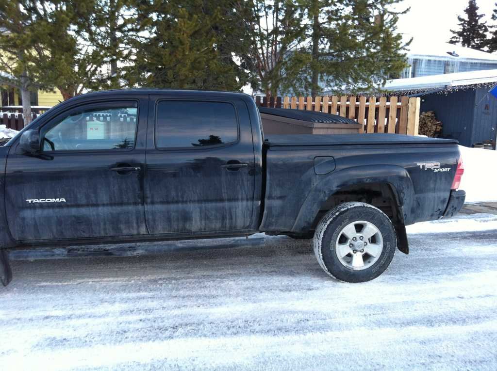

    Fold-a-Cover G4 Elite, Light bar (X3 Hella), Thule/OEM RR, Avid OR BO Sliders, TRS Projector HL (BHLM), 5100s F/Rear @ 1.75
    Pic today, two weeks after install:

    Thanks for the pics! It looks to me like there wasn't that much of a drop after 2 wks. I am so on the fence about this option (actually leaning against it). It looks like a significant raise in the rear-end AND as a previous post of mine described...that General spring told me it would only give me about a 15-20% increase in my load carrying capacity over my stock (2014) springs. I'm leaning toward Timbrens. Cheaper...no lift...there when I need them (under load)...not doing anything when I don't need them. Probably works best for me cause my stock springs are in "new" condition AND I don't haul heavy loads regularly. I suppose this is a good option for you guys who have had OEM spring failure.

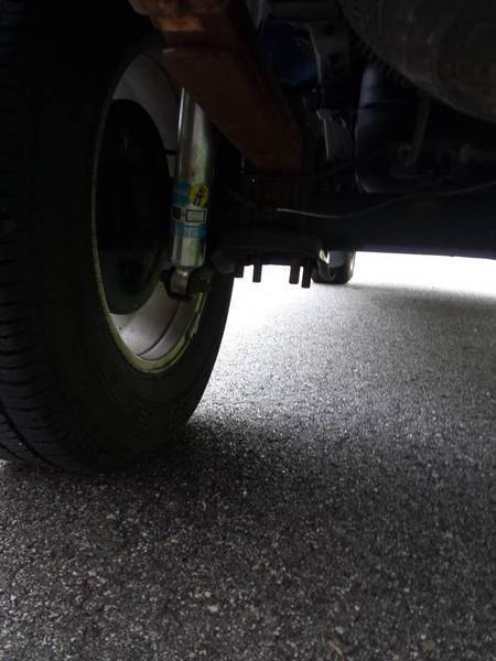

    Another update to old thread:
    Had 5100s installed. Springs are holding up great. Pic is a little dark but these seem to pair better w these packs than stock.

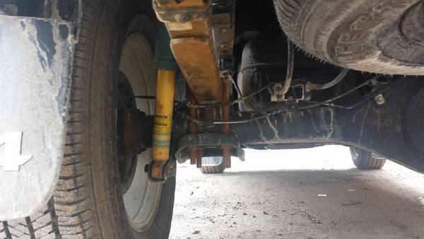

    All, I replaced my springs a couple weeks ago and it was a cinch, had it done in 3hrs. Got the springs from SD truck springs along with the U-bolts(460$ shipped with U-bolts). They called out 7" length U-bolts but 6" would work as well.
    A couple notes on the install:
    1. Definitely get new U-bolts, being able to cut the old ones off makes it a super easy job.
    2. Clean out the areas where the springs mount to the body prior to installing the new ones, makes the install much quicker.
    3. Re torque the U-bolt nuts after a couple days of driving as things on my truck seemed to settle in.
    The ride quality is much better now and with 5100's on all four corners(front set at 1.75" of lift), the truck as a slight rake but levels out nicely with my dirtbike in the back or with the trailer hooked up.
