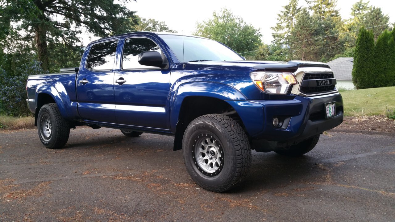

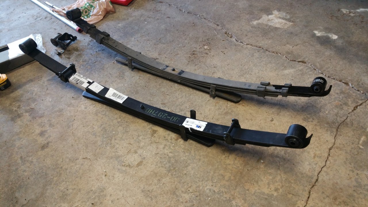

  18. Jun 5, 2018 at 11:33 AM
    #78
    tacomavan
    tacomavan Well-Known Member
    Dec 14, 2017
    #238463
    500
    Oregon
    i installed the 4(3/1) 90-297HD yesterday. Picked up 2.5", i expect some settling from what i've read, currently have a bit of rake which i dont mind. (pic is deceiving, driveway slopes down), plus i have a spacer up front.
    ride good so far, better than stock, which on my truck would be best described as "sloppy", so it tightened up the rear. Plan to do 6112/5160's eventually
    install was pretty straightforward, front leaf spring to frame nut was a bit of a PITA but eventually it gave up. Also ordered new u-bolts from GS

  20. Aug 30, 2018 at 4:03 PM
    #80
    tacomavan
    Dec 14, 2017
    #238463
    500
    Oregon
    pic is with a 1" spacer. But i ended up buying 6112's, put them on #3 setting. Waiting for some time to install them. Already put 5160's on the rear
