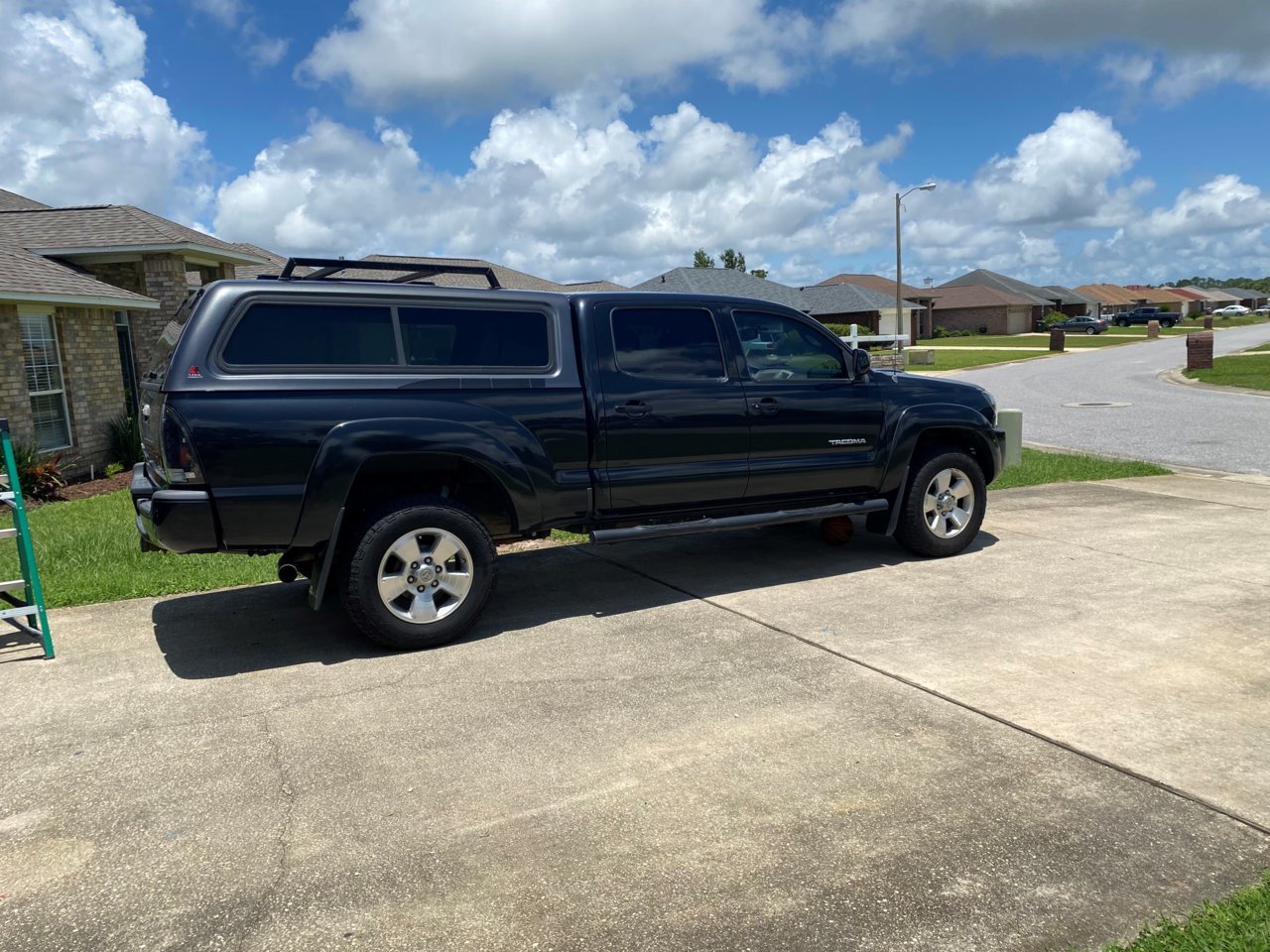

    So here's the numbers 8 years later:
    From 2013:
    FL 20 1/4" FR 20 3/8" RL 23 1/2" RR 24"
    From Today:
    FL 19 7/8" FR 20 5/8" RL 23 1/4" RR 23 7/8"
    I will add that I recently added a shell. I am a bit concerned as the the amount of difference between the fronts. Guess it's time install the taco lean spacer which has been sitting in the garage for a year now.

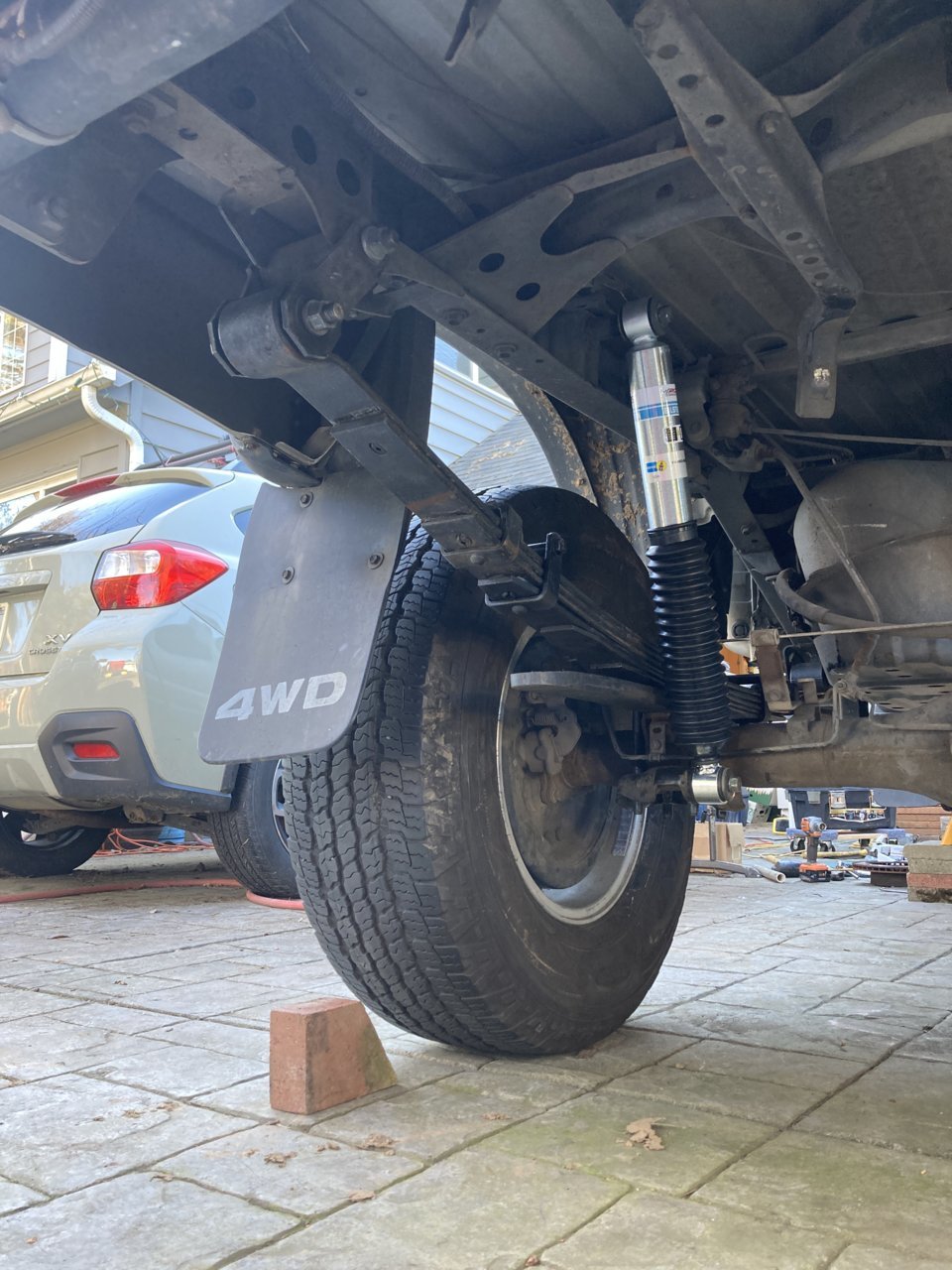

    Ive installed these HD springs recently on my first gen tacoma and I bought the 4600 Bilstein thinking this would not add height. Basically restore to stock height. Should I cancel the 4600 shocks and get the 5100's shocks?
    The driver side from the stock plastic fender guard to the center of the hub is about 23 1/4" and the passenger is 23.5" if that helps.

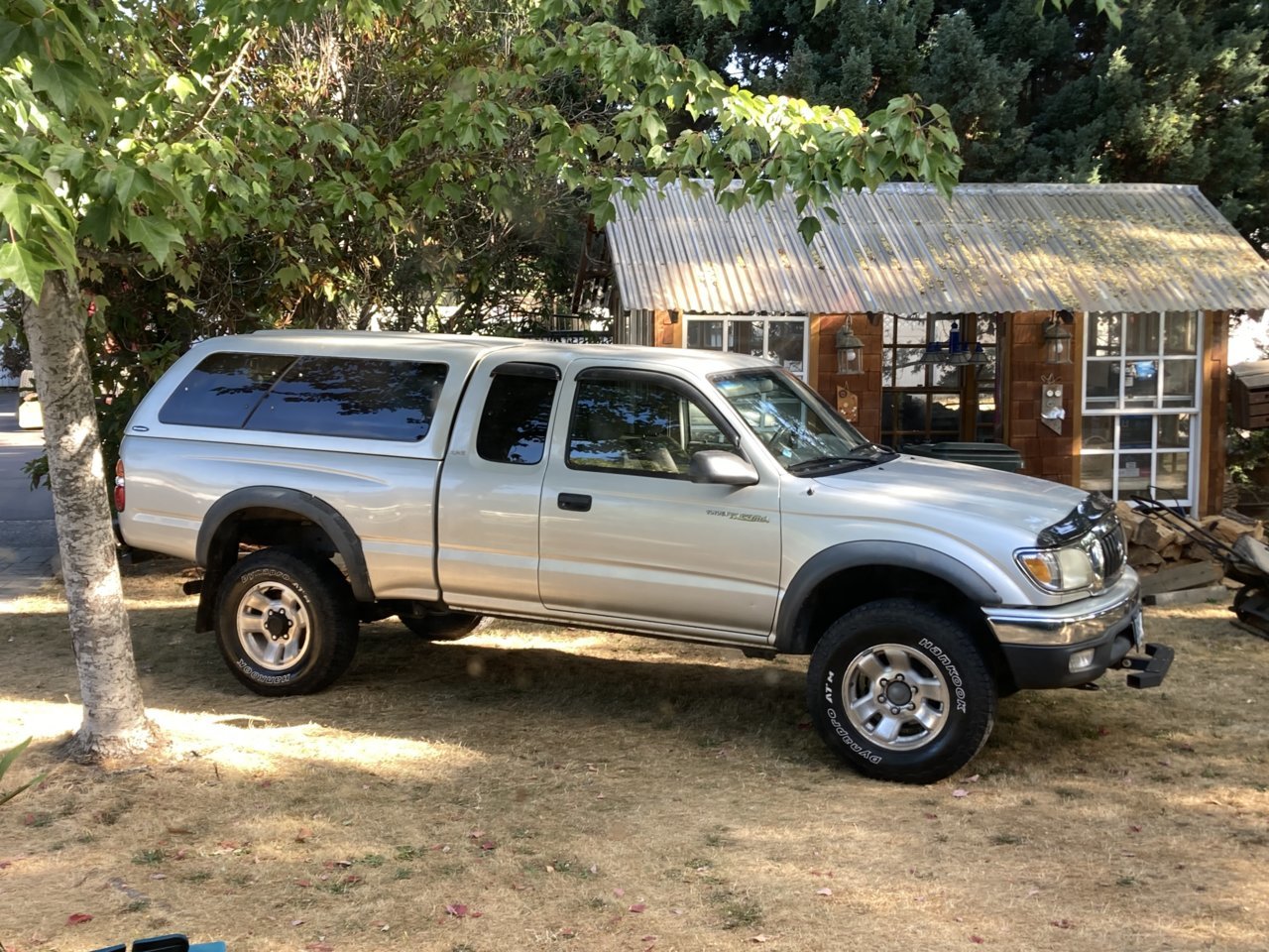

    3" Lift w/ 5100's and EMU 882 springs , General Leaf Spring and AAL in rear with 5100. Diff drop, carrier drop, 3 degee axle shims. Trail Gear Tube Bumper. Tundra brake mod.
    I towed a few utility trailers before I put the AAL on there with my overload springs staying on there. The trailers were 3K to 4k lbs and no issues. The photo is after the AAL was installed. Those are the General Spring HD's however.
