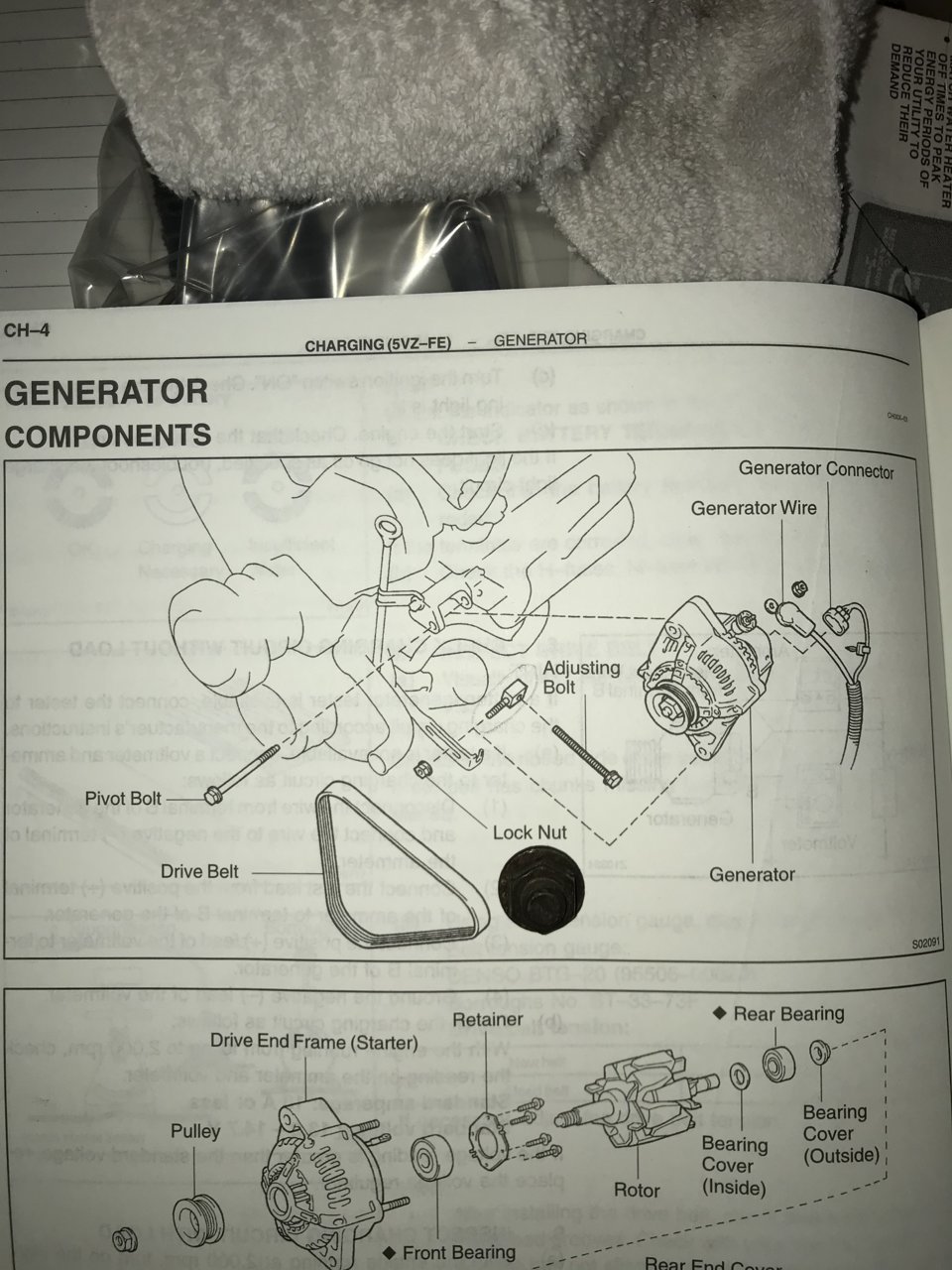

    What’s up Tacoma world. Long time stalker, first time poster. Looking to see if anyone can help me out with a part number since the dealership parts dept was ZERO help and can’t seem to find it online.
    backstory... did a timing belt job and was rechecking torque on the accessory belts after my test drive. I was torquing down the adjusting locknut for the alternator to 25ftlb and the bolt that connects the adjusting bolt to the lock nut snapped. Looking to replace the circled bolt in the picture.
    thanks in advance

    Thanks for the replies boys. Unfortunately, the 2RZ/3RZ alternator bolts up the motor differently than the 5VZ Alternator. The bolt I need looks like a square with a drilled out section tapped so that the long alternator adjusting bolt screws through it. Welded on to that square is a stud that that goes through the bracket on the motor and attaches to a locknut to keep the adjusting bolt from shifting around.

    Mystery solved and posting for anyone who might have this problem. After hours looking over drawings found the piece I needed in the fan section. No help from the parts counter jockeys at the dealership.
    If you need the long bolt to adjust.
    90119-08493 = Long tensioner Bolt
    Thanks for the help guys!
