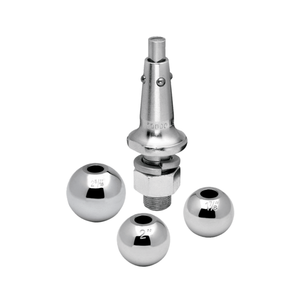

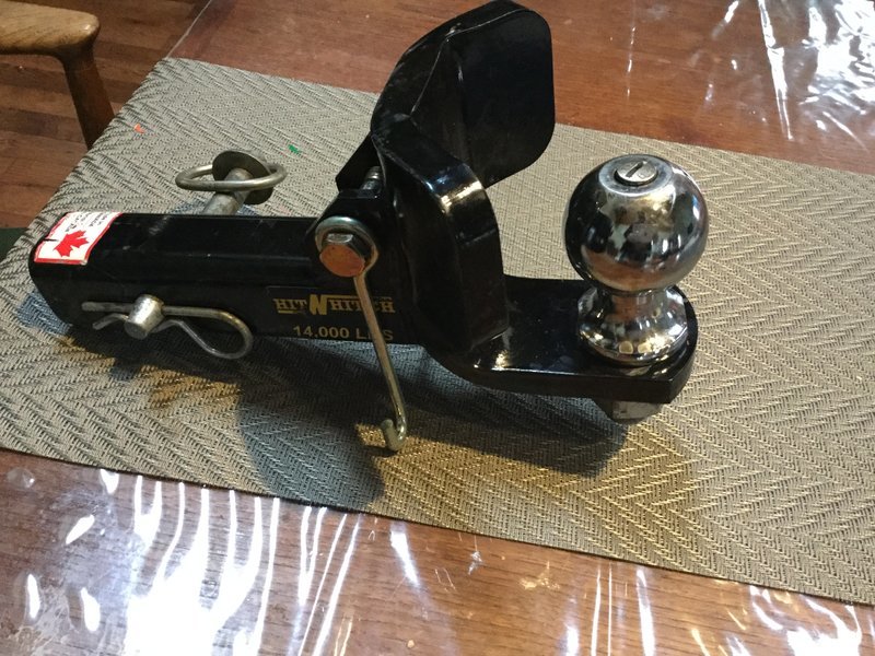

    Reese tow ready interchangable ball system. Makes ball changes about 15 seconds or less. Push in the top pin to push the balls outward to lock ball in place. Then turn 1/4 turn to lock the pin. Removal the reverse. Been using them for 15 years or so and only had one issue. I had no need to change balls and never needed to change tongues for a long while. Balls rusted into place and wouldn't remove. So I now grease them and use a ball cover when not in use and remove the tongue when nessecary. I have about 6 tongues in different heights and 3 have this system including my Kubota. I would never go back to stationary single ball setups. I have considered the tongue in post #4 but all of my trailers are the same height and only the tow vehicle height has changed over the years so if anything I move the adapt a ball to a different tongue and leave it there until my next vehicle change. My flatbed and my enclosed have different ball sizes.
    Attached to my latest tongue with guard to prevent hitting your bumper. Also has safety chain hooks to keep them from dragging.
