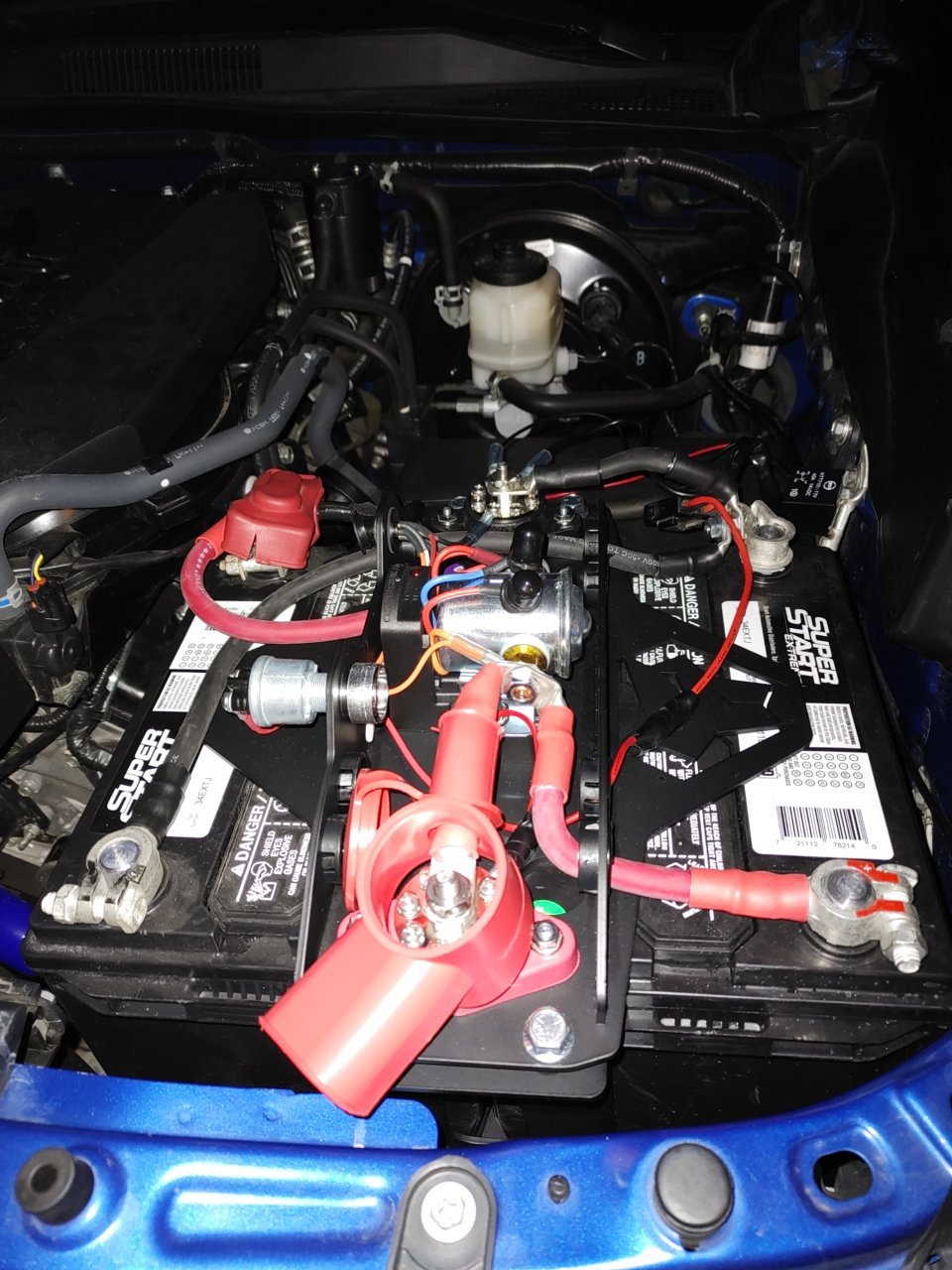

    I just installed my genesis battery, firstly I will say as far as installs go I would rather do this over installing the prinsu rack on my access cab 4 times before doing the rack again. The video, and the pdf file make it fairly dummy proof. That being said alot of what I've read regarding this particular install is with the shifting and added weight all cordinated in one spot the sheet metal will habe a tendency to start cracking, especially if you're going hard. Luckily for me, although i may love hitting a hard trail, and seeing how much sheet I can get into this Taco is also my daily driver, and will have to last me for the next 5 years because i promised my wife when I bought it that i'll keep it for a while. So I reinforced the area and gave the tray the batteries sir in with some 1/4 thick flex seal tape (I figured a little cusion, and not metal on metal contact may help secure it even if just for my own piece of mind). Now, I have no intentions to hit those rediculous rough trails and see how far i can push it, so i can't speak for you avid 4x4s but my hope (knock on wood) is that i wont have as serious of a cracking issue as some people have unfortunately had. As far as the oil neck I guess I was one of the lucky individuals who even though this is the first year for the 3rd gen installs my oil neck was secured with a bracket and screws and not just glued on. Just by switching the next 180° it gave me more than enough room for the tray and both batteries, with zero fear of having the battery break the oil neck off. So in reality all in all my only complaint is that it's difficult for me to remove my fuse box, and hopefully in time with the little precautions I took for padding and a little more stability I wont suffer from cracks in my battery compartment.
    So in the end I would say for time convenience of the install, not to mention the price is cheaper than some of the other options, for those who aren't going to be putting a ton of force and riding hard and just looking for extra reassurance when taking the family on an overlanding adventure I would highly reccomend this sut up..... Also, get a rivet gun will make the process that much eaiser.
