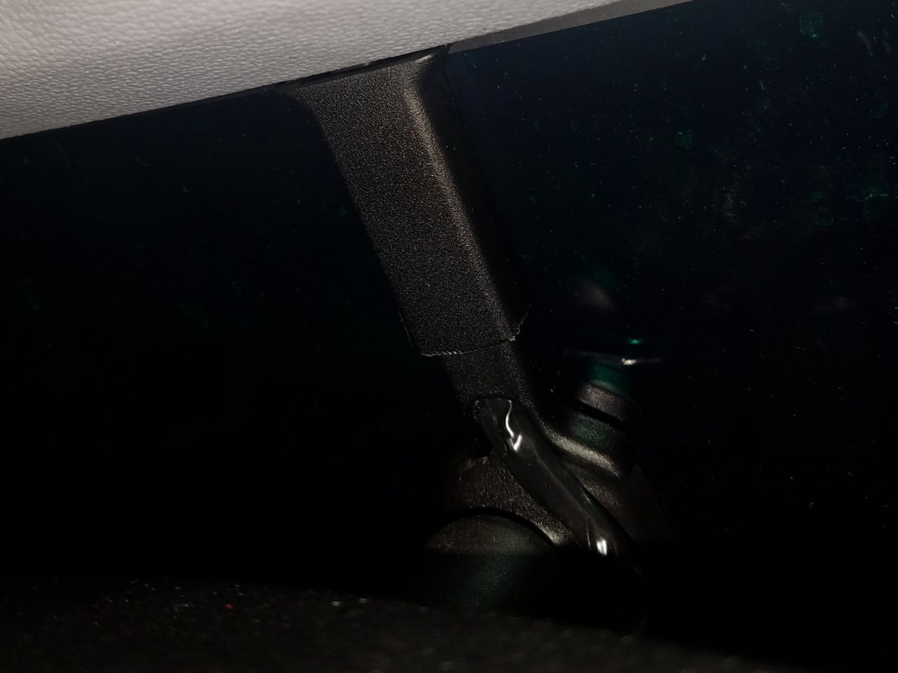

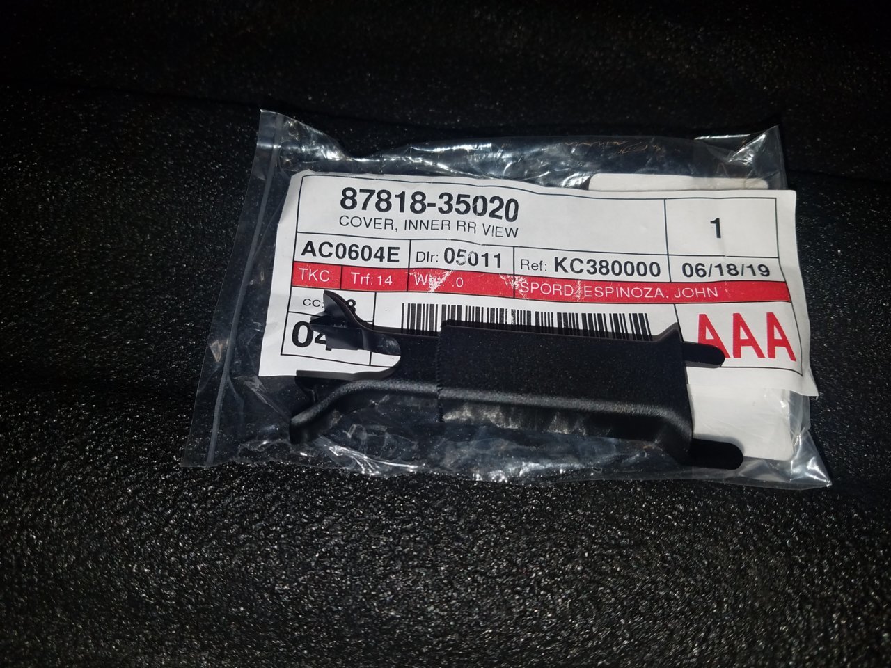

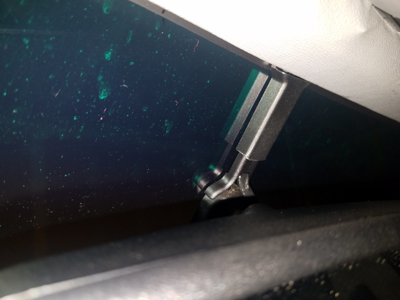

    I stumbled across the perfect wire cover for this swap.
    The one I had before was big and fat, didn’t have the OEM look or fit.
    The 2017 4runner Gentex wire mirror cover is flat and smaller and fits great.
    I did have to cut 1/2” or so off both inside ends because my mirror is higher on the windshield.

    Yes but Dealer price was 5.00 new and this one fits perfectly with a few cuts
    and no guessing on the part

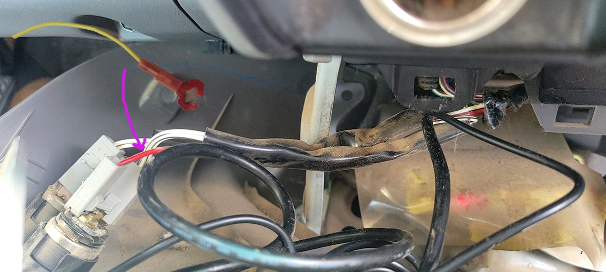

    Hey there to the OP or whom ever has done this mod. I'm trying to get this done this week. Only thing that's stopping me is the splice into the cigarettes power/ACC. I have everything to splice it, but wondering if a fuse tap would be a better choice?
    I'm assuming you spliced/connected the orange and the black/red Gentex harness wires to the red cigarette power wire?
    Uploaded is a photo showing how I was planning on doing it. Thanks! (and yeah, I plan on cleaning lol)splice.jpg

    That worked just fine for me!

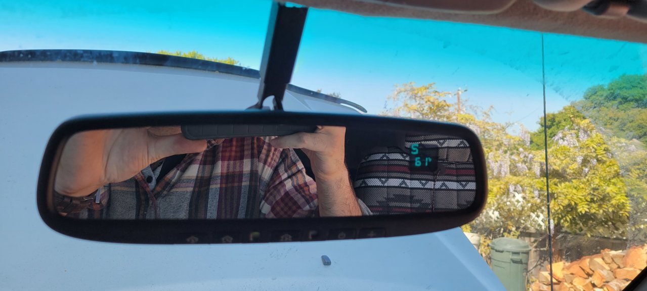

    So I will say, now that I've been riding w/ the new mirror for some months.
    A WARNING
    If you're a tall guy like me (6'3") this will create a bit of a blind spot for you, especially when making right turns on narrow roads/trails and blind corners. I've almost t-boned the car to my right at 4-way stops cause their car was the exact size of my mirror from my view.
    When I get some time off I'm going to see if I can weld up an attachment that puts the new mirror back on the original mount underneath the dome light cap, which will remedy the issue..
