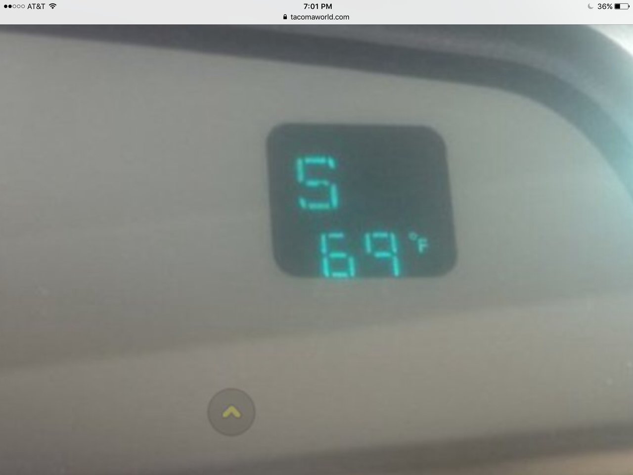

    Any of you Guys ever install an auto dimming rear view mirror with compass and temp display in your Tacoma?
    I have one, but have seen that some might come with an Amber display. Most come with a blue/green display.

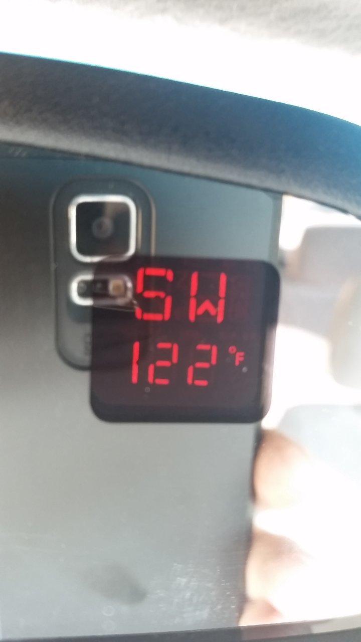

    I have and I changed the color to amber. Let me get pics of what I used.

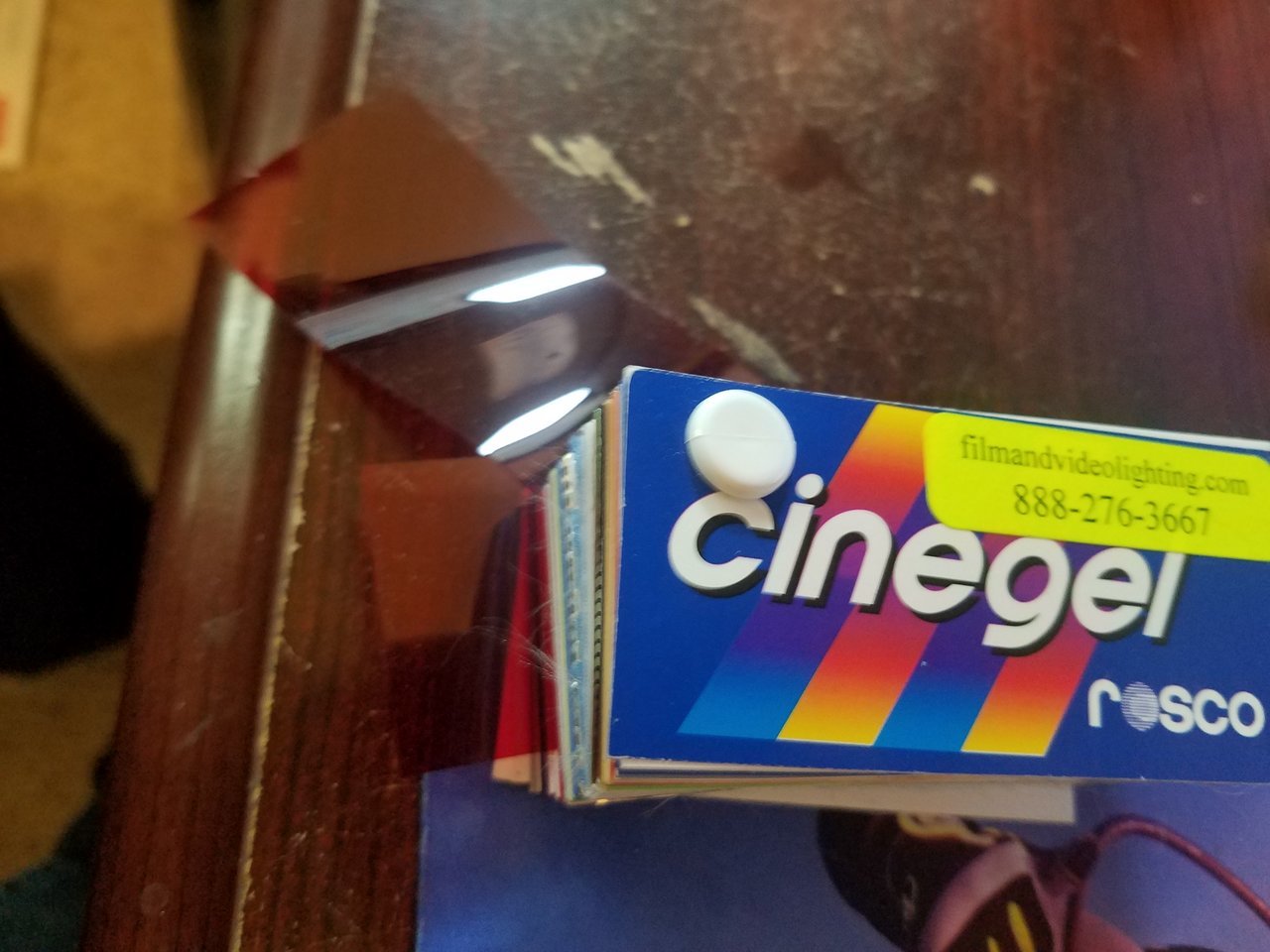

    Here's what i used. I'll send you some if you want. It's blue green underneath. 20170619_162731.jpg

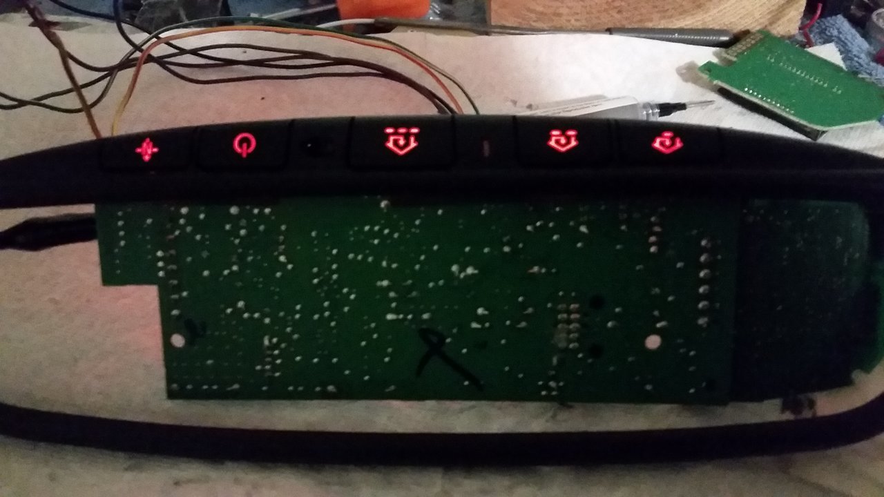

    20170513_230815.jpg LOL Thx. Ya I glued it to the windshield. This colored film is a sample pack I bought off Amazon. There for video lighting. I'll throw some in an envelope and mail it to you if you want. The mirrors are tricky to get apart. I also changed the led's for the buttons to red.

    PM me your address. I used a dab of silicone on each edge of the filter to hold in place. I'll post a few pics of the clips that hold it together. I have extra red SMD LED's also if you want a few.

    I'm using a Gentex (gntx-177) mirror, with two line LCD display like posted above. You can get it in single line, but unless you only want compass, or Temp (if equipped) two line is the way to go.
    The 177 only needs 2 wires (power and ground) for compass and auto dimming. And if the mirror is capable of displaying temp (has temp button instead of mirror) you need 4 wires (power, ground, temp sensor+ and temp sensor -.
