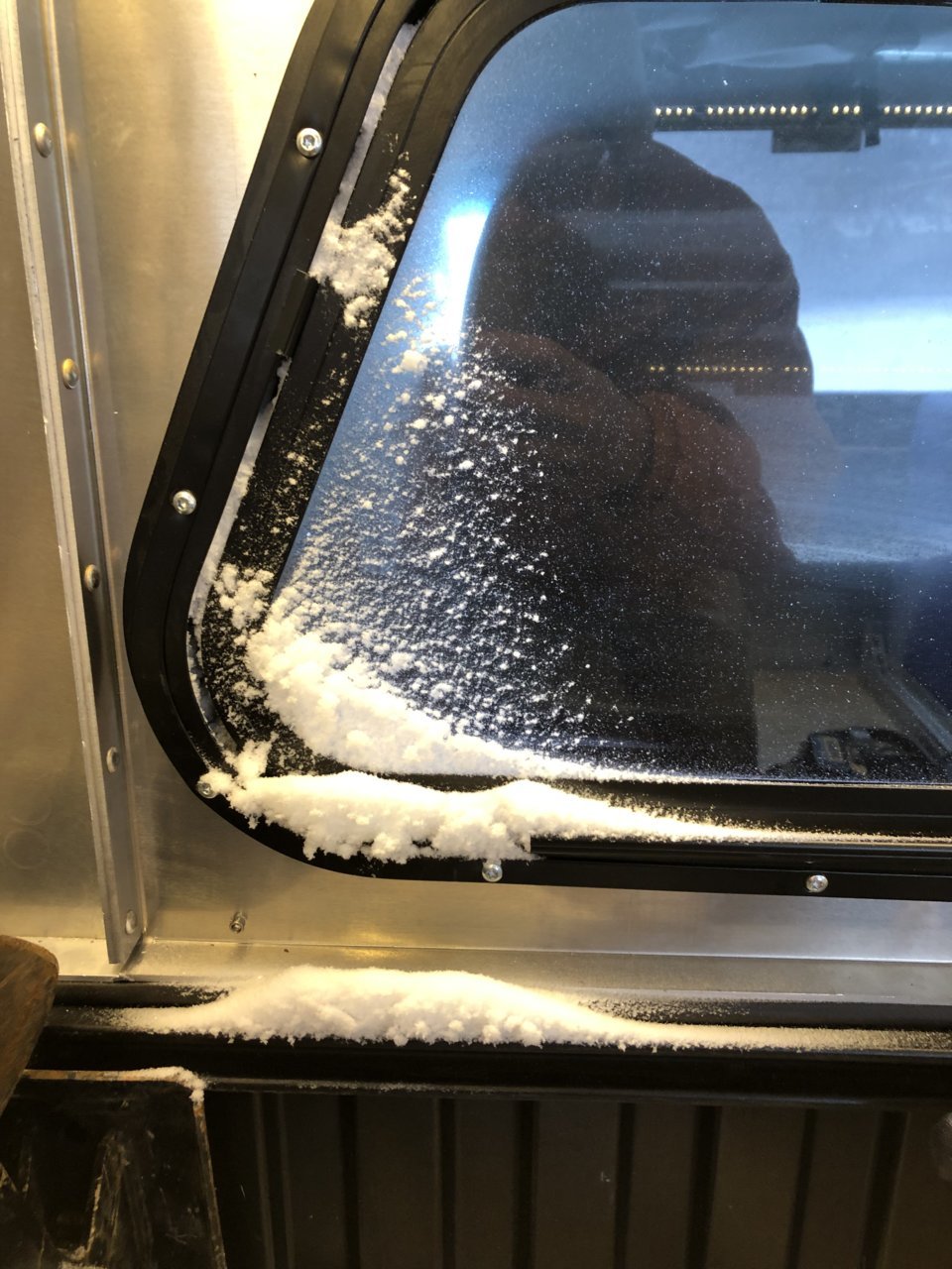

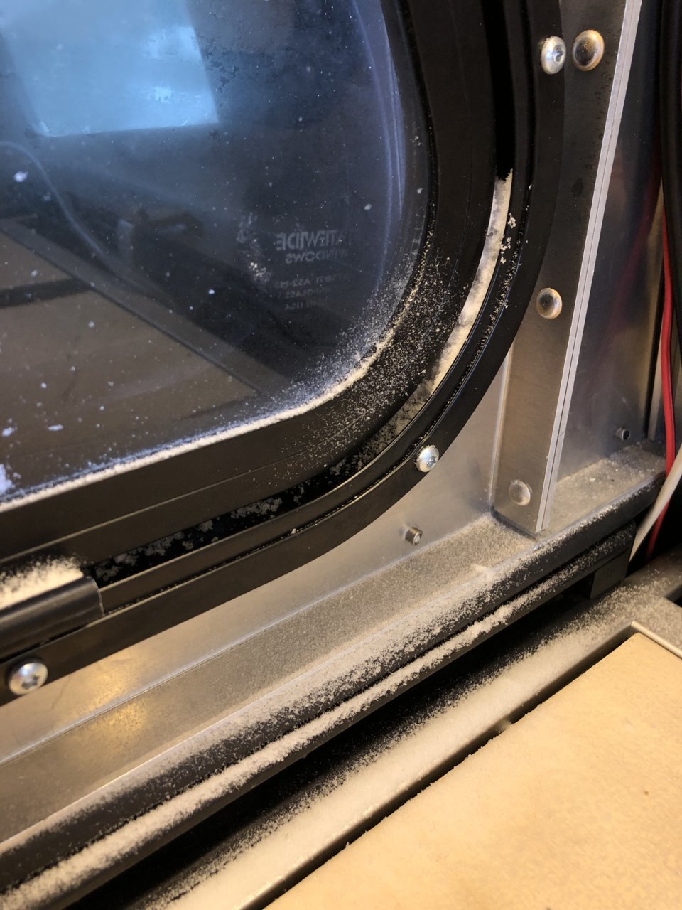

    Had a pretty good blizzard with cross-wind and the tip down window seal showed its colors.
    Given how well the side doors are sealed, the seal at the front was disappointing. I replaced it with some thicker bulb seal and it seals snugly now.

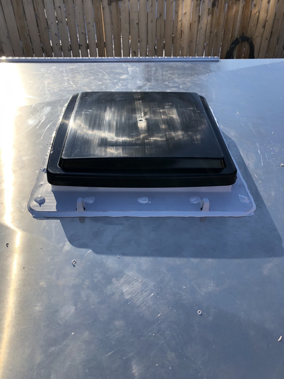

    Cut a hole in the roof. When I ordered the Drifter, I didn’t understand that they have a wind deflector and extra bracing installed if the fan is ordered. As a consequence, I wanted a different fan than they supply and chose to do my own. Knowing what I know now, I’d have Vagabond do this instead of DIY. I installed the Maxxair Maxxfan mini. It has twin supports and locks closed. Only exhausts though.

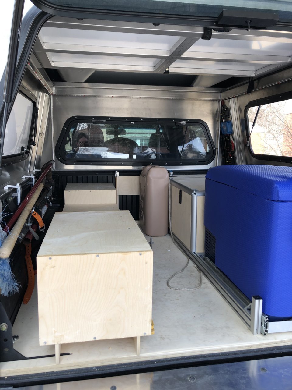

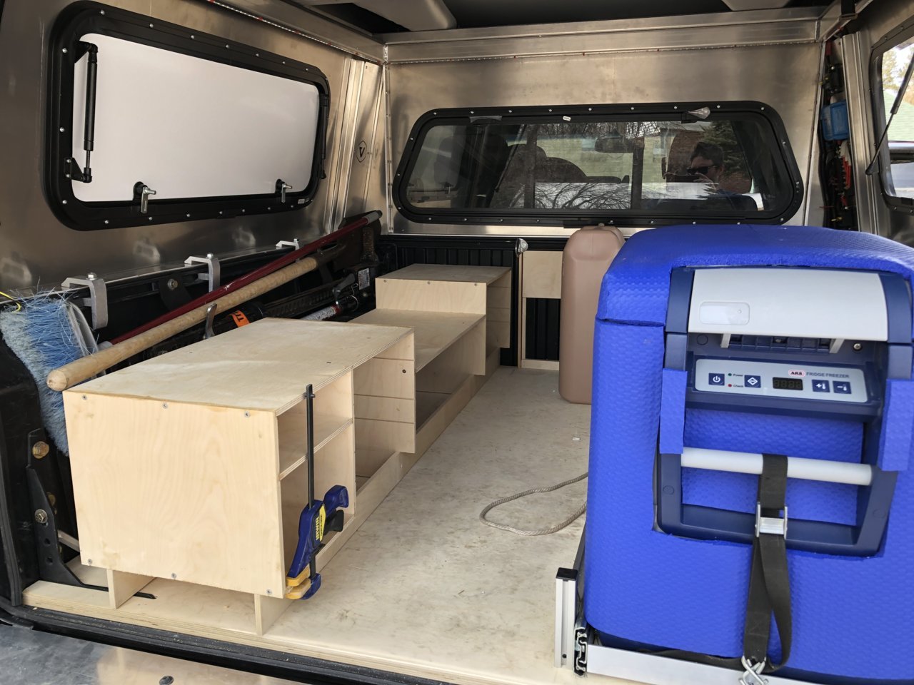

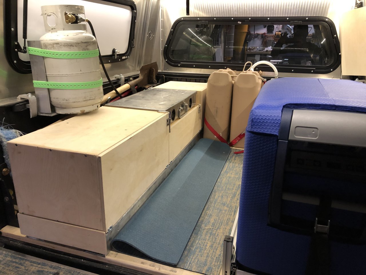

    I put closed cell foam over the cooler, because it was free and I figured it couldn’t hurt.
    Water tank and kitchen mock-up:

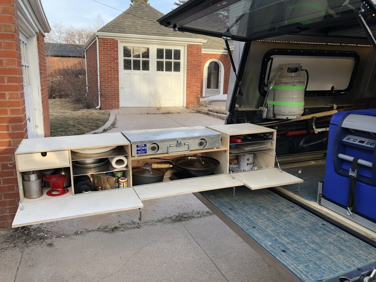

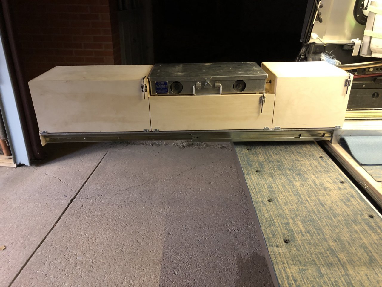

    Kitchen box on slide out. Also, I cut up yoga mats for tailgate padding.

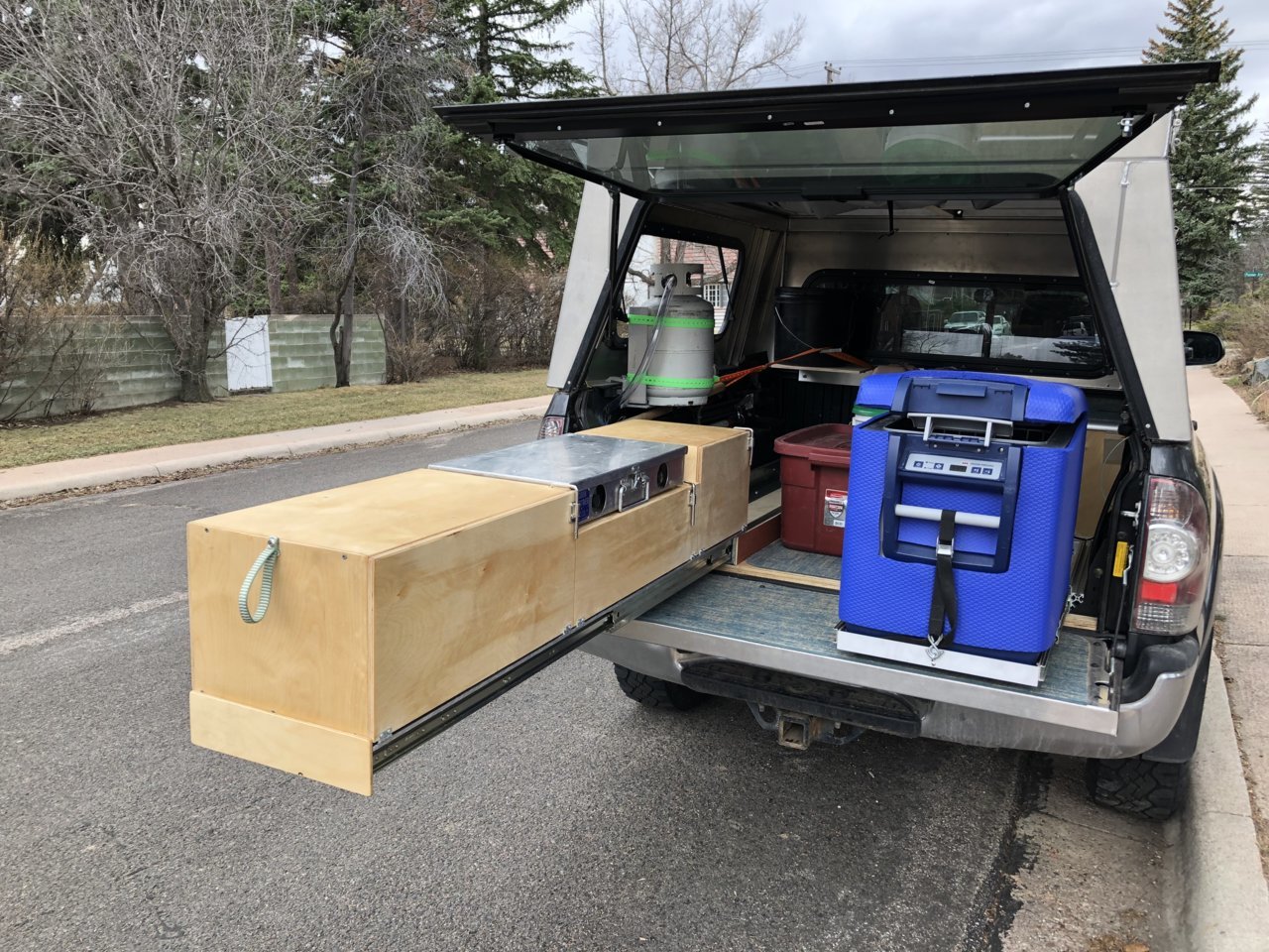

    Still a ton of cleanup, but campable!

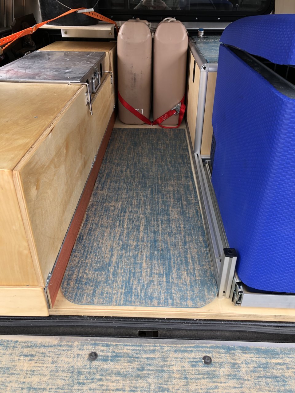

    Finally sanded the kitchen box and wiped some finish on.
    Cut the”rug” and put a cover plate on the aluminum angle which supports the drawer slides.
