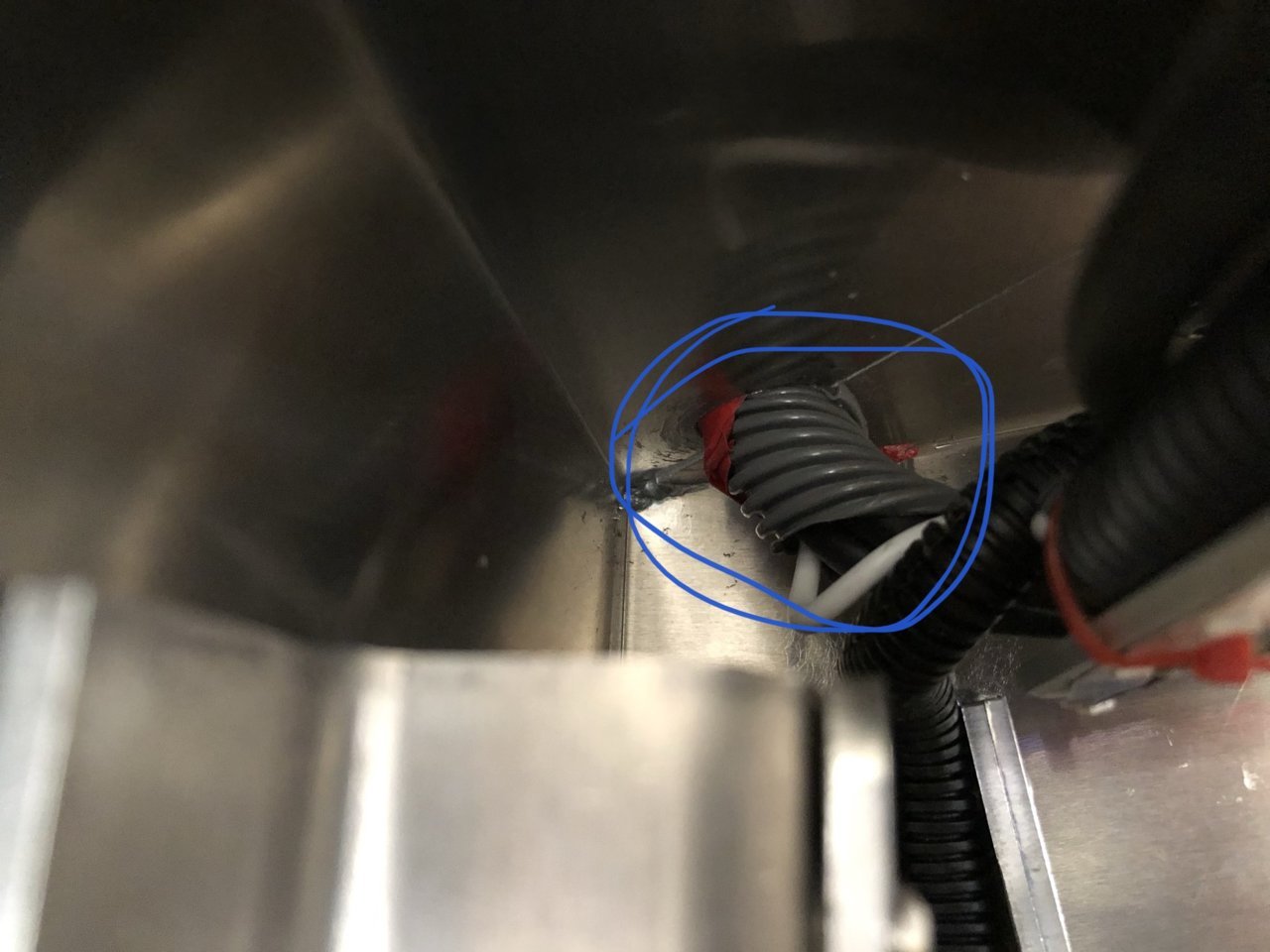

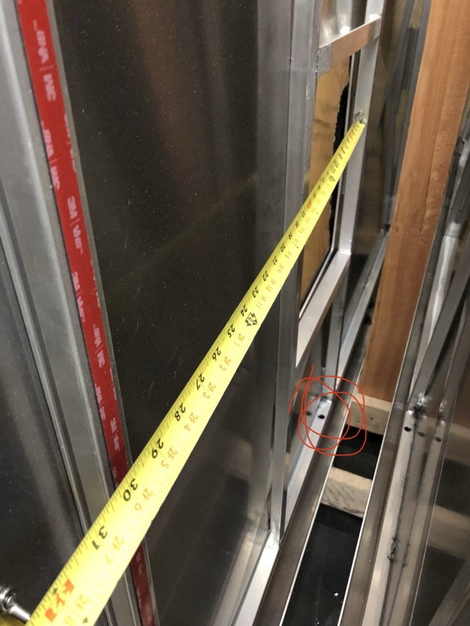

    ok, here goes. On my camper, and on at least a few others, there is an access hole that provides access to the structure tubing. See red circled area below and tape measure for distance reference. I’ve been reluctant to post this picture, because it was information I obtained in the shop when I picked up the Drifter. I do not know if all Drifters look like this on the inside (fair warning!)!

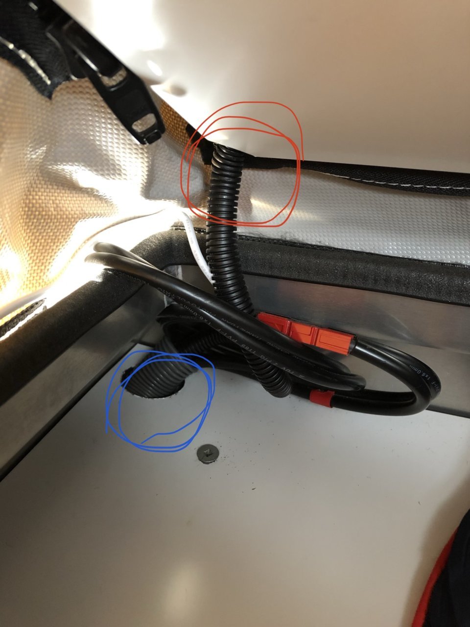

    I fished to that hole and then forward to the front, driver’s corner of the wedge. See red circled area below. Crawl up there and feel around - it will make sense. From there I ran it in a channel under the sleeping platform (starting in the blue circled area below). You might need to remove the top layer of the sleeping platform, depending on if anything else already uses this area. I had it apart to run some lights and solar wires too.
    This channel is open (or you make it open by removing insulation), underneath the sleeping platform all the way back to the driver’s front corner of the “Drifter cabin” area. See blue circled area below. Once again, investigate for yourself!

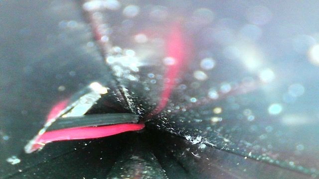

    Very helpful... I pulled out the WiFi boroscope...
    verified the hole is there on #11. It is about 15.5” from the rear edge of the roof insulation panel.

    good verification. It makes sense that you have the hole, since you have a factory light. And a good reminder that things can be slightly different over time. My access hole was about a foot forward of yours.
