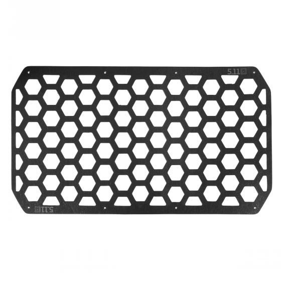

    The one I am designing works like this for the 3rd gen. Probably would work for the 2nd gen too. Can’t remember how my backseats laid down.
    Anyway, you lay your rear seats down.
    The panel utilizes the headrest holes in the tops of the rear seats in their folded position. Keeping the panel upright by pins at the bottom of the dog barrier, that slide into the headrest holes.
    You then use two cinch straps to hold the tops of the corner of the panels to the Oh-Shit handles in the back.
    This would have the panel go straight across the back of the front seats and held into place.
    Preferably this would be made out of one sheet of Aluminum, that would have hexagonal holes spaced evenly apart from one another. Making a Molle rack that you can easily see through.
    So I am thinking of something like this scaled up.
    The top corners would dive in more at an angle to match the roof line.

    I really like that design. If I had a winch, I'd say yes. I think you'll get a decent amount of interest from the larger Toyota community though.
    I plan to get a winch eventually, but I'm nowhere near there yet. So my input is essentially worthless.

    Your input is not worthless! Any feedback can be helpful.
    I agree with you both, but we'll see what kind of attention the post on the 2nd gen BST gets and go from there.

    The only caveat I'm thinking about right now is that my waterjet is probably not big enough to cut a piece of alum long enough to fit in the width of the cab. It would have to be a two piece design with my machines, more than likely. Idea is solid, aside from the possible size constraint, it would be fairly straight forward to produce. Would need cab measurements from you and headrest position measurements.

    Sweet. How wide does the table except.

    4'7" if im not mistaken
