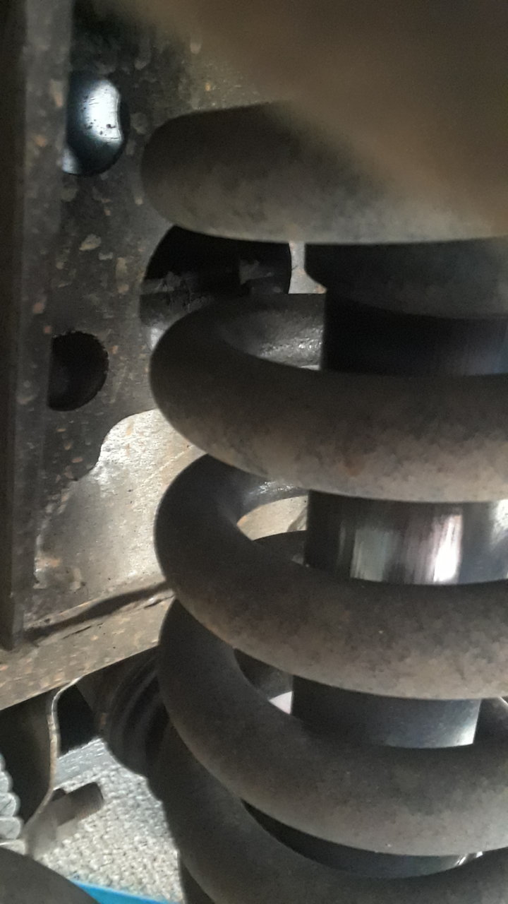

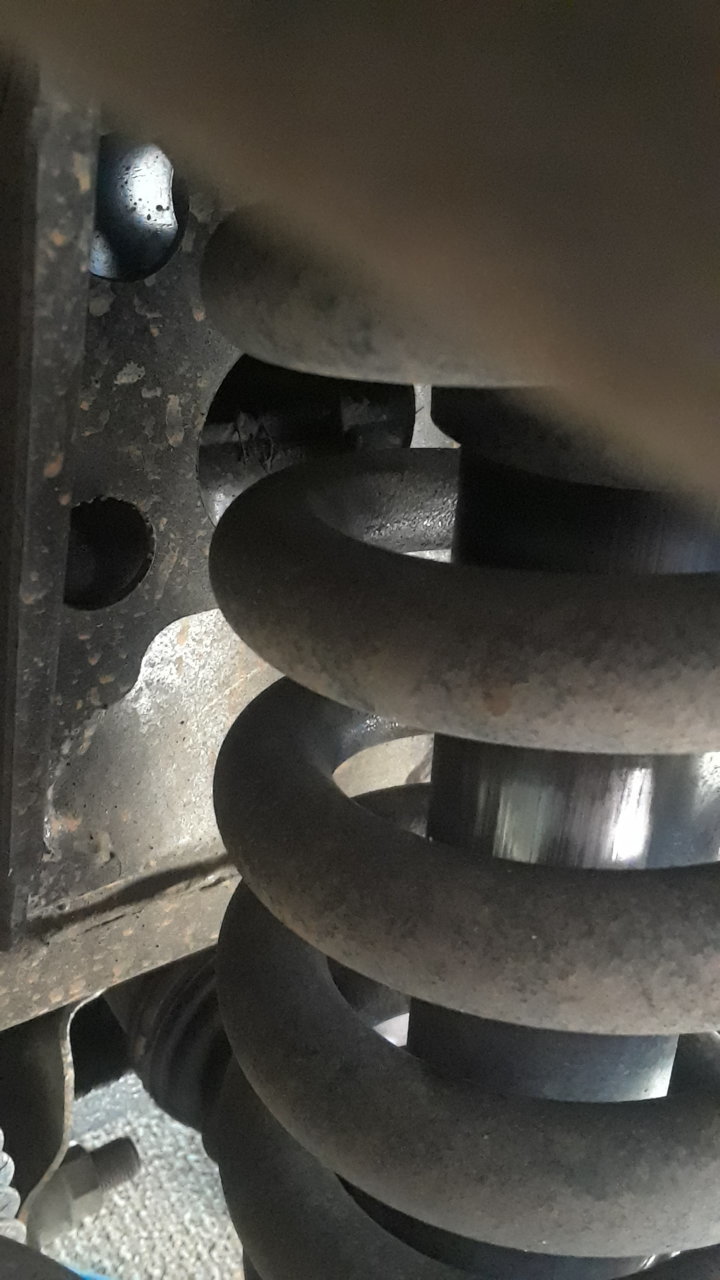

    I’ve got some crazy squeaking goin on front driver’s side. I’m hoping it’s the torn boots, I can’t find the source of the squeak to save my life!

    I'm not much help. In fact mine doesn't squeak, but... look at the shock behind the spring. Mine shows signs of rubbing. No explanation of how THAT happened!

    @cubie One way to find the source is to literally spray each bushing, one at a time; driving the truck in between each part sprayed….thus pin pointing the source.

    Most likely, the squeak is caused by dirt in a joint - dirt that entered the joint through the tear.
    But, I assume you know that.
    I have a squeak in my rear leaf springs. I need to pull them off the truck, and clean and lube them. Not a job I am looking forward too...
