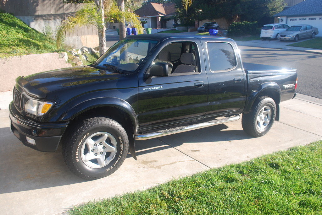

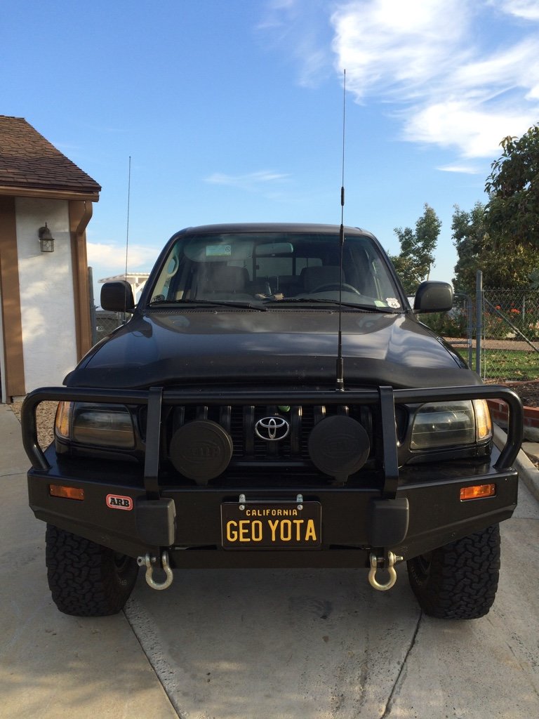

    Our 2003 DC 4x4 Tacoma...stock...bought with 165,455 miles:
    How the truck sits as of 11/11/2015
    As of 12/2016, Palm Canyon Visitors Center
    Mod List as of 5/19/16

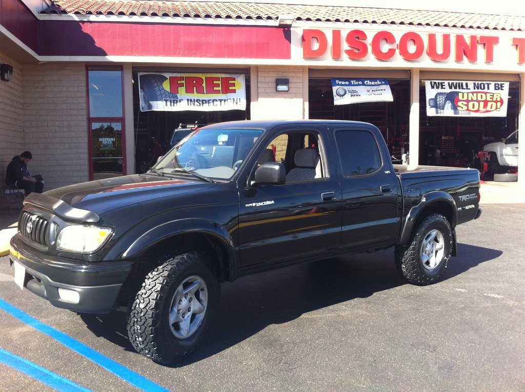

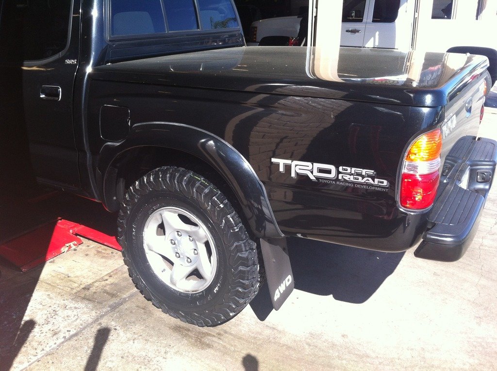

    New BFG A/T KO2's installed at 165,588 miles:
    Love these kicks...

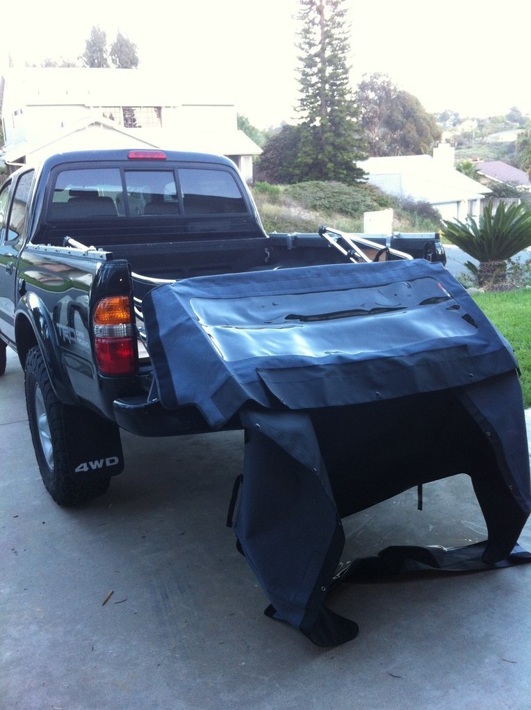

    Celebrated 166,000 miles with another mod...Softopper install:

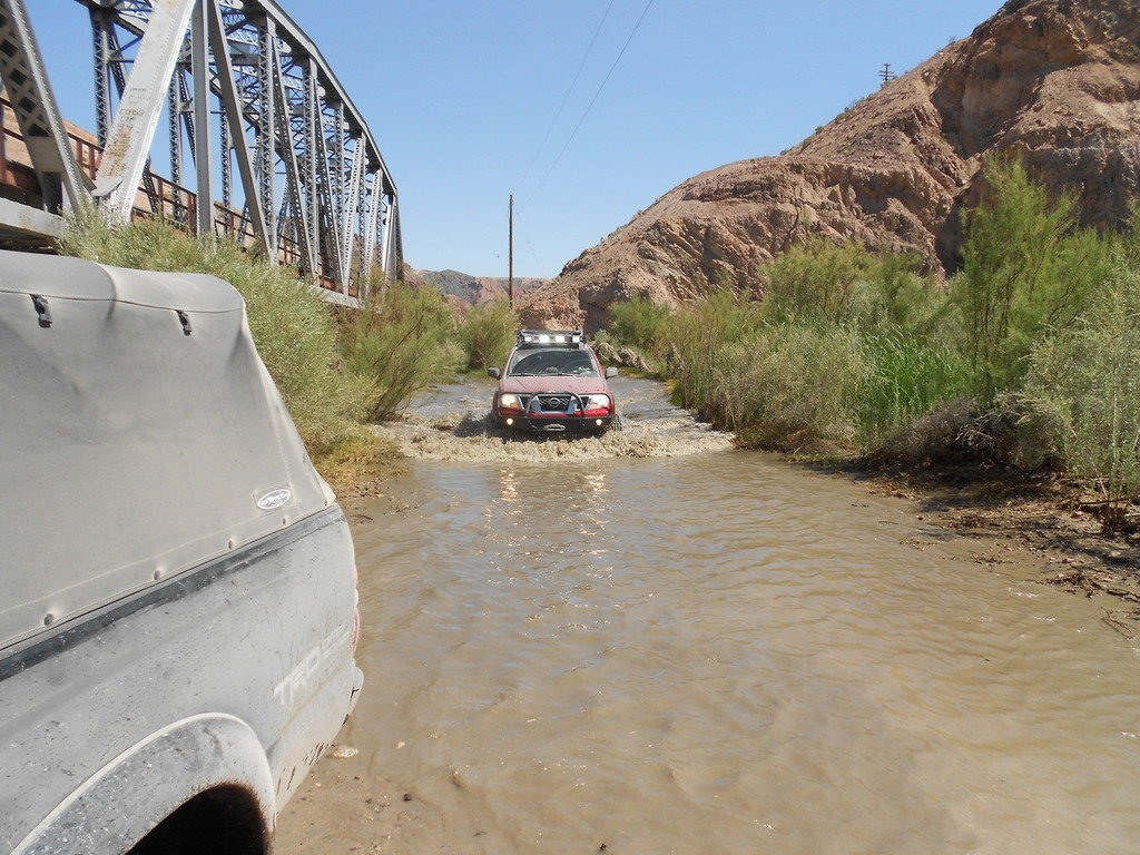

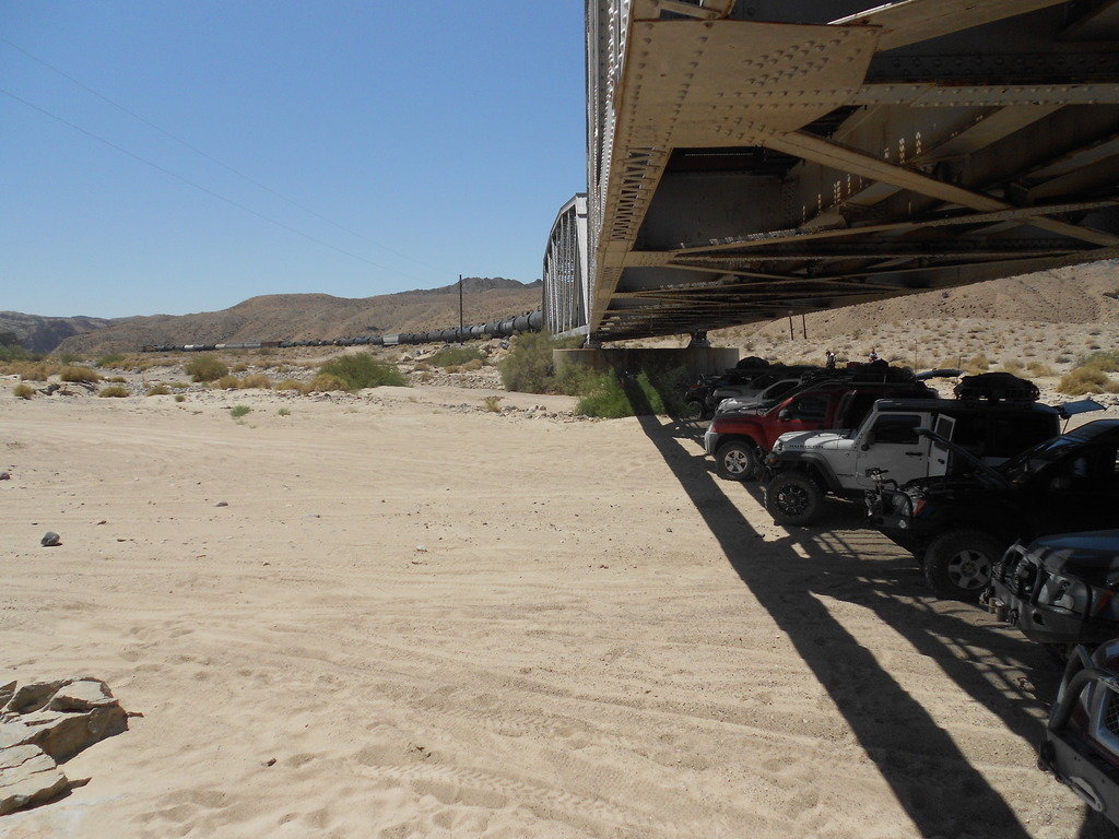

    A quick update and trip report...ran The Mojave Road with a group of Nissan buddies a couple of weeks ago, and aside from the poor rear suspension, the Taco performed like a champ!! Very happy with the easy load/unload qualities of the Softopper, although our stuff did get a tad bit dusty. :)
    Hole In The Wall
    Who doesn't love...
    Dusty but happy GeoTaco after a day on the road
    Checking out the town of Cima, CA
    Side trip to The Kelso Depot...well worth it
    Camp for night 2
    Traveler's Monument on Soda Lake, near Zzyzx, CA
    Buried boxcar in Afton Canyon...love this stuff!!
    Lunch at the railroad trestle just before Afton Canyon...and while we were there a train went over...too cool!!
    My buddies Fronty making the Mojave River crossing
    And finally, airing up just off of Afton Canyon Road entrance to I-15

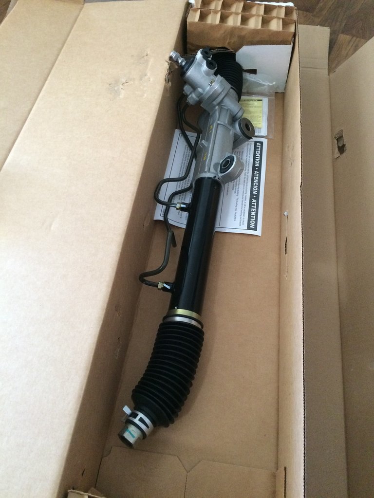

    Following our trip to Death Valley, my inner CV's blew out and also somehow took out my brakes.
    Once home, I ordered a new steering rack, CV axles, and Moog outer tie rod ends.
    The install of the parts goes down this weekend, I will post up some pics following.
    Also ordered a BudBuilt IFS front skid plate, which will be delivered this weekend as well. Will get some pics up of the paint and install hopefully next week.

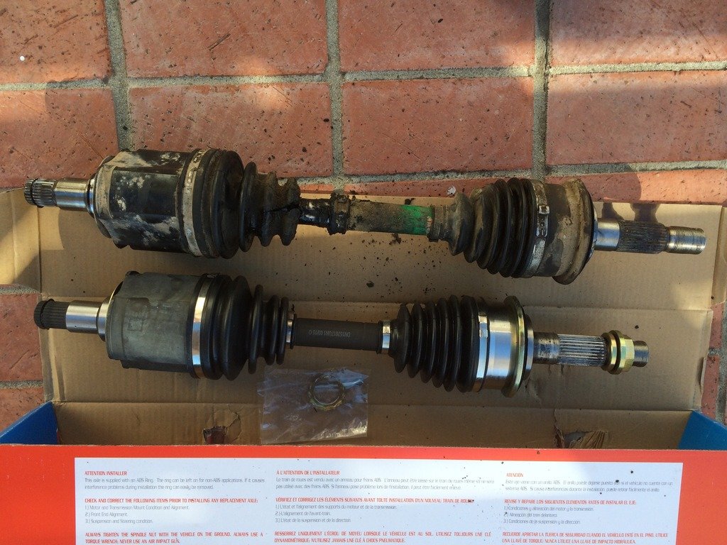

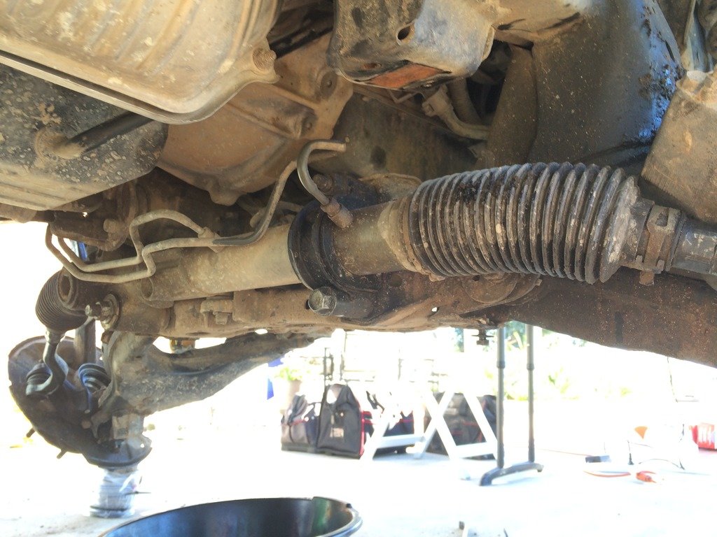

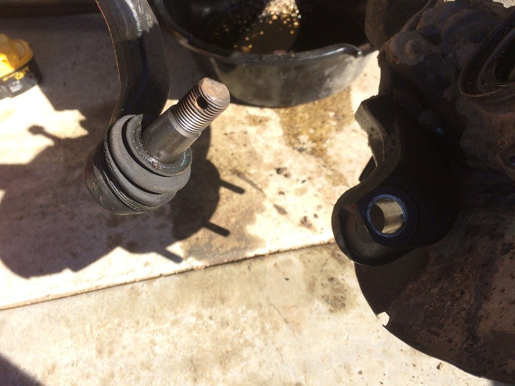

    Update...removed the sway bar, steering rack, and discovered that the drivers side wheel hub assembly was f-ed...so removed the spindle and ordered that part.
    Found a local (Oceanside, CA) Carquest that presses bearings ($60) and prepped for that once the new parts arrived.
    A few shots from the day:
    Old steering rack with sway bar out
    Power steering/ATF fluid pumped out
    Had to heat the tie rod ends with a torch to get them to release from the spindles
    Old vs. new
    MOOG ftw
    Old CV axle and new EMPI CV axle
    Spindle removed for eventual wheel hub assy. removal and press in

    How come the new axle looks short compared to the old.
  14. Nov 22, 2015 at 11:01 AM
    geoyota760
    geoyota760 [OP] Allergic to pavement
    Feb 8, 2015
    #148201
    699
    PHOENIX, AZ
    2019 TRD OR
    5.29 Nitros Bilstein ICON Kansei BFG
    Not used or stretched yet I'm assuming.
    Going to do the boot stretch mod with hose clamps.

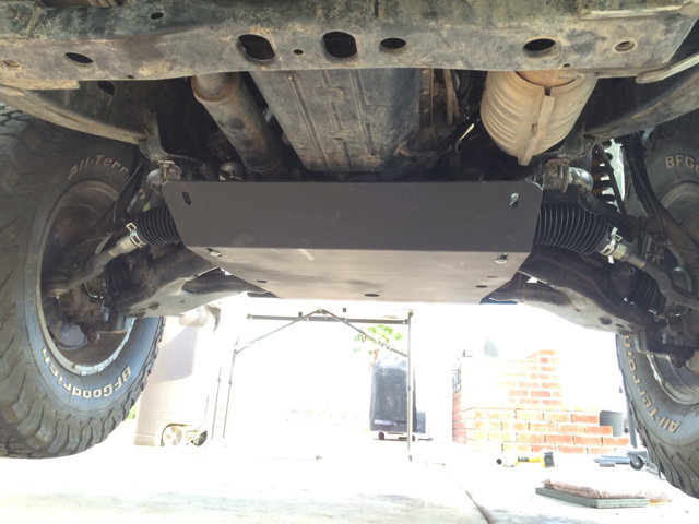

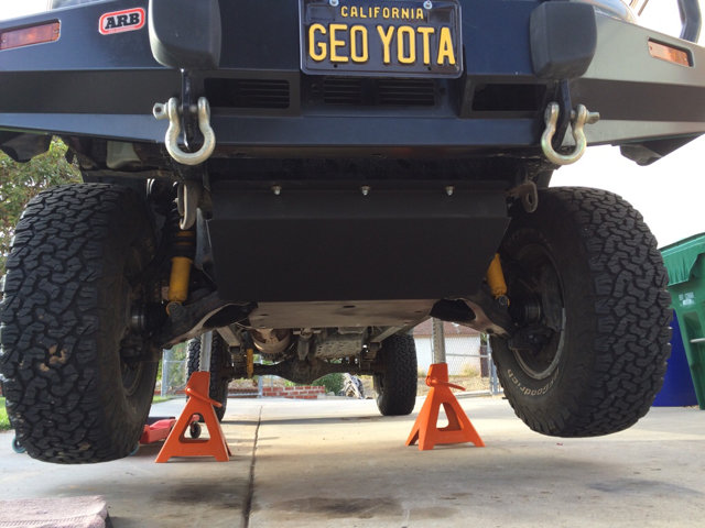

    Budbuilt skid installed today...

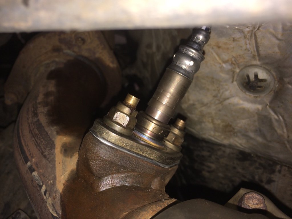

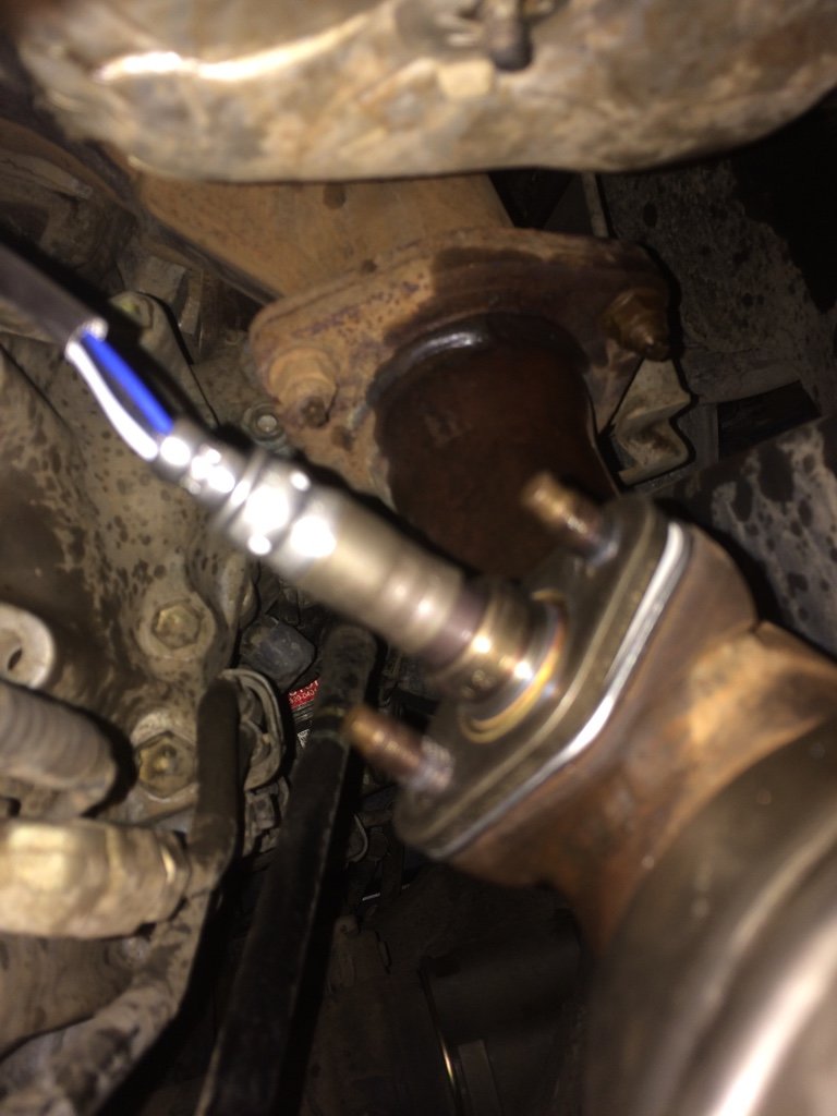

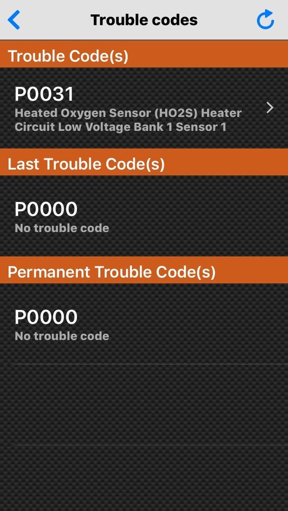

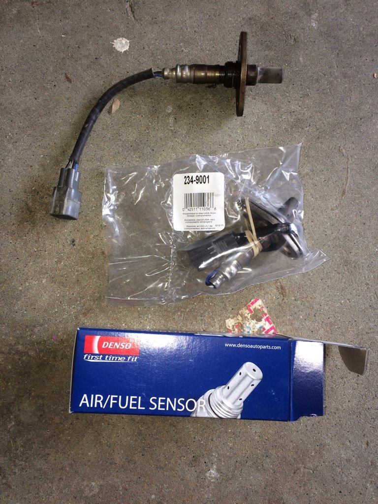

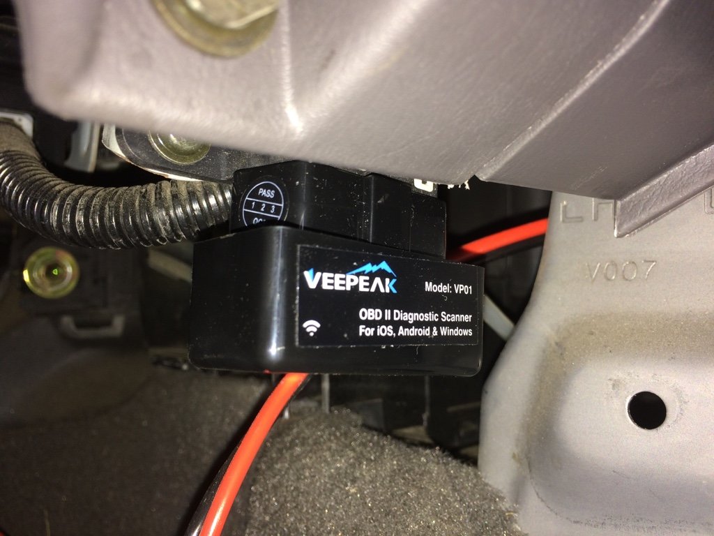

    Got a P0031 code, bank one sensor one for the AFR O2 sensor. Ordered off of Amazon for $103 delivered overnight. Also grabbed a wifi OBDII plug for scanning and CEL resets.
    Old and new, part #234-9001
    Veepeak scanner, $19 delivered. The coordinating app for my phone was $14.99
    App worked great once it was synced. Installed the new sensor and cleared the trouble code
    New sensor installed
