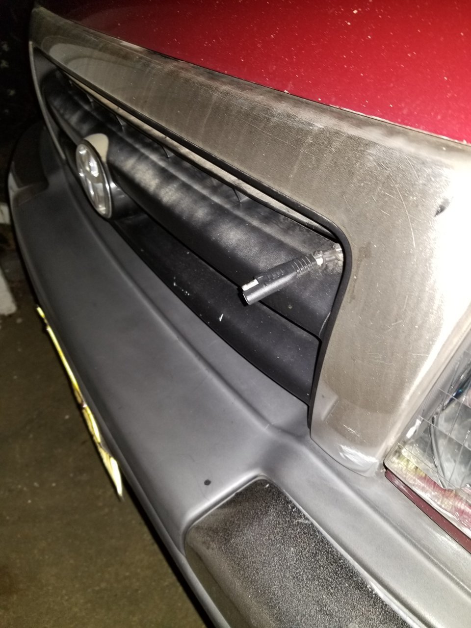

    Same exact issue for me...i drive ~6min to train station each day and battery starts to die after all that sitting, especially in winter. Granted I've got a 99 taco but same principles apply. Battery tender Jr on Amazon works great.
    Just get extra wire and run it from garage, plug in occasionally and that's it, you're set. I wired up a port to my battery that goes through the grille, been working for years.

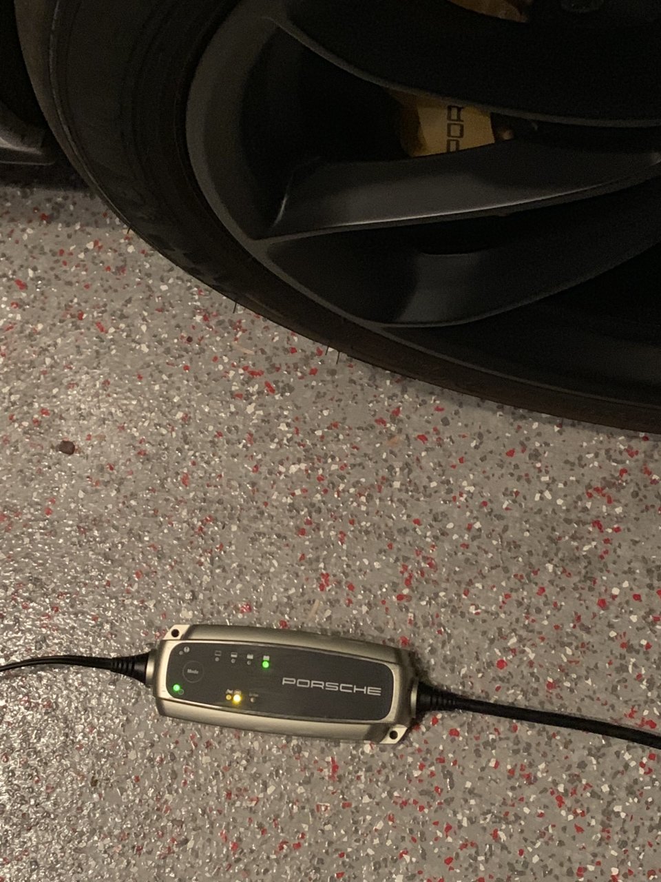

    If you are not using your car/truck on a regular basis a trickle charger is a must. Today’s cars use a lot of juice while parked due to on board electronics. Lead acid batteries don’t do well with deep cycles. I use this charger on my GT3 RS as it’s a weekend car. Your battery life will be extended if using a trickle charger. This charger can be used on any vehicle and it plugs directly into the cigarette lighter.
