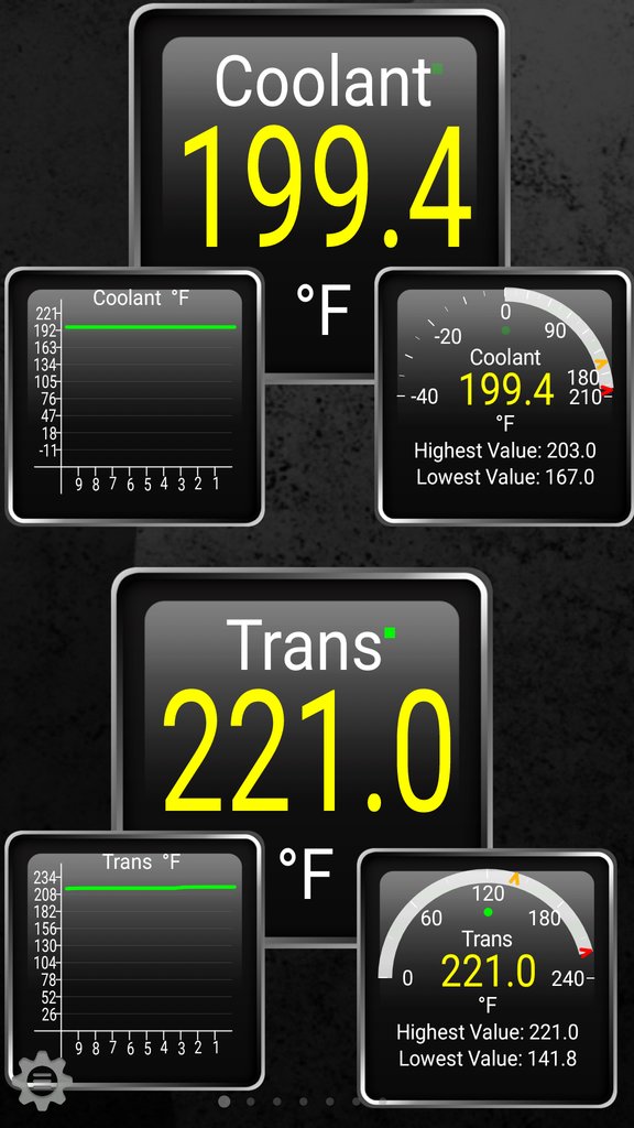

    Attached image is the transmission and coolant temps after driving up hill to my house. It's about a 3 mile pull with about 800' of elevation gain. Going about 25 mph. Ambient temperature is about 89 degrees. Not carrying any cargo.
    I just started monitoring transmission temp. I had no idea it was getting this hot.
    I've got the non-tow package fan clutch (orange).
    Should I upgrade to the fan clutch to the tow package (green) version? Should I add an oil cooler? Both?

    Turn o/d off to lock the torque converter when going up long hills and it will keep your trans temp way down.

    I mean it's not necessary as you have prob made it up that hill many times but it'll be easier on the tranny temp. It'll lock you in third gear so you'll have higher revs but not by much.
    Also you said you were only going 25mph so your torque converter wasn't locked. Should lock around 38-40 mph and that would keep the temp down as well, as long as it's staying in 4th and not constantly shifting.
    I also run a external tranny cooler but I run it in series with the factory cooler.

    I understand you're a first gen having a cooling problem but maybe I can give my 2 cents too. Since you aren't towing I would suggest just a simple trans cooler plumed with the internal radiator portion. That should lower temps. If you were or are towing something with a lot of strain, I would suggest a stacked plate cooler and upgrading to flex lite electric fans instead of the clutch fans.

    but tranny cooler is easier/cheapest way to drop temp
