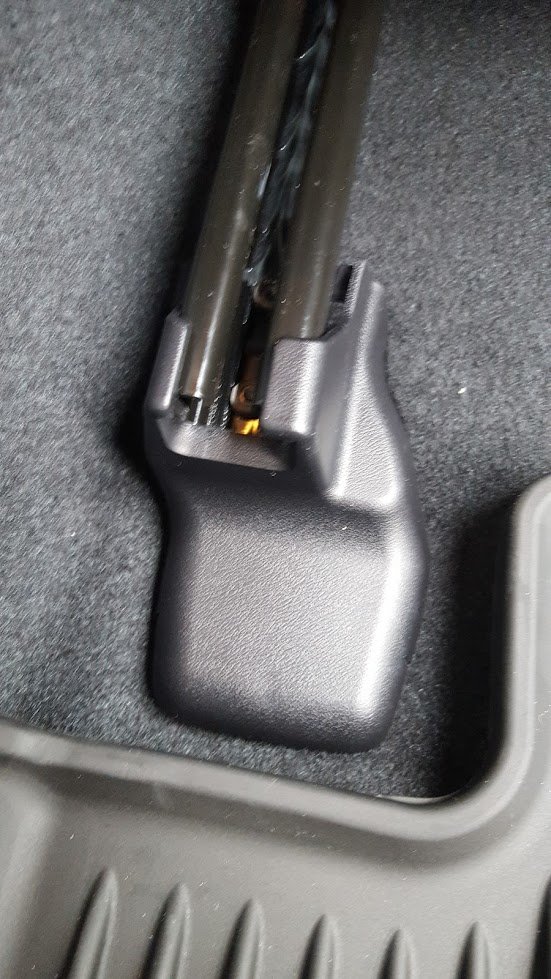

    4) Out at the truck, time to remove the plastic caps and loosen the bolts. First, since we're only replacing the rear bolts, it's a good idea to loosen the front bolts a couple of turns to allow the seat track to move freely.

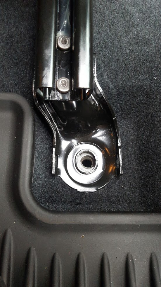

    5) Remove the rear bolts holding down the seat track. The stock is a 14mm.

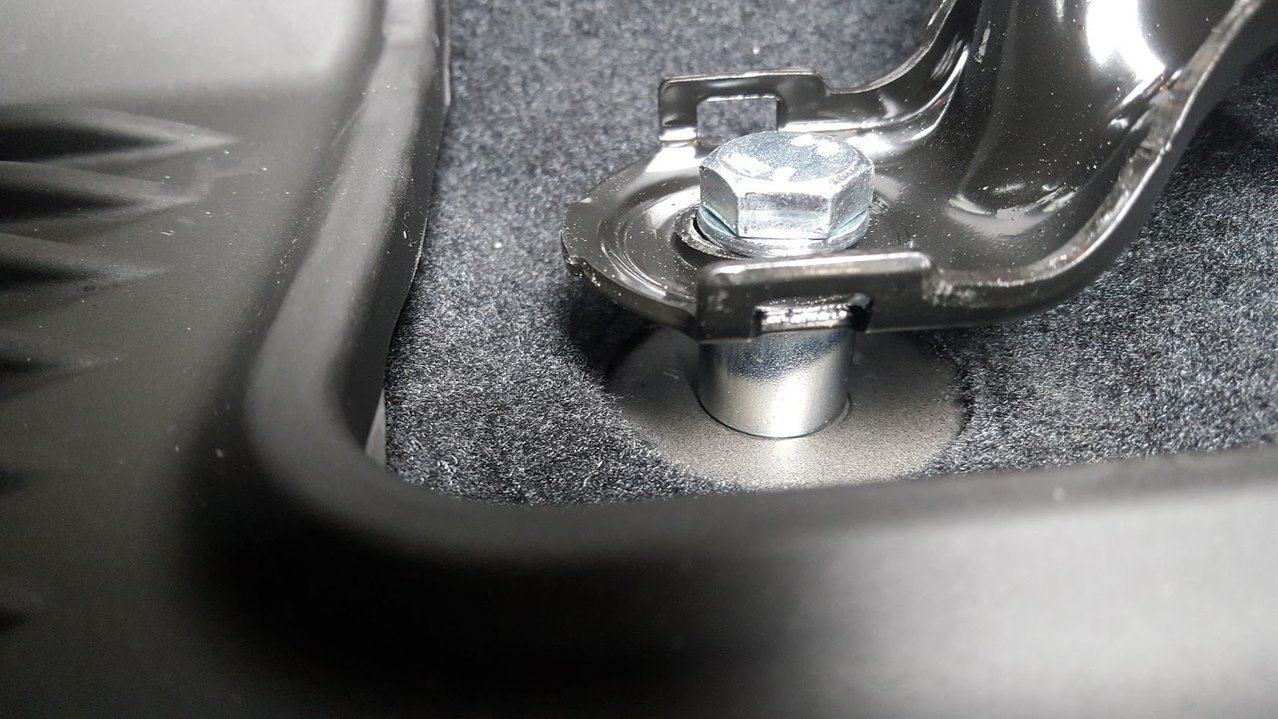

    6) Next, slip the 3/4" bushing UNDER the seat track on both sides; with the front bolts loosened, the seat should lift easily. Once under the tab, insert your new bolt with the washer on top and hand tighten. Do the same for both tracks.

    7) After both rears are in place and your bolts are hand tight, go back to the front and re-tighten those bolts. DO NOT OVERTIGHTEN. They need to be quite snug, but please don't ham fist them and strip the threads. After tightening the front, go back and tighten the rears a little bit at a time on each side until you have good, even tension on both sides.
