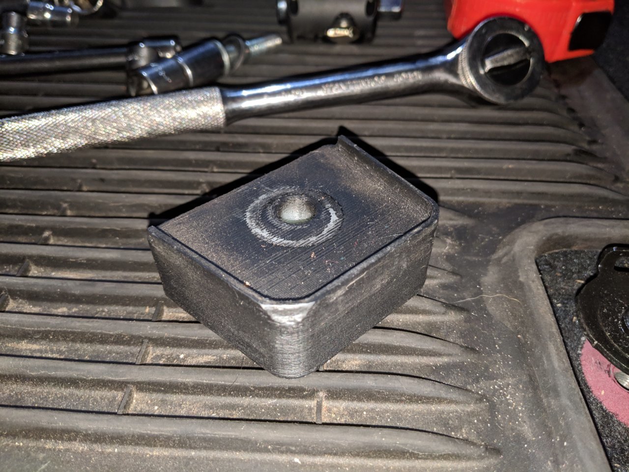

    Thanks for all the info in this thread, I’m trying to make my own and get the replacement bolts

    You're going to want to go wider on that spacer.
    Just my $0.001.

    Where’s the cheapest place for the replacement M10 X 50 X 1.25 bolts?
    I’m seeing them for $7 each which I’m not paying that much

    I got mine at ACE (10.9s) for $2.80 each. O'Reillys had a three pack for $4.

    Do not cheap out on bolts for this project. $7 per bolt is not expensive...$14 for a mod that could affect your safety. Buy quality bolts from a quality source or move along.
    As another member posted, this is *probably* ok because of the safety factors involved in the design of the seat mounting. However, you don't have to just consider the shear strength of a bolt because you have changed the arrangement from single shear and axial forces and added moment forces to the attachment. Is it significant enough of a change to be a safety concern? Maybe not, I'd have to do the analysis. But maybe.
    However, I will say, if you are going to do this mod, DO NOT USE CHEAP BOLTS. You want to use high quality bolts of at least the factory specified grade. They don't spend the extra money to put higher grade bolts in this application just to make the truck more expensive...

    I did check the calcs with Grade 10.9 bolts and 1.0in spacers. High margins there. I've been meaning to recheck it for 1.5in spacers.

    10.9 is grade 8 equivant
    “A tempered medium carbon steel. Class 10.9 is stronger than class 8.8, and is commonly found in high strength automotive applications. Class 10.9 is similar to grade 8. ... A low carbon steel for general use.“
