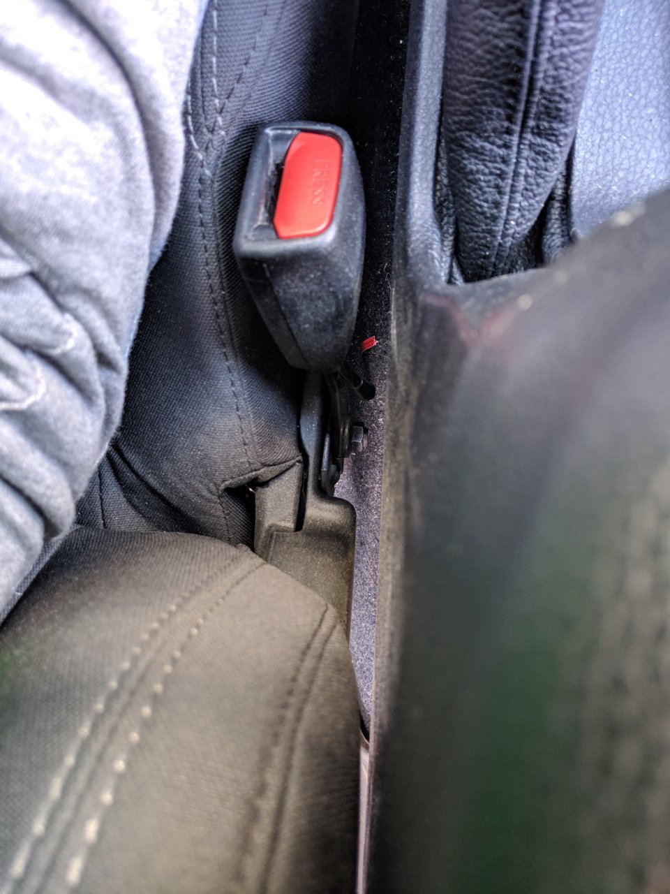

    Now go take a look at where the seat belt latch attaches.

    Great point. Do all 3 seat belt points attach to the seat?

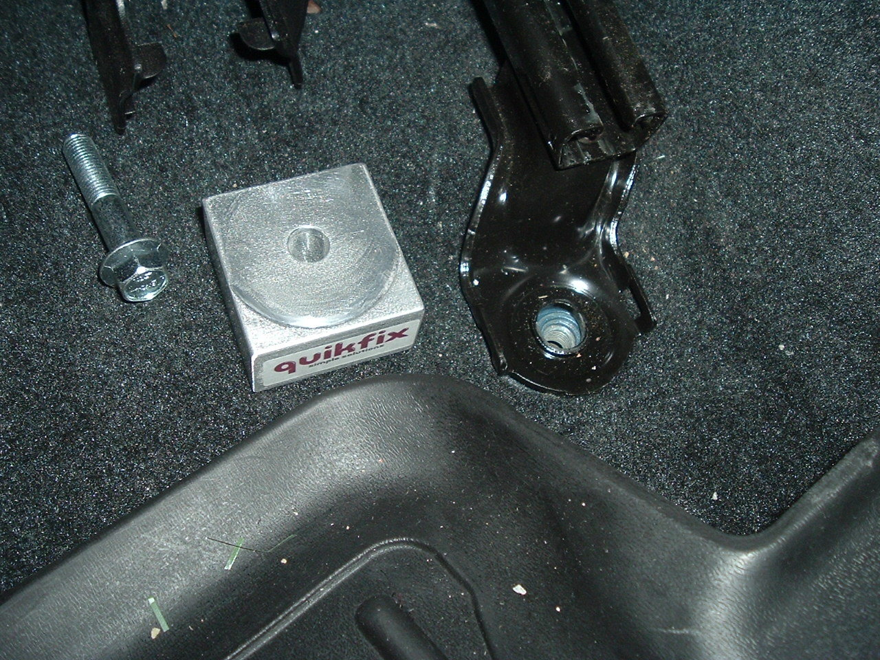

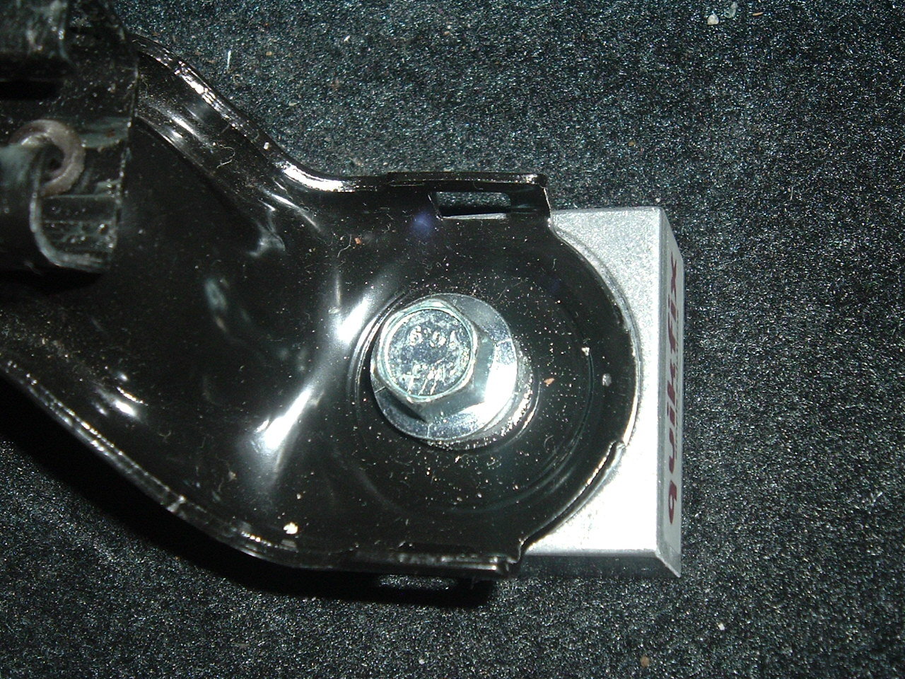

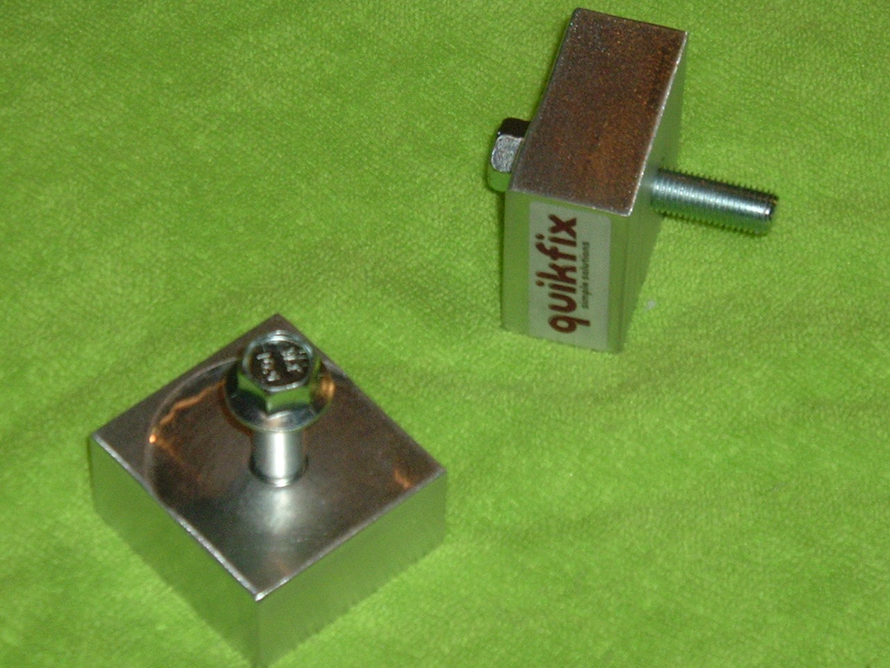

    There are several options available from several members. Here is what I made and works for me. Feel a little more at ease with a bigger support and grade 10.9 bolts with 150,000 psi tensile strength.
