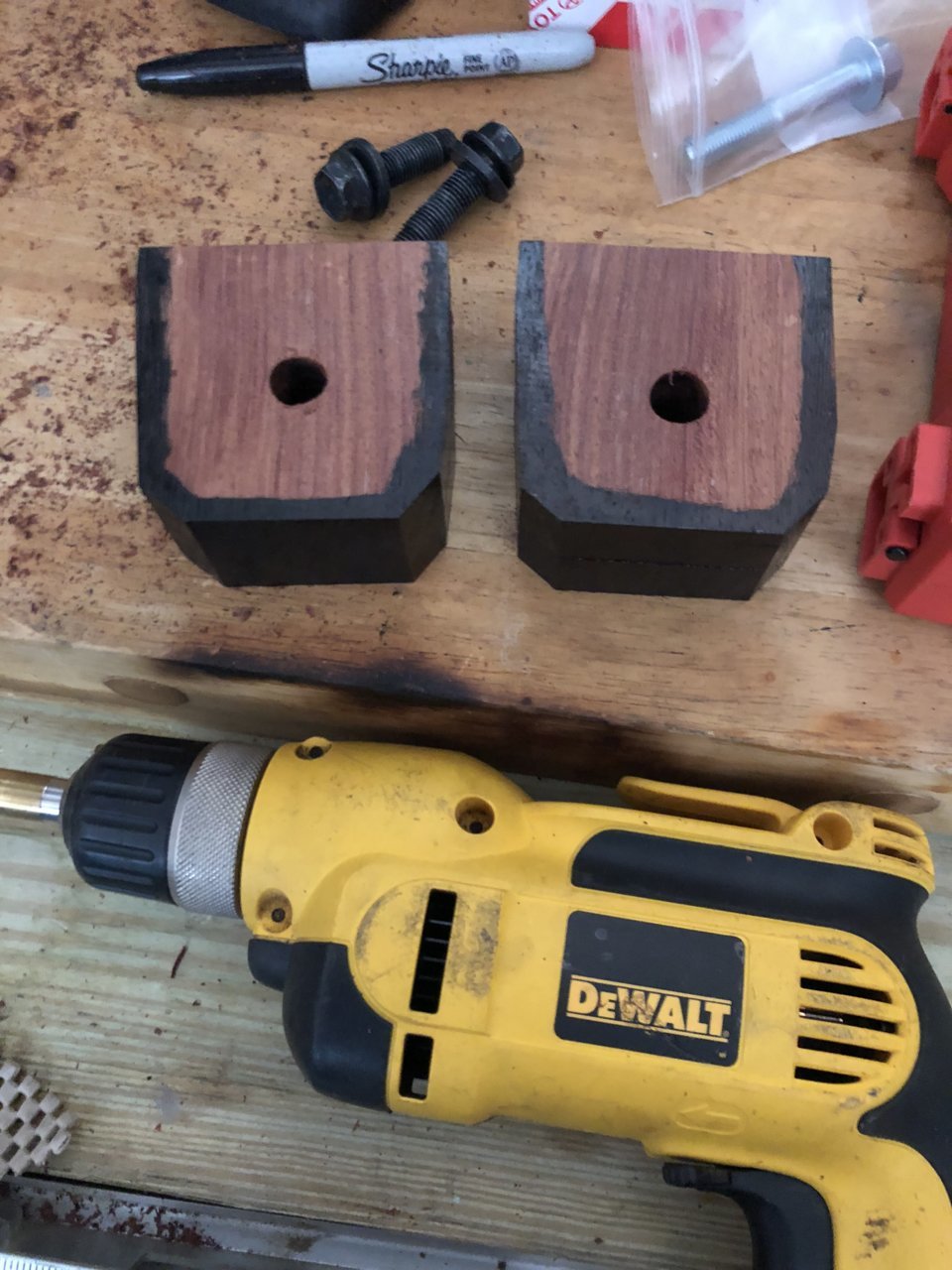

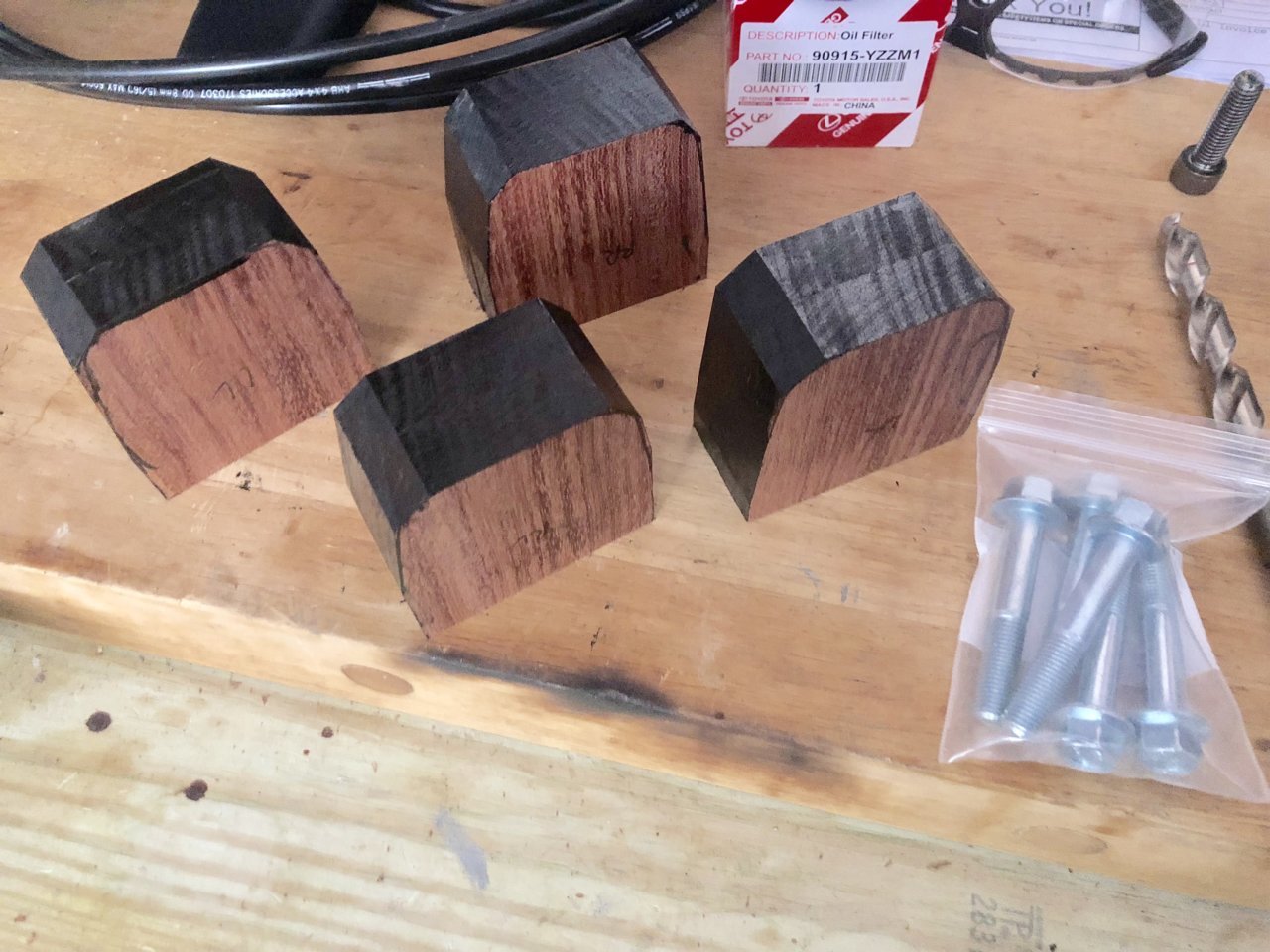

    I’m making some out of bubinga
    Looks like dry aged beef, much harder

    Finished mine today, have to touch up some black paint, almost burned up a drill bit which was the hardest part
