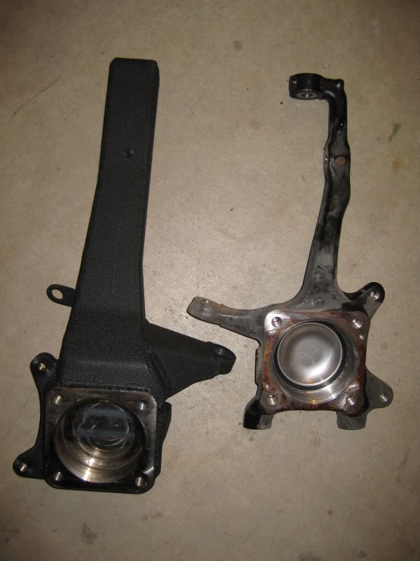

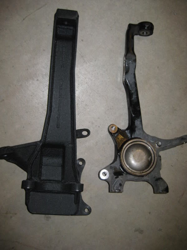

    Your truck looks good, but if you were to do it again, I would tell you to save the money and do it yourself it is an easy install.
    I am also wondering how the spindles made your ride better. Unless you had the coils cranked to lift the truck before and now you are only using the spindles to lift your truck there will be no change in the way the truck rides.
    For those who are confused about spindles and why you cannot get them for your 4wd truck it is because of just that; you have 4wd. While there are aftermarket spindles that come with drop bracket lifts they themselves do not add any lift. 4wd "lift" spindles only raise the UCA mounting point in order to keep a "good" UCA ball joint angle. If you were to put a drop bracket lift on your truck without extended spindles you would max out your ball joint leaving you with little to no suspension down travel.
    Now with the prerunner lift spindles like the TC, Camburg or Engage you actually do lift the truck because these spindles raise the mounting point of the LCA. With these spindles the lower control arm mounts at or near the centerline of the wheel therefore putting the wheel lower relative to the truck given the same suspension. This is also why 4x4's cannot use these spindles as the LCA mount occupies the spot where the CV axle would be.
    Another nice thing about the prerunner spindles is the increased ground clearance. Since the LCA mount is moved up on the spindle 4" that means your LCA gains that distance from the ground, giving you great front end ground clearance.
    Here are some side by side shots of the 05+ stock spindles and the Camburg 4" spindles:
    I lined up the UCA and LCA mounting points so given the same suspension components and suspension ride height you can really tell the difference in lift between the two
