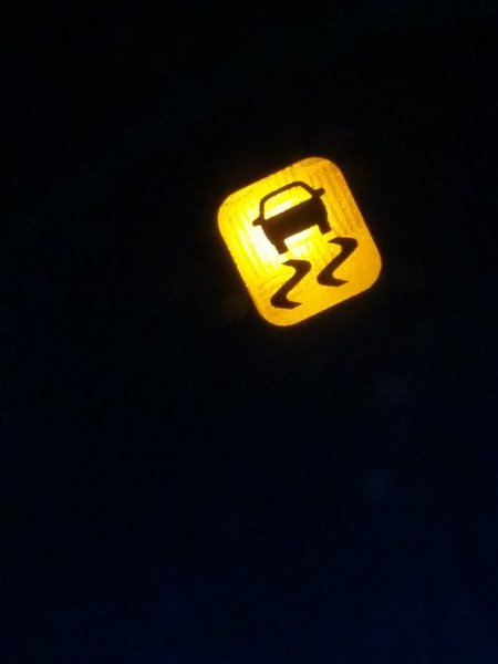

    So I went ahead and did the job with two of my frinds... struts installed and the truck is leveled as I want... only one problem and I hope you or anyone else can point me the right direction.
    On my way to the shop to get the alignment (it was all over the place after the install of the 5100s) the anti slip ligh came on and it has not come off since. I checked the wiring and it is fine. The guy at the shop said he could not reset it with he computer and that there were no faulty error codes.
    I'm pretty much now resigned to go to the dealership... not my favorite option as I know they are going to blame it on the struts. I saw some posts about this and they all end up in "went to the dealership". So I may have to do the same.
    Thanks for the help... I will post pics later of the job after the tires and rims are installed.

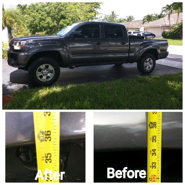

    what setting did you use on the 5100s? I'm going higher in the front and the rear with an extra leaf and 5100s
  18. Jun 26, 2016 at 8:03 AM
    #18
    poyota2015
    poyota2015 [OP] Well-Known Member
    Nov 25, 2015
    #170645
    173
    Diego
    Coconut Creek - FL
    2015 Toyota Tacoma 4WD DCLB
    Suspension Level with bilsteins 5100's stealth custom series f5 - 17x8.5 265/70/17 Toyo's OC A/T II LED Headlight bulbs
    PhotoGrid_1466954657110.jpg I did 1.75... but my goal was to level the truck... with that setting I accomplished that. I made no changes to the back... so adding a leaf might require a different setting.

    patbegley
    patbegley Well-Known Member
    Apr 7, 2014
    #127234
    475
    The Kootenays
    '22 DCLB
    Before and after have me rubbing my eyes

    poyota2015
    Nov 25, 2015
    #170645
    173
    Diego
    Coconut Creek - FL
    My bad... been a long night. Is the other way around.
