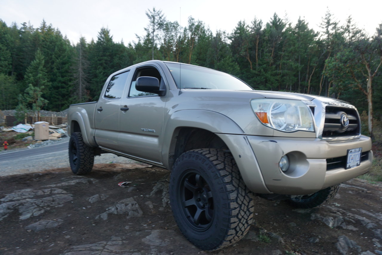

    So my truck is going in for a rust recall next week and it looks like they will take about a week to rip it apart and put on a fresh new frame. Is there anything I would be wise to replace while it’s apart? It’s basically stock other than a 3” spacer lift and has 225000km. Also, is the powder coating of the new frame sufficient for British Columbia’s salty winter roads? Cheers!
