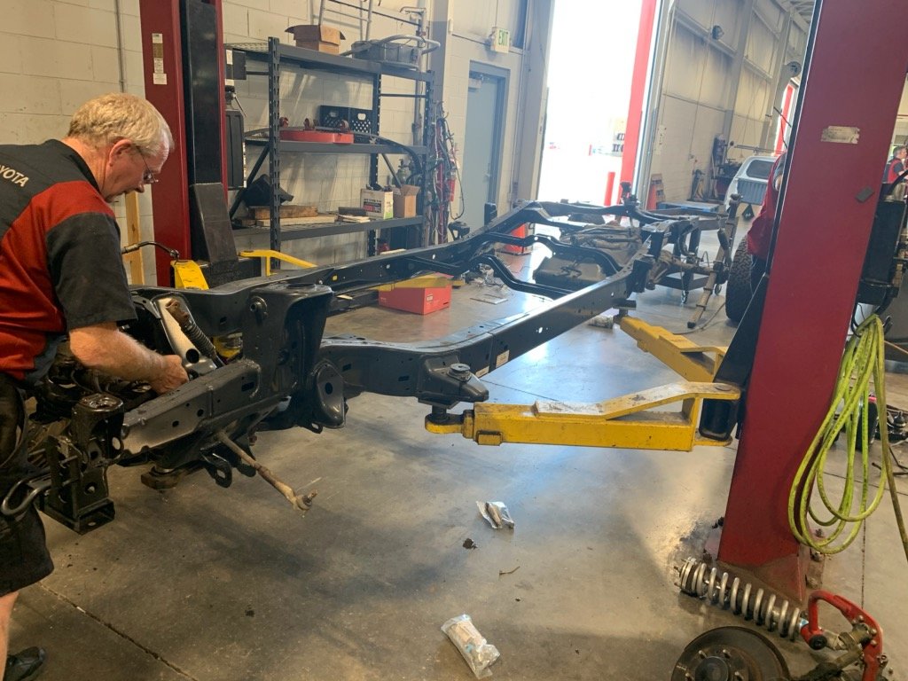

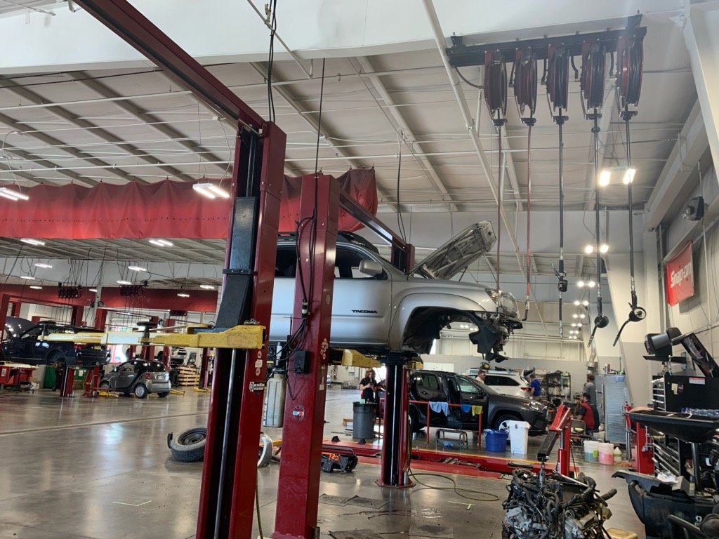

    Frame swap started today!

    Nice. Too bad they don’t give you the option to take the frame and get it galvanized prior to installation. There is a company here that hot dips truck frames for $600. A cheap price for a frame that will be rust resistant for decades.

    Make sure they install those power steering rack bolts from the bottom...it'll save you a lot of aggravation when/if you need to replace it in the future.
    I've had my new frame for about 4 years now, and mine seems to be holding up substantially better than the first one did. Time will tell, but I got almost 10 years out of the first, so if I can get another 10 years out of this one, I'll call it good.
