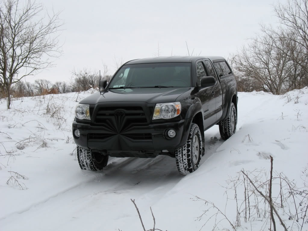

    currently i have bilsteins in the front with stock coils at .085....now with the bumper and winch im gonna get new toytec/eibach's and set the billies back at zero....im am slightly "bro" now with my leer topper.....so with the added wieght i should be about where i am now correct? Or what settings do you guys think would be best for the bumper and winch? new leaf's? i am stuck with bilsteins not changing them.....i was gonna ask relentless but i wanna leave him alone he is a busy dude......here it is now

    Did you photoshop my butt*ole to look like a Relentless bumper?:D But in all seriousness thats going to look bad ass!

    hahahah just photobucket shrink edit or some shit to rid of my plate cuz im a paranoid fucker:D

    winch and bumper should be 170 lbs extra....i just got on my hood nd i dont think it went down at all....im 180
