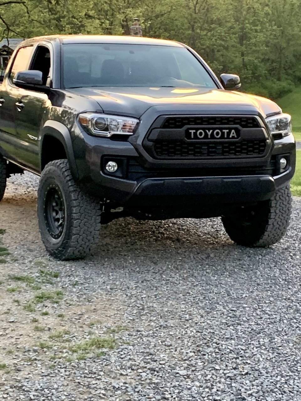

    No worries, that’s what this forum is for. The Ray10’s are 16”x8”. They have 4” of backspacing & -12mm offset.
    I did an Eibach suspension lift at the same time I got my new wheels and tires, so I did my alignment once everything was installed.

    Thank you, so much! Yes, Eibach Stage 1 on the first clip. Did a 1.5” MaxTrac block in the rear. I have a couple pics that might help you:

    No problem. Glad to help. As for wheels, you’ll just have to shop around and find something that strikes your fancy. Any 16” x 8” wheel with the correct bolt pattern and 0 to -12mm offset should work and give you the look you’re after. Different companies offer different styles/models with varying specs.
    I chose the Ray10s because I love the look of them and they’re hub centric, but they can be difficult to find. I have no rubbing with my setup and I even have mudguards and no CMC. You’ll be fine with your stock UCA’s
    I have JBA UCA’s that I’m going to be installing soon, but not because of rubbing. My goal with the UCA’s is to regain the caster I lost with my lift and improve my tracking at highway speeds.
