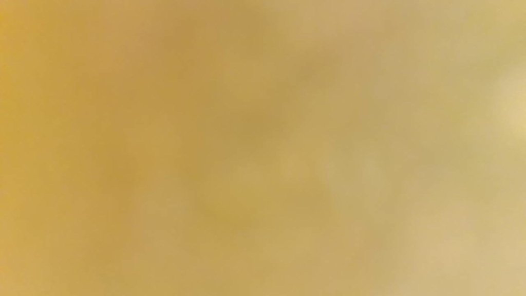

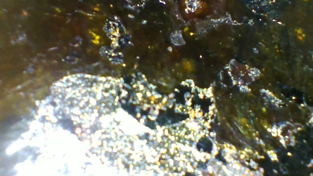

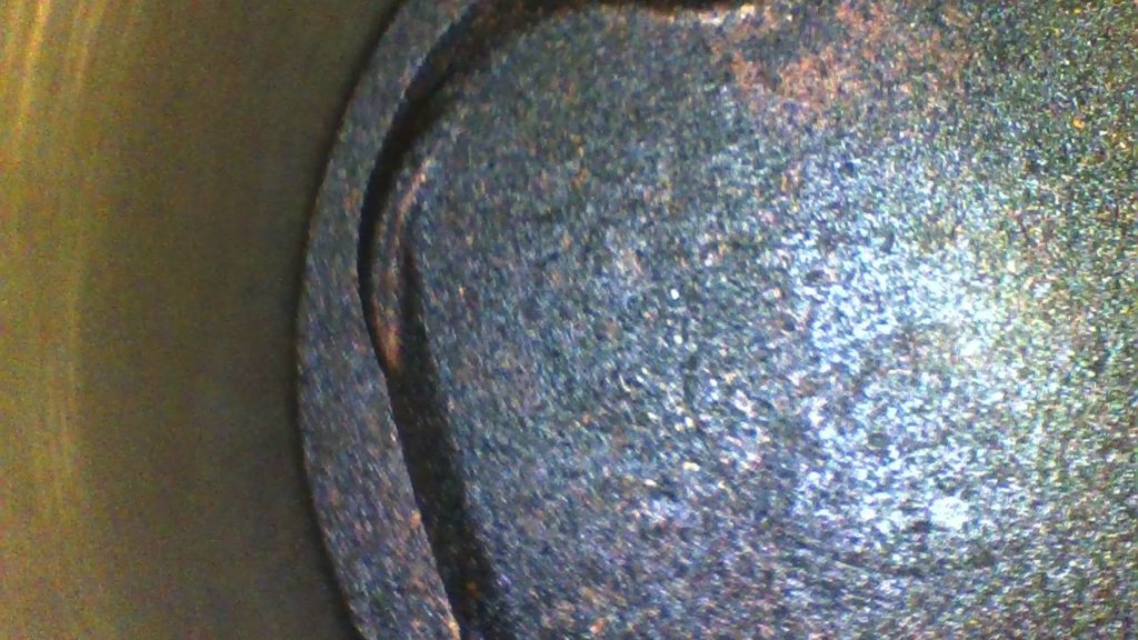

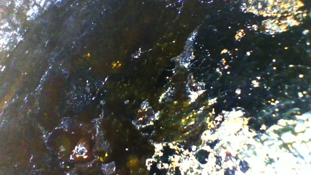

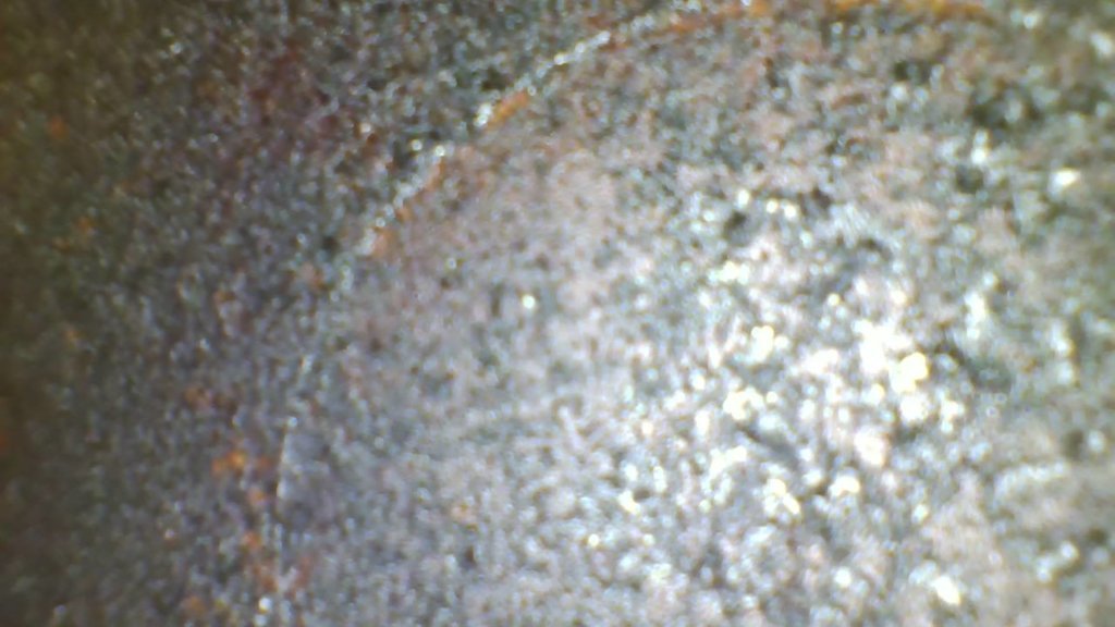

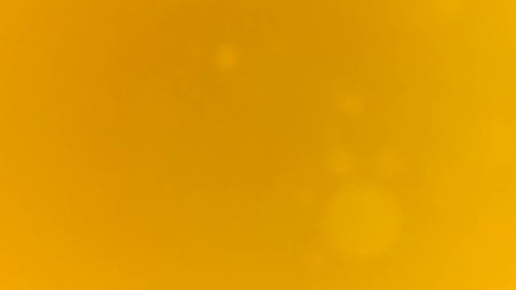

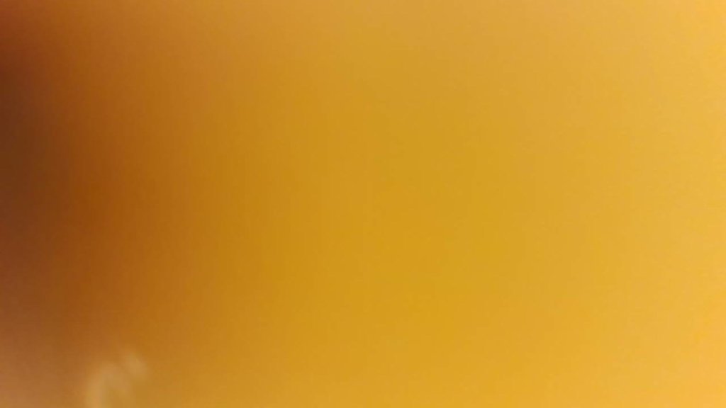

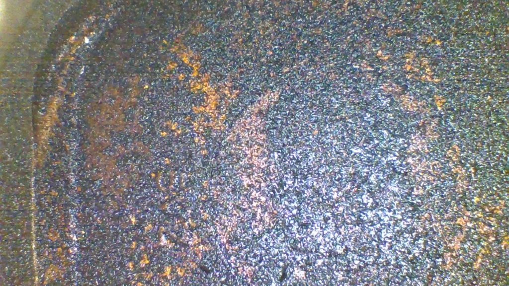

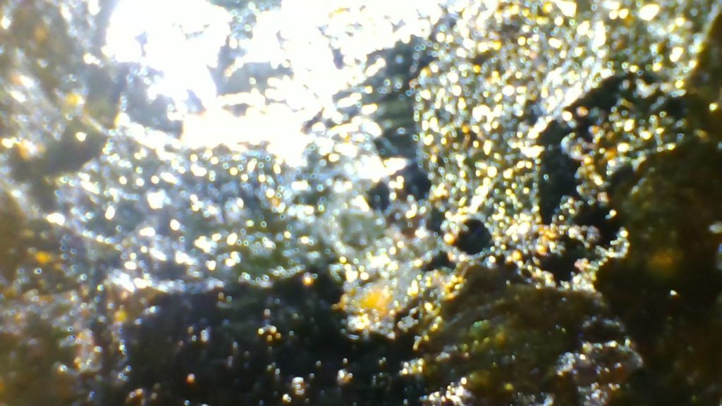

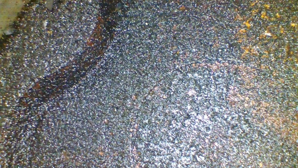

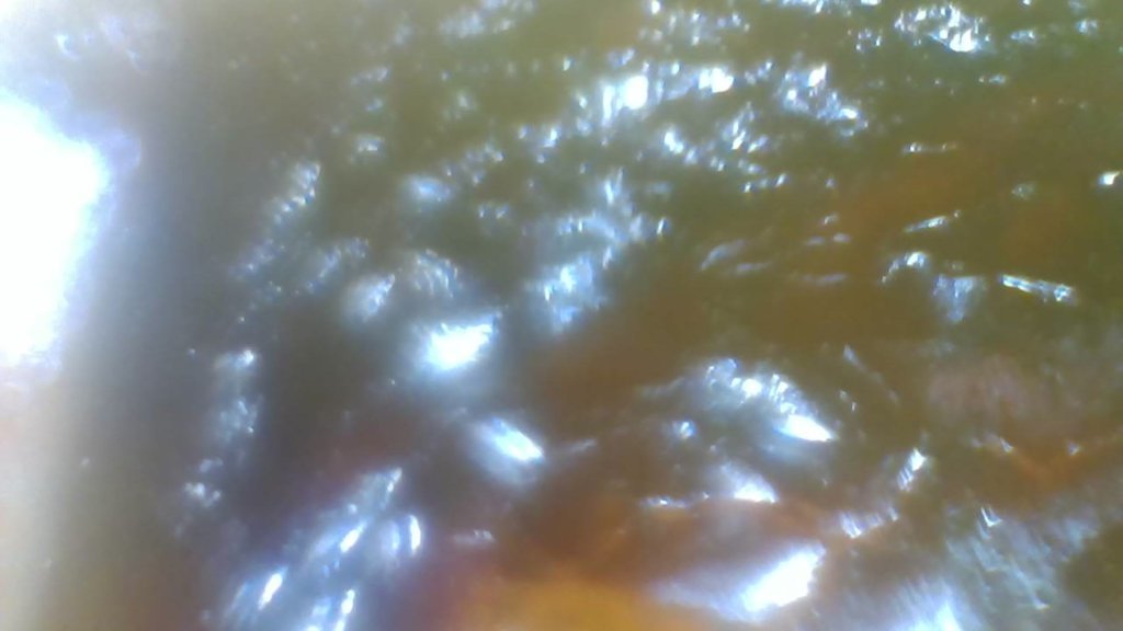

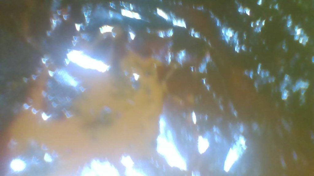

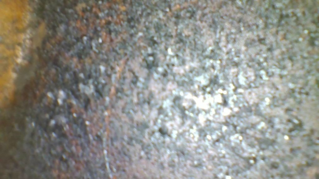

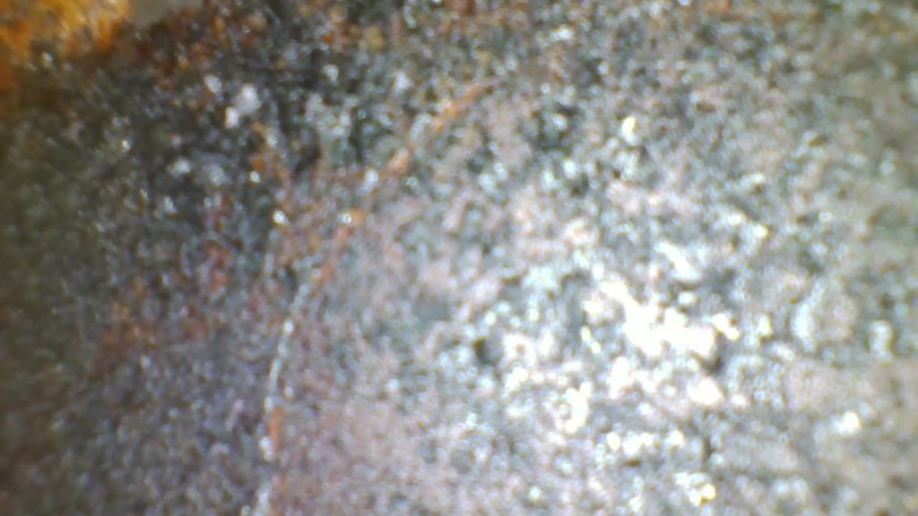

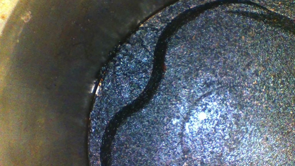

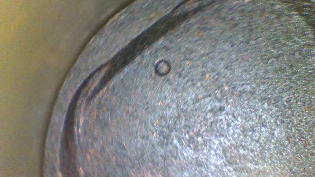

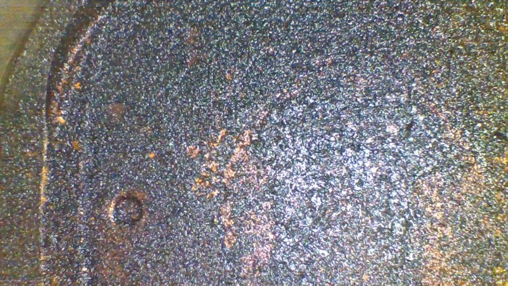

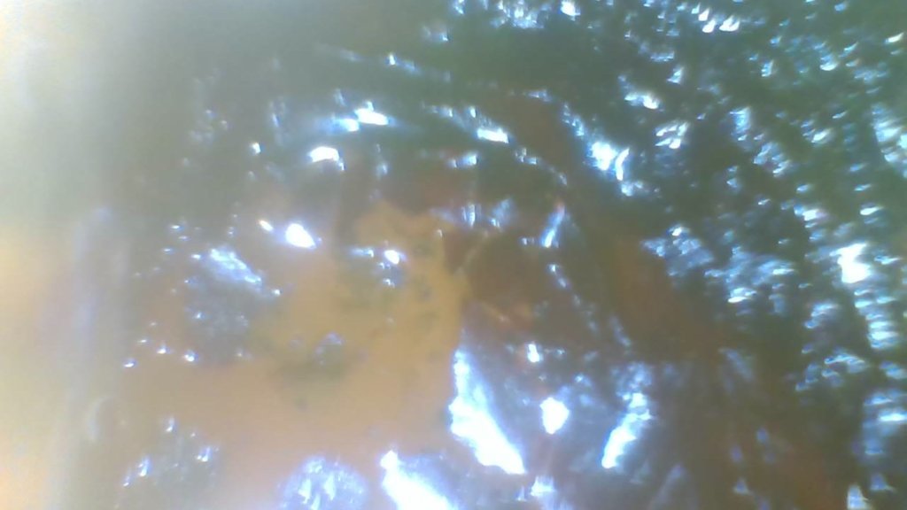

    The scope was a cheap crappy one my son happened to have, so if I need better images let me know…but I think I found the problem: Cylinder 4 is full of antifreeze.
    So…now what?
    Cylinder 1: PHO00000.jpgPHO00002.jpgPHO00001.jpg
    Cylinder 2: PHO00011.jpgPHO00010.jpgPHO00009.jpg
    Cylinder 3: PHO00003.jpgPHO00004.jpgPHO00005.jpg
    Cylinder 4: PHO00014.jpgPHO00013.jpgPHO00012.jpg
    Cylinder 5: PHO00006.jpgPHO00008.jpgPHO00007.jpg
    Cylinder 6: PHO00016.jpgPHO00015.jpgPHO00017.jpg
  14. May 24, 2025 at 9:34 PM
    O'Silver_Taco
    O'Silver_Taco Well-Known Member
    Aug 26, 2021
    #375390
    4,179
    MD
    98 Dlx Sr5 ext AT Rwd
    3rz to 2Rz bebuilt block and new heads
    now you have some hard choices....
    could be just head gasket.....maybe cracks in the head.....or both
    how many miles on the block.....is the compression already shot
    if you're doing the work yourself this could be a fun adventure...
    if paying someone.....I'd think very hard about putting a bunch of dough in an almost 24yr old truck
    these dont make great commuters anymore.......they're really hobbyist trucks now
    2005 and later ones took that place
  15. May 25, 2025 at 5:48 AM

    well it looks like 2/4/6 is the problem.....thats most likely HG
    however its a good time to check for cracks between the valves and valve clearance
    227K aint shit on 5vz....barely broke in...next problem has rust damaged that side of the block while sitting
    So i'd load on the videos and pull that head
    these really are fun to work on.......if you like that sort of thing
