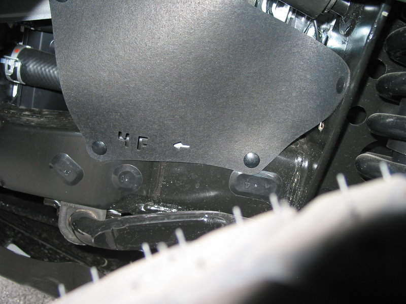

    @FRITZ235--
    After seeing your posting, asking me for more information on the plugs, I went through my E-mails to Toyota customer support regarding this question. I thought 3 were replaced on each side, but after reviewing the correspondence, there were 5 on each side.
    I took these pictures at the dealership in 2013, on a new 2013 Tacoma truck and this is what I have seen on all newer Tacoma trucks of the same generation. The pictures are of the front drivers side wheel well frame (5 plugs) and are the same on the passengers side (5 plugs) too, so there are 10 plugs total. The first picture shows a protective rubber mat with "4A" and below it are 2 plugs (blue marks on them). The second picture shows a protective rubber mat with "4F" and below it are 3 plugs on the other side of the wheel well. If you look at the first picture near the "4A", at the right there are 2 small holes above and below the plug, I still plan on blocking the holes, with either silicone caulking or maybe fill them with the wax from a toilet ring.
    I attached a copy of the instructions for the limited service campaign on the Tacoma, which was copied from someone at the dealership and on page #19, it has a diagram showing the different plugs that go under the front wheel well frame, with part # and where they go on the frame that I was referencing.
    The dealership did install 2 plugs under my truck, that were drain holes and after seeing water collect around them, I ended up removing them to be safe. If you look at page #18, even Toyota says, "install plugs to limit water and road spray from entering frame rail/cross members", so they know these plugs have a reason to be there and should be installed on all older Tacoma frames, just like they do on newer frames.

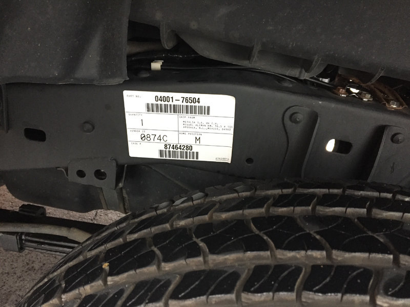

    I think it's 15 plugs.
    Here's the part number.

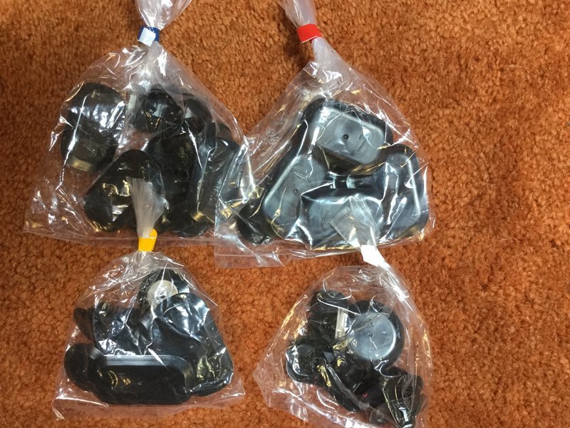

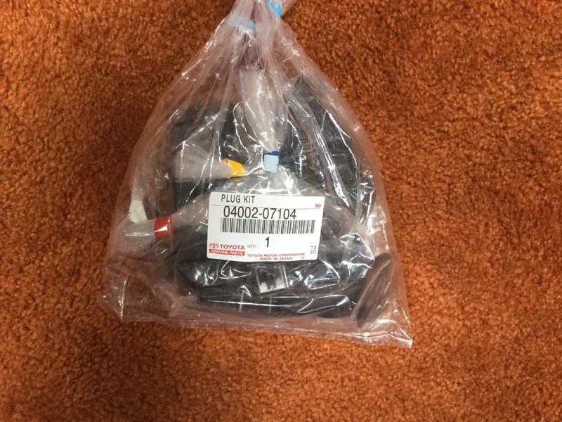

    There are a total of 24 plugs that come in the kit. Mine cost $65. Tech instructions show where they all go.

    I just ordered the kit like 20 minutes ago. I got mine for $35, (they charge $12 for shipping, which kills it a little) here if anyone's interested:
    http://toyotaparts.bochtoyotasouth.com/oe-toyota/0400207104
    They typically have the lowest prices.
