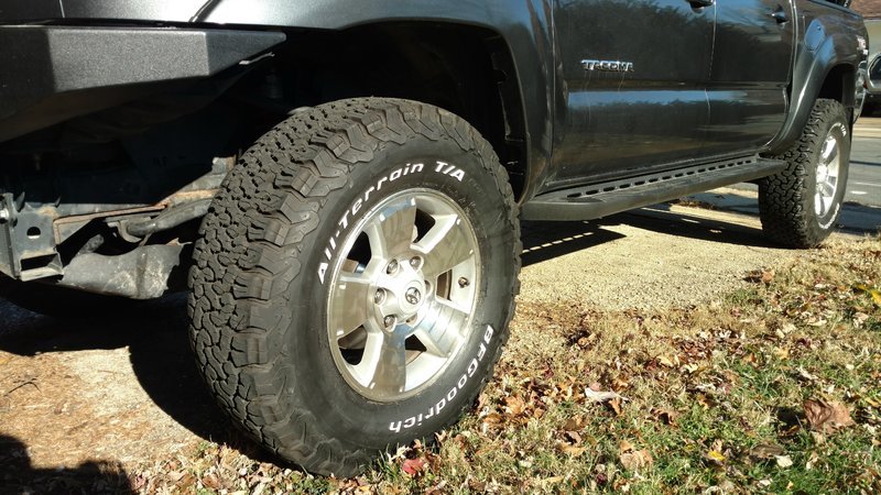

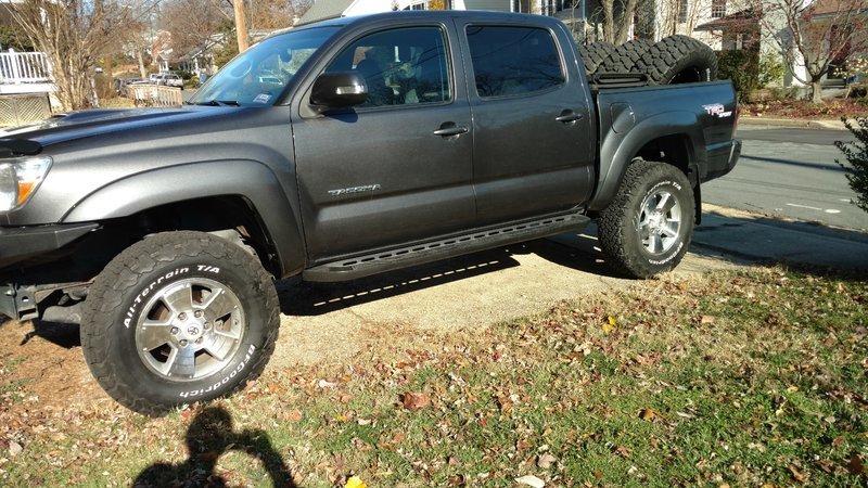

    Hey, Gang, I ran them for a little while. They didn't touch the cab mount or UCA on my truck. I have icons set at 2 inches and stock UCA, and 1.25-inch wheel spacers. I never wheeled with them, so that could have caused rubbing. Once they are mounted, they are smaller than 285/70/17 km2s. Just shy of 33 inches tall, and skinny than 285s. They ran great and felt light compared to Km2s. Great road manners. Here is a pic of them on my truck. I just so happen to have them for sale on here as well!:thumbsup: Good luck.

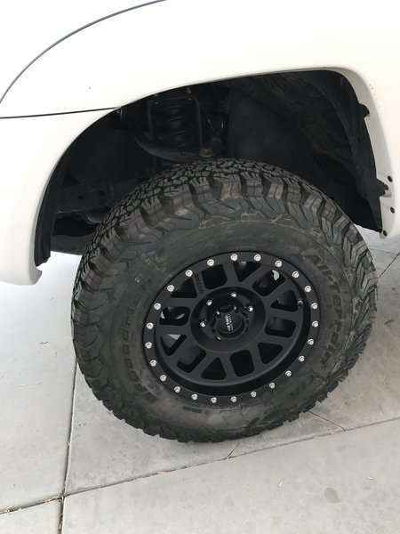

    Just got mine put on yesterday. They're wonderful. It's more like a true 33 than a 34. In my opinion, it's perfect. For those of you that don't want the extra width of a 285/70/17 this tire is the one for you. They are every bit as quiet as my Nitto Terra G2 tires. No rubbing of any kind thus far. Even going lock to lock. Jury is out on when they are stuffed up into the fender wells but I'm sure I'll find out soon enough!
