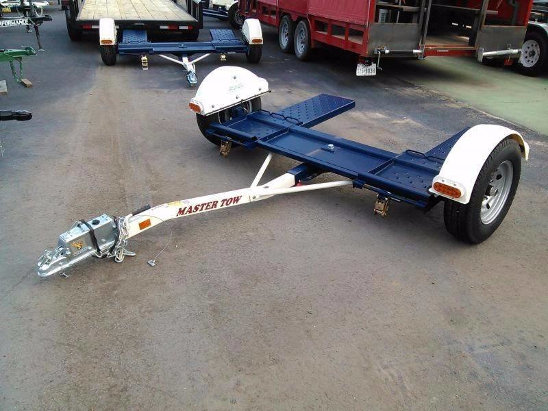

    C5B06490-B4EF-48D0-8514-A4FEFB74F520.jpg This has hydraulic brakes, you can rent these.

    Can you pull the rear driveshaft? If so a two wheel dolly will work fine. The 2010 will handle the weight fine and it won’t be a bad drive.

    ...pulling the driveshaft...I can totally do that but had not thought of it. Thanks!
